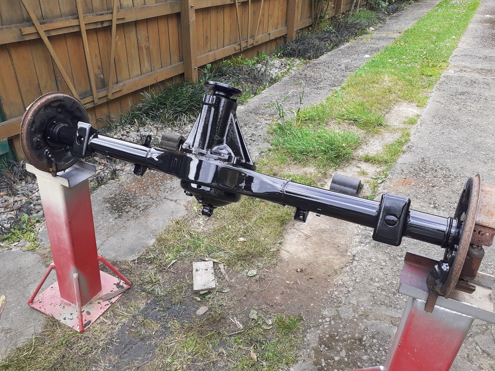

Popular Post bmxnz11 Posted December 6, 2021 Author Popular Post Posted December 6, 2021 I purchased an entire rear end a couple months ago because I needed the axles for the orange van. The diff in this spare looked pretty good so a plan was hatched to clean it up and swap it into the blue van. The blue van's diff has always been a bit noisy, there was a fair bit of play and generally leaky. It was also the last piece to be addressed under the van. I ended up stripping the spare down to metal and spraying it in 2k. The brake backing plates were later stripped and also painted. I ended up using the original blue axles because they were the only spares I had. The seals and bearings looked and felt OK. I threw in some new handbrake dust covers and a new handbrake rod bush. I cleaned all the brake mechanics and spruced them up before assembly. The brake cylinders were replaced a few years ago so they were fine. Old vs new. Everything has been hooked back up. Just need to bleed the brakes before I can give it a test. 19 Quote
