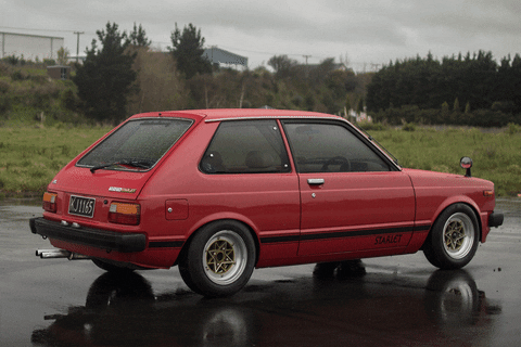

Made the exhaust, was too loud as it only have one Coby resonator and just a straight pipe out the back. So decided to make a muffler for it, since I couldn't find anything the style I liked.
So here's my guide to making a muffler haha
Press some end caps.
Drill a lot of holes in some tube and then louvre them. Weld on baffle for the expansion chamber.
Wrap tube in stainless steel wool and then stuff with fibreglass.
Weld on end caps
Polish.
Then fit.
Is all welded now and have painted the tube black, just waiting for some flanges to go just in front of the diff, otherwise I'll have some difficulty trying to get it over the diff to fit.
