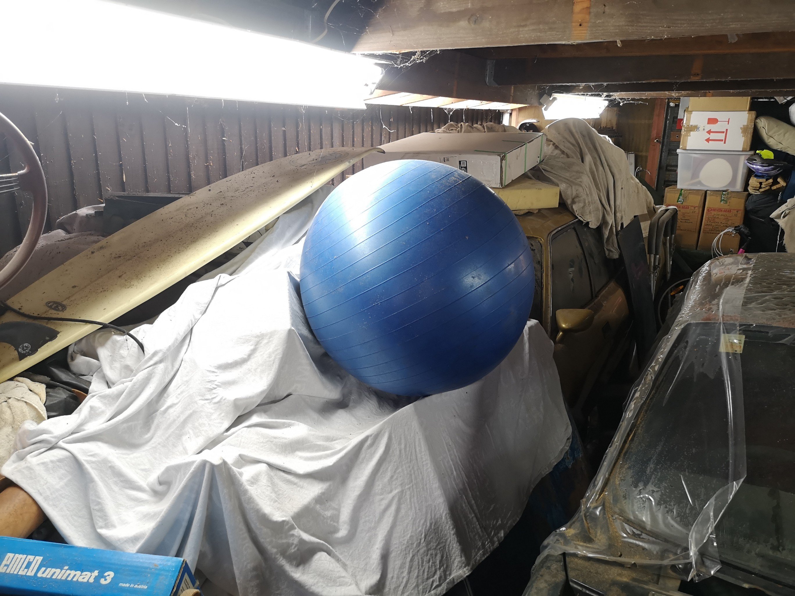

Popular Post yetchh Posted March 28, 2020 Author Popular Post Posted March 28, 2020 Had a bit of a tidy up today so as to make some room.. Forgot to take a before shot but this pile of shit, Was all over this, Much like this, Under that pile of shit (and car parts) is another car.. Anyway, pulled some of the pallet wrap off that I covered it in to stop rust, And she looks pretty good considering the last time I touched her was almost 4 years ago, couple of bits of surface rust from a dripping roof but otherwise should be good to go. The only hold up could possibly kid duty in these strange times.. 16 Quote
