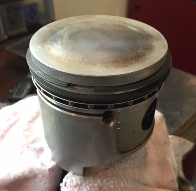

maxted Posted November 21, 2016 Author Posted November 21, 2016 well its been awhile, this has taken another 180 degree in direction with new plan to stick with the original donk to avoid certification and keep costs down, so pulled down the original 1600 NA to find the reason it smoked so bad, found all the 2nd and oil control rings gummed up and stuck in the grooves , but the rest of the motor looks really good so its getting a freshen up and going back in. so pulled the MA that was in there out ready for the 1600, managed to track down some new rings and a timing chain kit, hopefully get it back together this week and get it going sometime next week 5 Quote

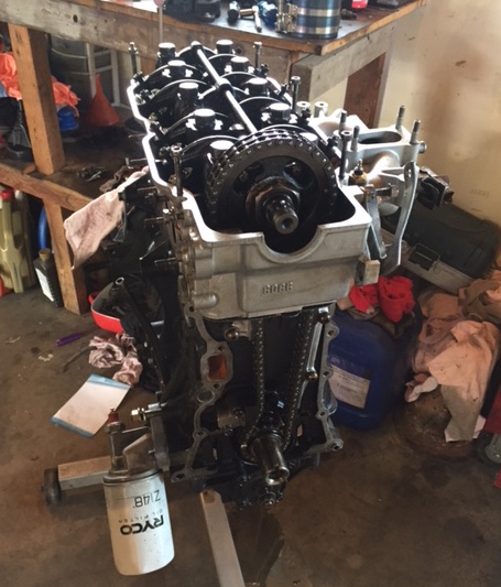

maxted Posted November 25, 2016 Author Posted November 25, 2016 engine progress new rings had the block honed new timing kit heads back on hopefully drop it back in over the weekend if i can find a exhaust manifold for it Quote

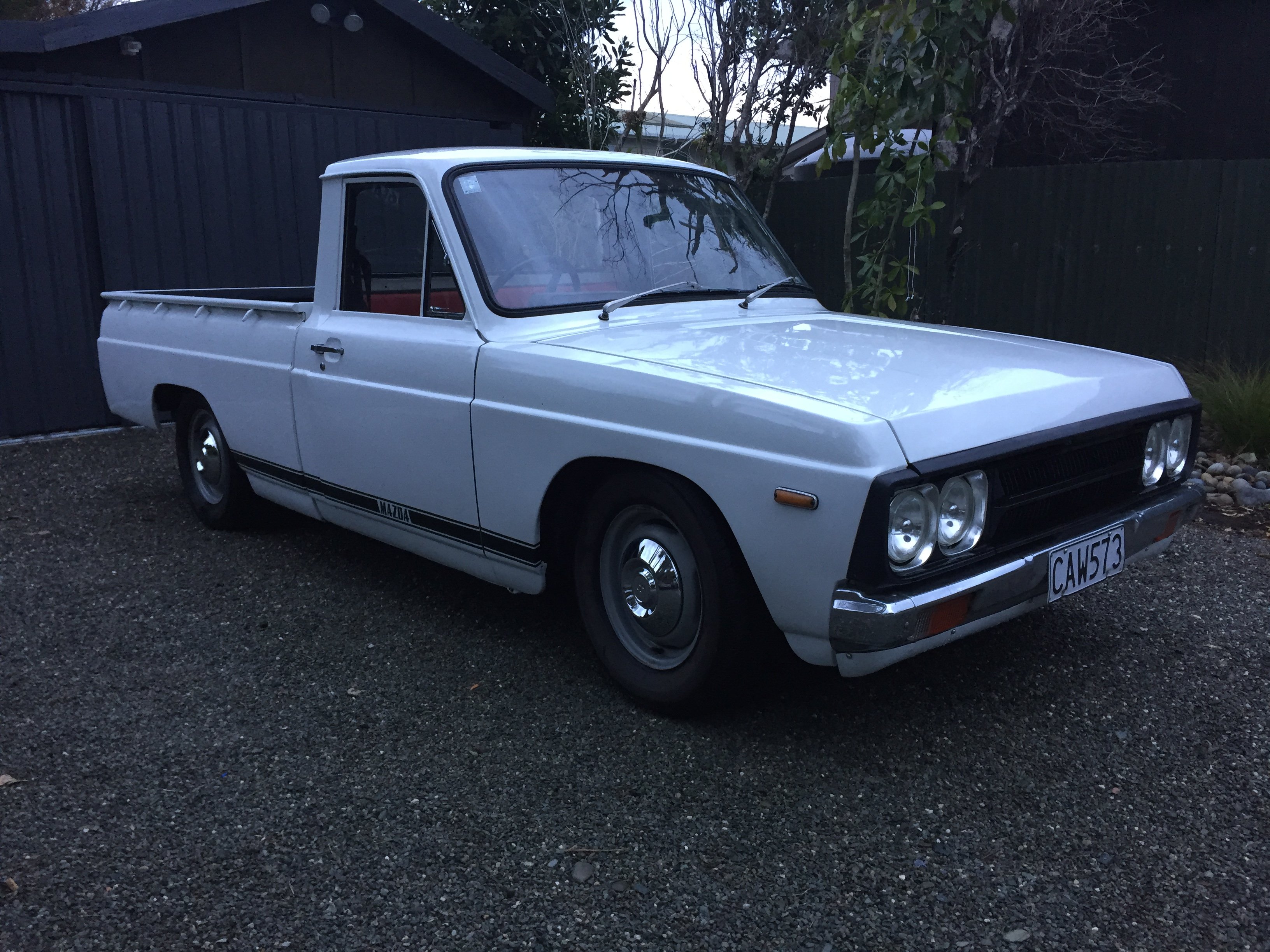

Popular Post maxted Posted March 31, 2019 Author Popular Post Posted March 31, 2019 dragged it out of storage got a wof and some rego, and a well needed clean 29 Quote

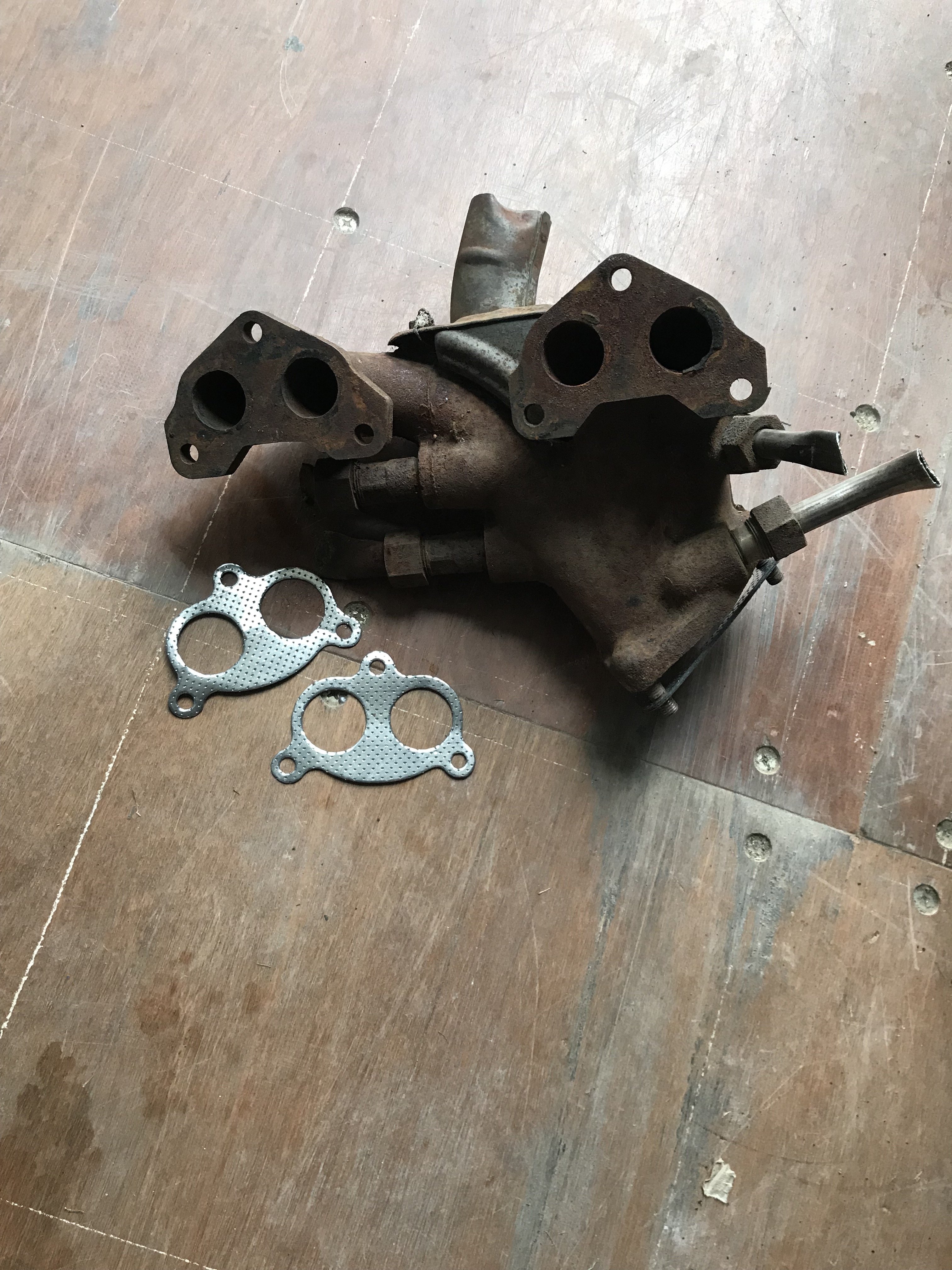

maxted Posted February 21, 2020 Author Posted February 21, 2020 managed to track down a round port exhaust manifold, will be so nice to have no exhaust leaks from using a square port manifold! 7 Quote

maxted Posted March 2, 2020 Author Posted March 2, 2020 Also cleaned up the round port manifold, trying out some por15 manifold paint this time the VHT flameproof is flaking off the last manifold I painted (maybe I didn't prep it well enough I can't remember), after looking in the engine bay I think the pipes coming out the side are going to foul the engine mount so might need to cut them short and plug weld them 6 Quote
