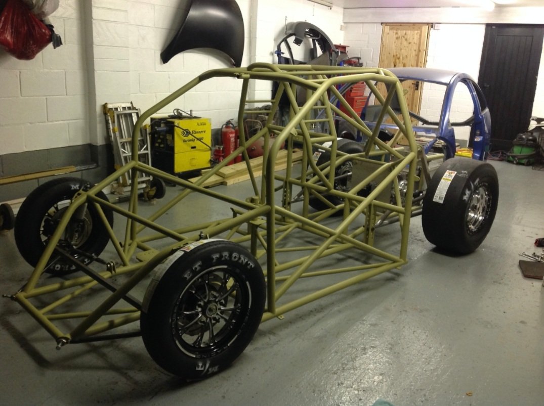

Popular Post sluggy Posted July 15, 2021 Author Popular Post Posted July 15, 2021 Oh the delays... After much looking and talking to authorities, the potential horsies versus the VW pan chassis I have is not going to fly. So I went looking for a chassis that will work with the power plant I have. I have found this in the UK. It is heading back to the chassis builder for more work ( Cotsweld engineering). Not sure when it will be down here, but a much better option and less likely to kill myself, which is a positive. Chassis is built to SFI specs to a 7.5 second standard. Intention is to add bars to get it to 6.5 s spec (not that it will ever go this fast) so completely future proofed. Rear end will be re done to make it IRS, currently a swingaxle set up. So one goes to the garage of broken dreams, and the project continues... year 9... 25 1 2 Quote
