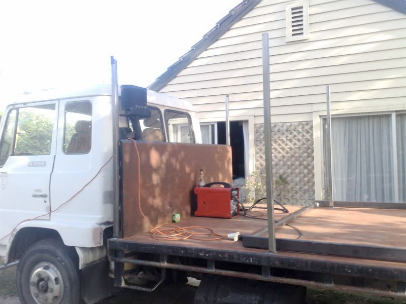

We managed to get one of the hardest parts done- the front over hang.
First off I levelled the truck out so our pet captive bubble would do its trick properly.
Then scratching heads we finally worked out the height of the first uprights. We want the cab to swing through so we keep engine access. after lots of balancing tricks with bits of steel we worked it out.

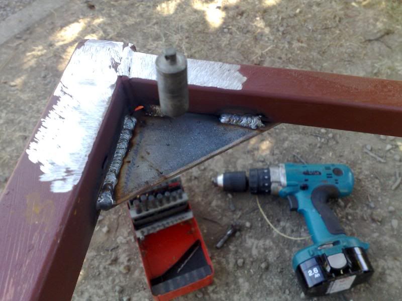

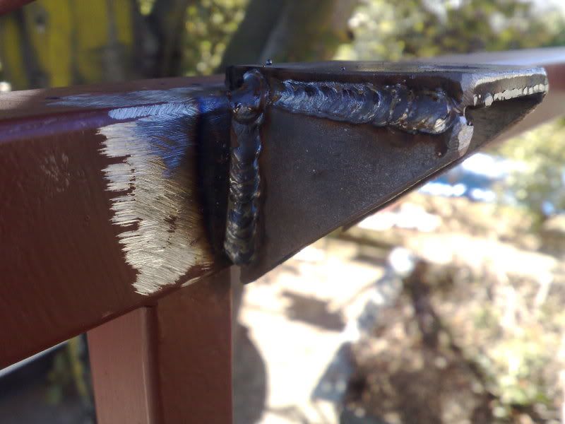

The little welder I brought over from UK that had done the marathon job on my RX3 works even better when its running off mains!!! very good penetration and clean easy welds- until the wind picks up. I had Hannah following me around with a sheet of cardboard to block the wind.
The forward facing 75 x 40 x 3 Rhs is bloody heavy but will do the job nicely. Its handy to have a big steel deck to build framework on before we hoisted it up.
Finally the framework was up and the bedroom area is huge!The cab swings through a treat too so very happy.
Tomorrow I will put extra bracing on where needed and continue on with front framework. Now to let knee rest.

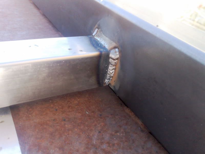

I chopped off the bottom leaving the still intact lip. Then cut some strips of steel and tacked them round circumference. Then welded right round and added a base. Very thin steel tested the MIG but it did OK. I did it in section alternating from one side to the other so it would end up warping.
Hopefully the wind will die down overnight (its blowing a gale right now) - if it doesn't I'll be pissed off!

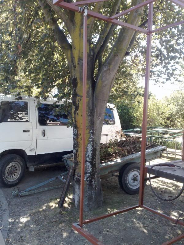

Good progress last few days. Painting of the frame has started. Only on the front as that is what has been built. we had to get more steel- i made a bit of a balls up when adding up my list of steel needed and got it wrong. I thought the pile looked a little small...
The front end is pretty much all done including the framework for the bedroom floor.
Bedroom floor- to be hinged at rear so cab will tilt through...
The front has some shape to it which will help it avoid being too much like a wall being pushed through the wind. Which it still is...

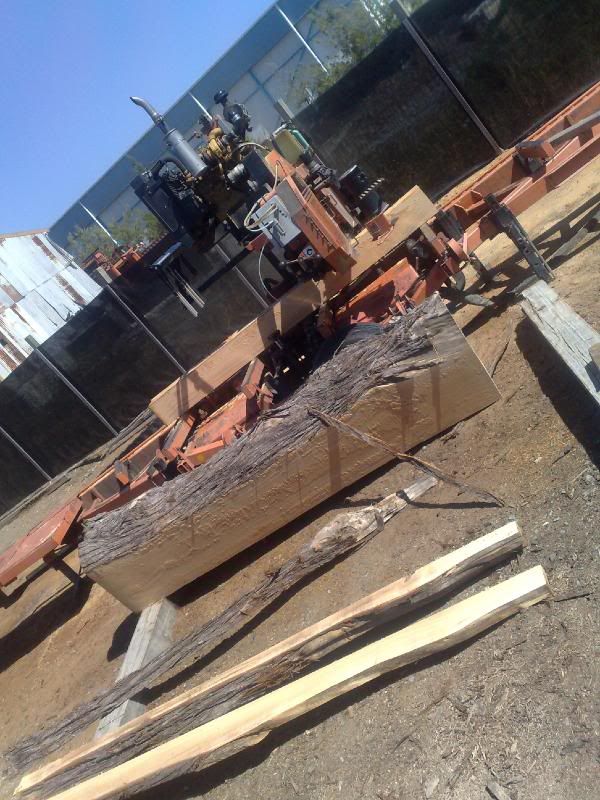

On way back through we stopped off at Plankville to get some rafter material. Brent at Plankville suggested cuts from a Macrocarpa trunk. So he fired up the mill and we ended up with some delicious cuts- really nice wavey edge and amazing grain patterns. We also got Redwood for bedroom rafters.
The mill is a cool machine to watch!
