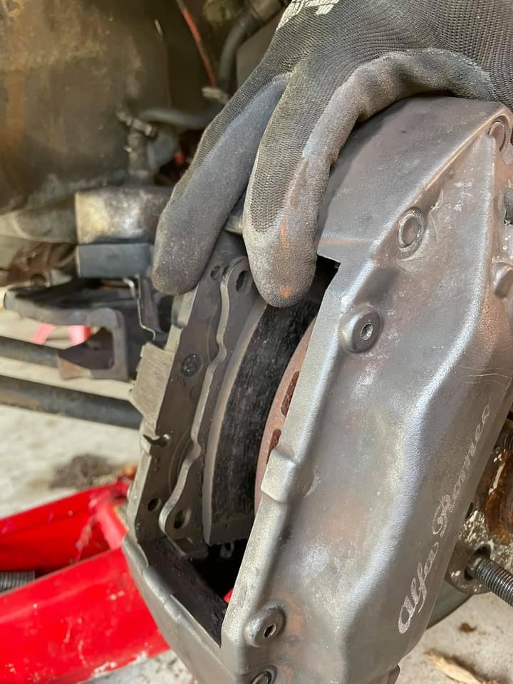

Popular Post Abarth Posted April 25, 2021 Author Popular Post Posted April 25, 2021 Got stuck into the brake situation this weekend. The front brakes have always been a bit scary, being single piston and not even really fully pressing on the surface of the brake pad. Whipped them off to trial fit some Brembos. Got two sets, Peugeot 406 ones and @zep Alfa 166 ones we snagged from pick a part a couple of weeks ago. 406 ones are slightly smaller but are still 4 pots and were the original preference. However on fitting them they are too much of a close fit to work with an adaptor. The Alfa ones however sat perfect with enough room for the adaptor plate to manage any offset issues. Factory Strada disc is 242mm and there is 25mm extra pad space to fill so 242mm + 25mm +25mm = 292mm. So upgrading to 305mm Fiat Turbo Coupe discs seem like the perfect fit. Next I’ll get the discs and start work on a wooden adaptor plate to see how it’ll all come together. 12 Quote
