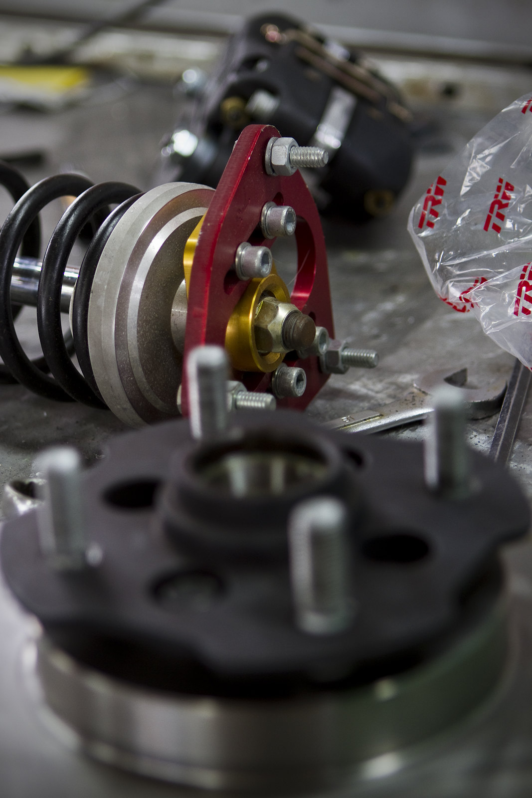

Well, it's going pretty ok for the most part. Anyway, I shall let the photos do the walking/talking/gawking.
This is how they looked all assembled at long last, everything torqued up, nice powdercoated brackets installed and hubs packed full of grease and topped off with nice new genuine Toyota dustcaps which I then polished because I could.
12668987465_ec8dfb4769_h.jpgIMG_9004 by Richard Opie, on Flickr
12669466724_9acdc588d0_h.jpgIMG_9009 by Richard Opie, on Flickr
Then I tried to fit them to the car, and this is where the smile was wiped off my face a bit. Ok so it was muggy, hot and generally uncomfortable and I got quite grumpy when this became apparent:
12669464054_83c7681819_h.jpgIMG_9018 by Richard Opie, on Flickr
Disc is touching the LCA! OH DEAR! Thankfully, due to the help of some Facebook buddies I've been pointed in the direction of Bugeye KP steering knuckles, which have a different balljoint offset vs the strut bolts. I have some en route to try out, so will test fit before I go sandblasting and coating and generally spending money on them.
