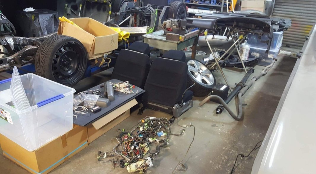

  3. hood
    Hoods Hilux's
    Here's the start of the tear down, and commencing the body drop. The WOF eventually ran out so Matt kindly headed my way to collect the truck, this was back in January of 2017. The body drop was started when Matt contracted out to Custom Metalshapers in Auckland, he got off to a pretty good start and the bulk of the labor was carried out within. If you've ever managed to step foot in this shop there's a large array of impressive tooling for sheet metal fabrication. More on the body drop on another installment of this build thread
