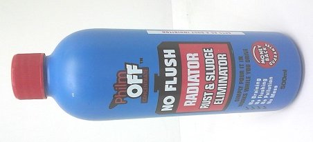

Was recommended this stuff by Burnside radiators for rusty coolant system, stays in the coolant for life of the coolant and keeps dissolving the rusty shit into inert solubleness. I got it from butlers automart. Seems to be working well, coolant in the lotus isn't rusty despite the condition of the gallery's. Not even expensive Sorry pic is sideways, was straight on Google. -
