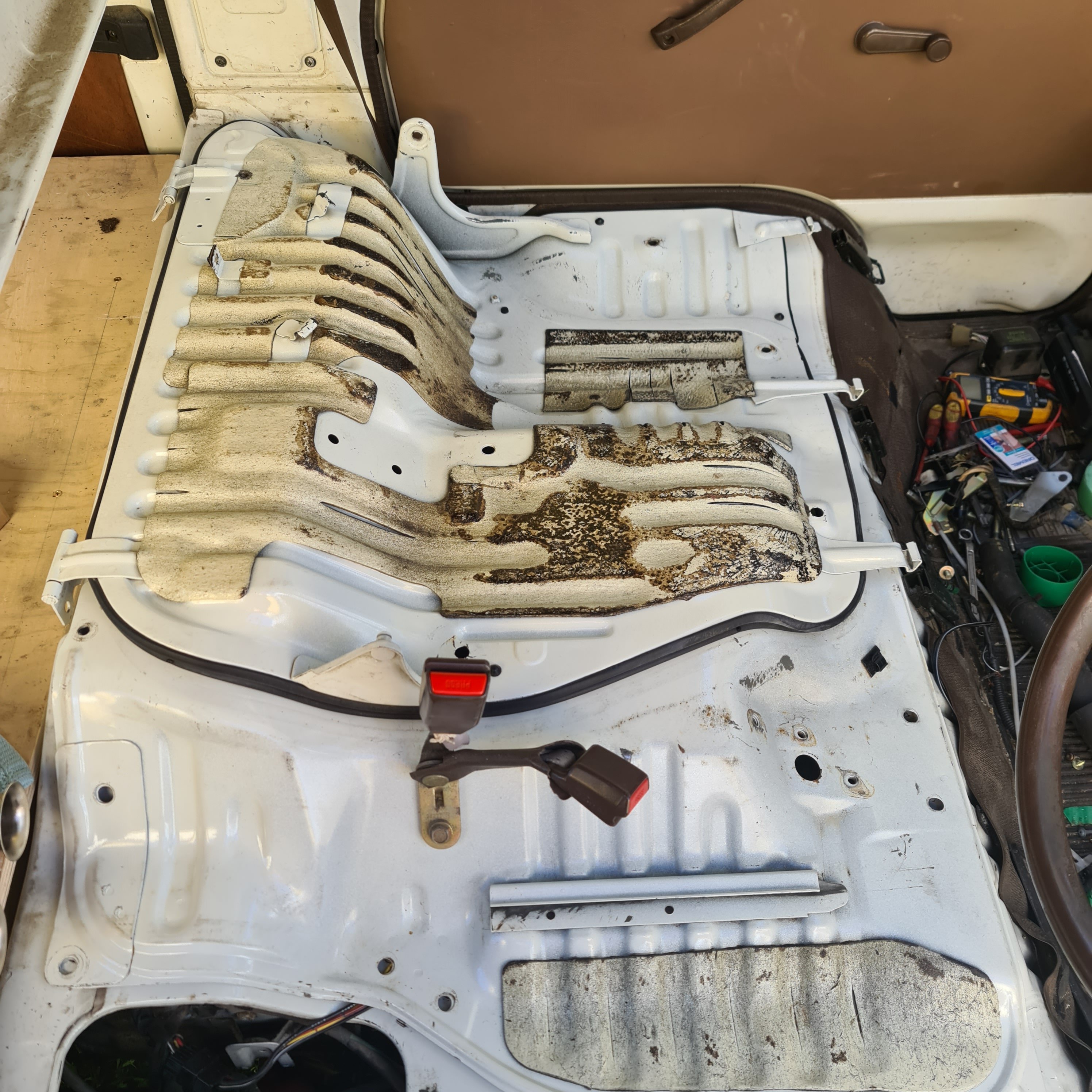

Is there a minimum clearance I would need from timing cover to seat cover?
I did look for an off the shelf shortened and winged sump and pickup as I read they have ground clearance issues putting 4age into the lotus 7 kit cars but couldn't find anything. It's a mater of the least amount of work which is modding seat rather than new mounts and sump/pickup. I could cut a slot the running same direction as timing cover and still be atleast 100mm away from seatbelt mount and seat rail which is the only mounting on left side of drivers seat? There's an additional skin below which has a bulge in exactly the wrong place which isn't helpful
Here's the first part of bonnet which just hits on the timing belt cover. proximity to the seatbelt is what I was worried about
Wondering if someone has a smart idea (cert happy)to overcome my engine fouling on bonnet/seat in my liteace. I planned on dropping the engine but I don't want the sump to be lowest point of van and it's actually ideal where it is. an idea I had was spacing the entire lot up with a 15-20mm flat bar continuously around red line with holes drilled so everything uses original fastener holes with longer bolts. Is there an alternative material that could be used that's a bit easier for average Joe to bend
