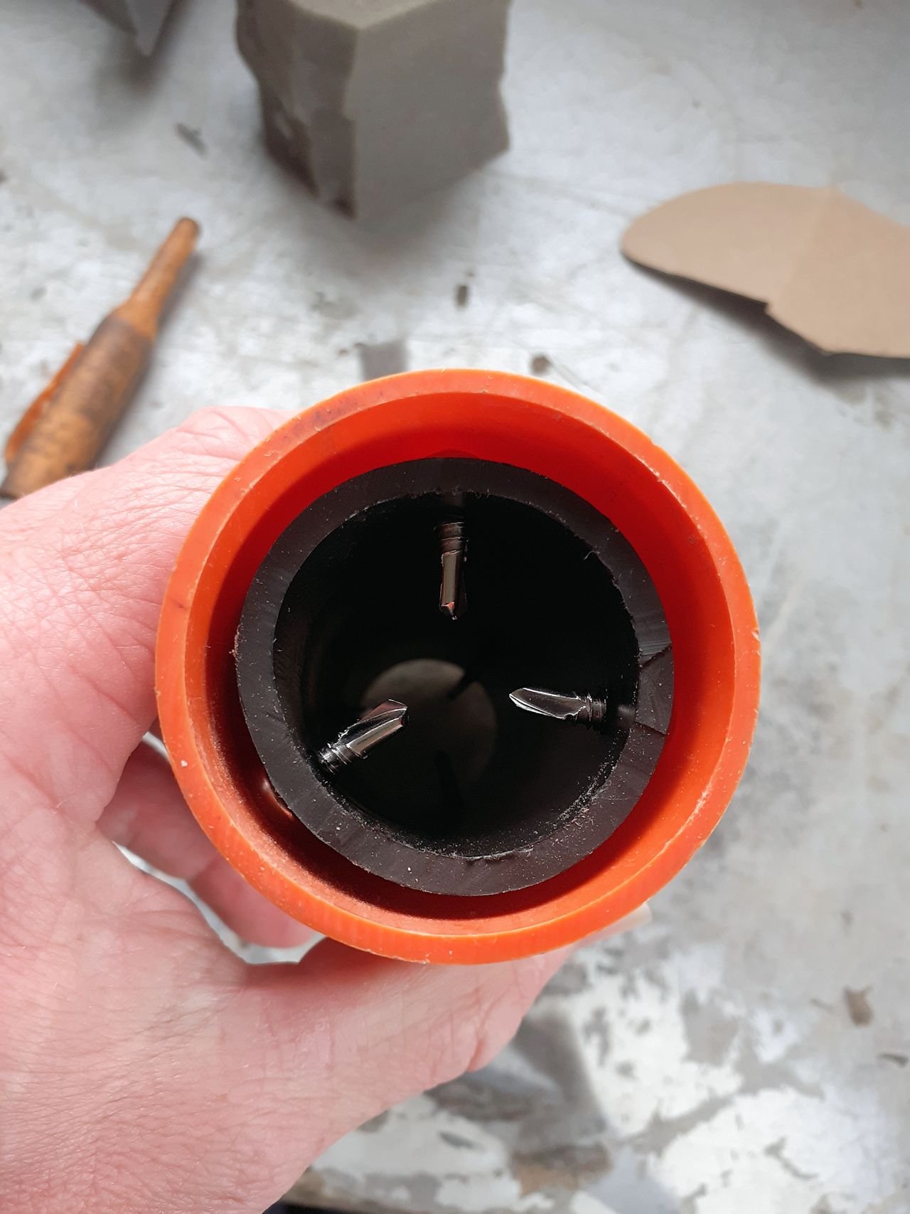

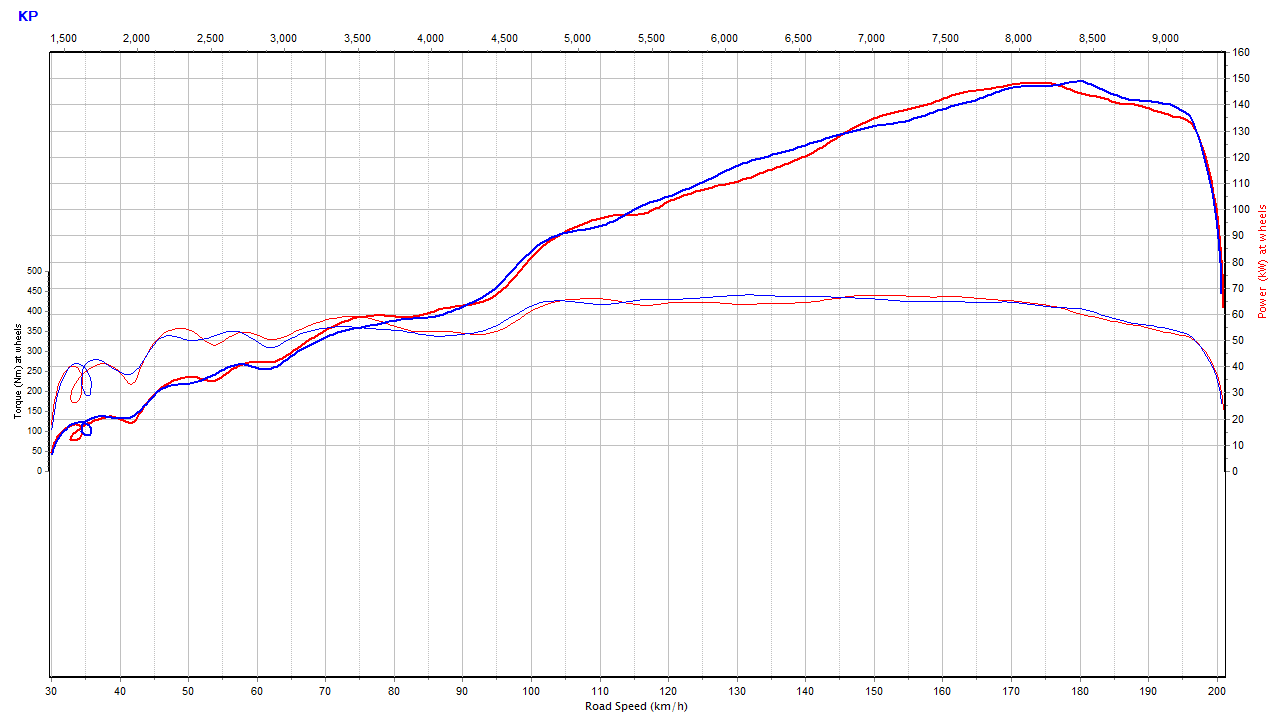

  18. So, black pipe is 37mmm id. orange 51mm. below chart is with the pipe slid in and out like pic one and pic 2 . red being out. blue being in. the pipe wasn't slid out as much as in pic one. but it didn't make a lot of difference how far out it was. What i was trying to do here, is to see if a 2 stage, small then big diameter variable setup is worth attempting. Obviously my pipe sizes are off and the outer would need to be a lot bigger. Since loosing 15kw over normal setup up to, and down low is acting like a smaller diameter pipe still. green line added is the big 51-62 pipes as per bottom pic getting rid of the outer 51mm run. leaving the 37mm in the position of pic 2 vs the big 51-62. Would likely be very hard to combine the 2 whilst having a working mechanical 2 stage without screwing up the flow on the high rpm side. but could be worth chasing with some different sized fixed setups to see if its possible. I would set it up opposite to what i've done here. so the inner smaller runner was fixed. the outer would slide back towards the engine creating a higher flowing shorter path. Doesn't look much in the above chart, so some numbers on this one. pretty decent gain at those low rpm's
  19. Sweet keen to give them a jam. I also tried a runner inside a runner the other day, but my sizes were off. so didn't give the results i hoped. will get a pic tomorrow of what i was attempting

  22. Thought the inlet size would be brought up. Way i see it, once the inlet pipe is that big, its just a way to direct cold air rather than some kind of intake tuning. We already know cold air makes more power so isn't really relevant. There wasn't much difference in the 3" hole vs the 4" hole. red 3" hole blue 4" hole small difference in favor of 4" hole. but could almost go down to slightly different temps rather than a gain to 4" hole. But even giving the couple of kw gain to the 4" hole. would be diminishing returns going even bigger Could probably move that bump at 7500 up the rev range a bit. but would likely drag the dips up with it as well. So to me looks like would end up with the same power curve as the open throttles. below is the same chart but the green hilux inlet run removed. so can see the difference more clearly. can see how it just trades power
  23. I just finished testing that abortion that i built. Its roughly 9-10L Best i could get it to work was with a 4" hole and no intake pipe. although with the pipes there wasn't much difference. It changed the power curve a bit. vs the open throttles. just traded power here and there rather than one beating the other over all. So in my case at least, the airbox can match the open throttles but no better. Kinda limited testing. but conclusion I've come to so far, Is the airbox needs to be big as possible along with feed pipe. and is basically used to direct cold air, which is where the gains are , rather than the box doing anything fancy itself red - airbox with 4" hole blue - open throttles both above identical trumpets green is the plenum off the hilux. which i though did pretty good. considering how the last one performed na
