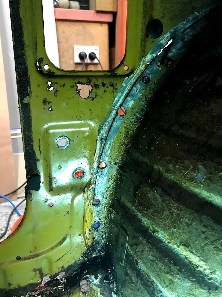

  9. Started on the rust repairs, spot weld drilling. 1972 Honda wasn't very consistent with the spot weld positioning:

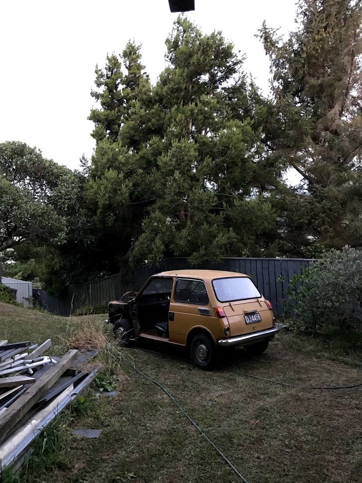

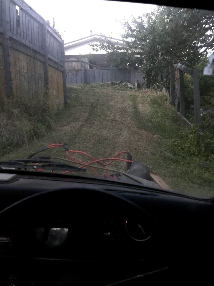

  10. Time to get this out of the little garage at the bottom of the property, the house is built into a hill so the back section is multiple levels. There is a 'grass driveway' to get up, I thought it would be fine since it hasn't rained for a while. Nope. 27hp grass skids and the best I could get to was 3/4" of the way up, it doesn't look steep but it is: Oh and it started fine after sitting for ages. Look at it, majestic: It got dark so I gave up and got the Safari lined up to winch it up. Top of the hill with winch rope leading down to it: My view watching it drive itself up the hill: Let it idle outside, not sure why...the engine is coming out anyway. My boy wanted to know how to write my name with his chalk, but only the last 3 letters. Cool. In the garage with the other car I should really be working on.

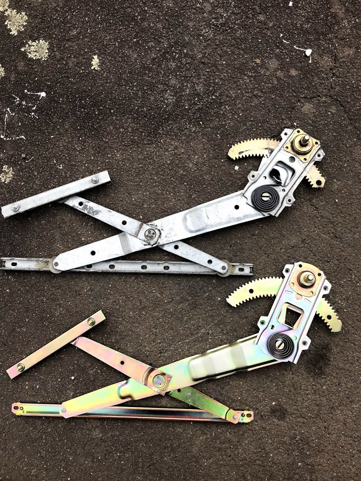

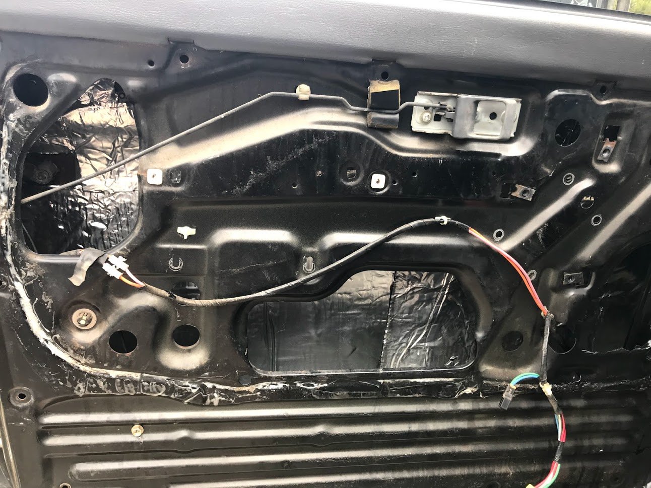

  18. Window regulator gear ran out of teeth in the Bunnings car park, while it was half way down. Which was annoying because I was only there to return their stupid pre-emptied mig gas bottle. New one: While I was in there, I put in some sound deadening sheets. Took a photo after I'd put the sheet in to the left, all that was from factory was the small bit in the centre. Weirdly, when I got this Safari it felt so quiet compared to my Landcruiser BJ73, will be interesting to see what a difference sound deadening all doors will make. After, almost all inside surface covered. When I closed the door it sounds and feels like a luxury car, so impressed. For example when I close the other three doors they close with a echo'y metallic bang rattle of sorts, or if you tap on the door skin its the same. But the door with the sound deadening sheets inside closes with a satisfying muted thud, it weirdly makes the door feel more solid. Will definitely be doing the other doors.

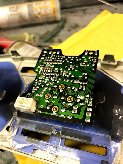

  22. Not having much luck getting any kind of reading on the speedometer using a Yellowbox speed corrector, a Dakota Digital SGI-5E or just straight off the gearbox speed sensor. Both the Yellowbox and the Dakota Digital register that there is a pulse signal so the sensor and wiring must be ok. I am going to use the Yellow box to adjust the rev counter signal anyway, so I got the SGI-5E because it is meant to work with basically anything but I can't get it to register anything on the gauge either. The wiring on the back of the speedo is pretty simple, 4 terminals (2P (speed sensor input (EDIT turns out this is an output for the original Nissan ECU)), IGN power, 12+ power and ground). I thought maybe the 180sx speedo is dead. I don't remember whether it worked when I did a made dash test drive on totally private roads in the banana'd chassis. So tried the S14 one that came with the race car rolling body, don't know if it actually works either but assume it does because the rolling body was a rolling body because an sr20 threw a rod at Manfeild. Rolling body. Tried it anyway and got nothing. So I thought maybe the 180sx speedo could have a dry solder or something, took it apart and it looks ok. A little bit of crusty stuff around 4 of the solders but I think this is just the melted coating of the board. I resoldered these 4 anyway. I think the toyota speed sensor is a Hall Effect which is compatible with the Dakota Digital and it flashes showing the pulse so that must be fine. Not much info on what the Nissan speedo is expecting, I found a website saying that it should be 16000ppm which again should be fine with the DD. I've tried all 5 outputs on the DD and get nothing. I've tried the test function on the DD which outputs a few tests which should show on the speedo but it doesn't budge. Frustrating.
