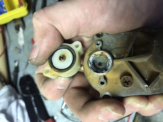

  6. At this stage I don't think I'll use it, so its probably more use to you. Unless the computer is hidden under the dash or something silly so I can have a play with it, otherwise you can have it for free. Yep it had a ball bearing inside, cool design. Never seen anything like it before.

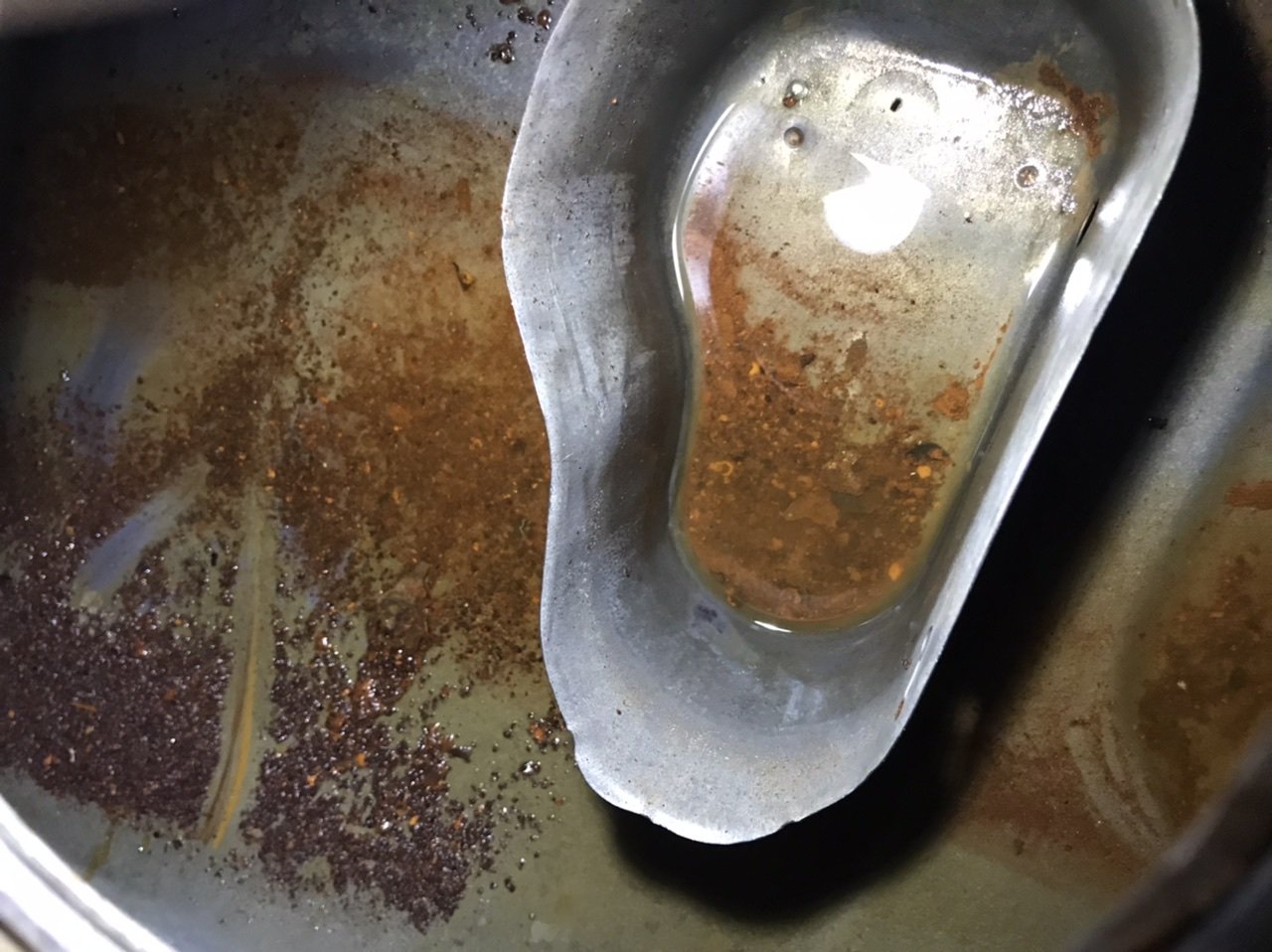

  20. FUUUCK... Was not rusty like this when I put the pump in a few years ago. Maybe it just wasn’t visible and it washed of with a full tank? Have a ‘new’ good tank to go in.
