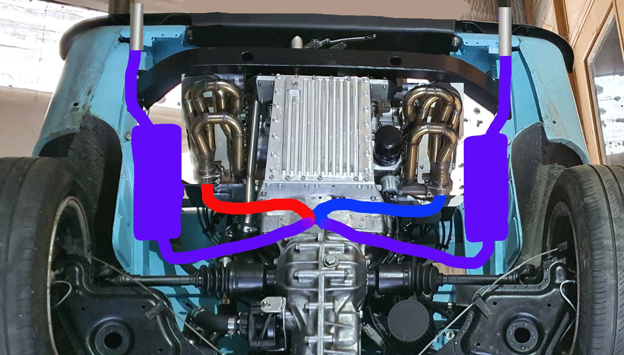

Are these the stock headers from your generation of Goldwing engine?
They don't look equal length, which might mean less of a smooth / clean straight 6 sound than you're currently getting?
Here's what you do:
- Swap the headers left and right - they'll bolt straight up and fit perfectly without fouling the crossmember (guaranteed), and the outlets will point forward
- Run new pipes from each header to partially merge in some sort of crossover x-pipe under the engine, but offset it slightly to one side (make the blue pipe and red pipe different lengths) to vary the amount of flat 6 vs straight 6 sound
- Put mufflers under both sides of the car alongside the engine, with exhaust outlets close enough to the ends of the bumper that the fumes get swept away
Put some chrome tips on so it looks staunch as
Alternatively, I see the classic Porsche single rear muffler was a hotdog shape / cylindrical with rounded ends, which must be for a reason.. Maybe you want to avoid large flat parallel surfaces where possible, to break up standing waves / reduce resonance / for strength? I definitely know what I'm talking about because of all the exhaust fabrication I do for a day job.

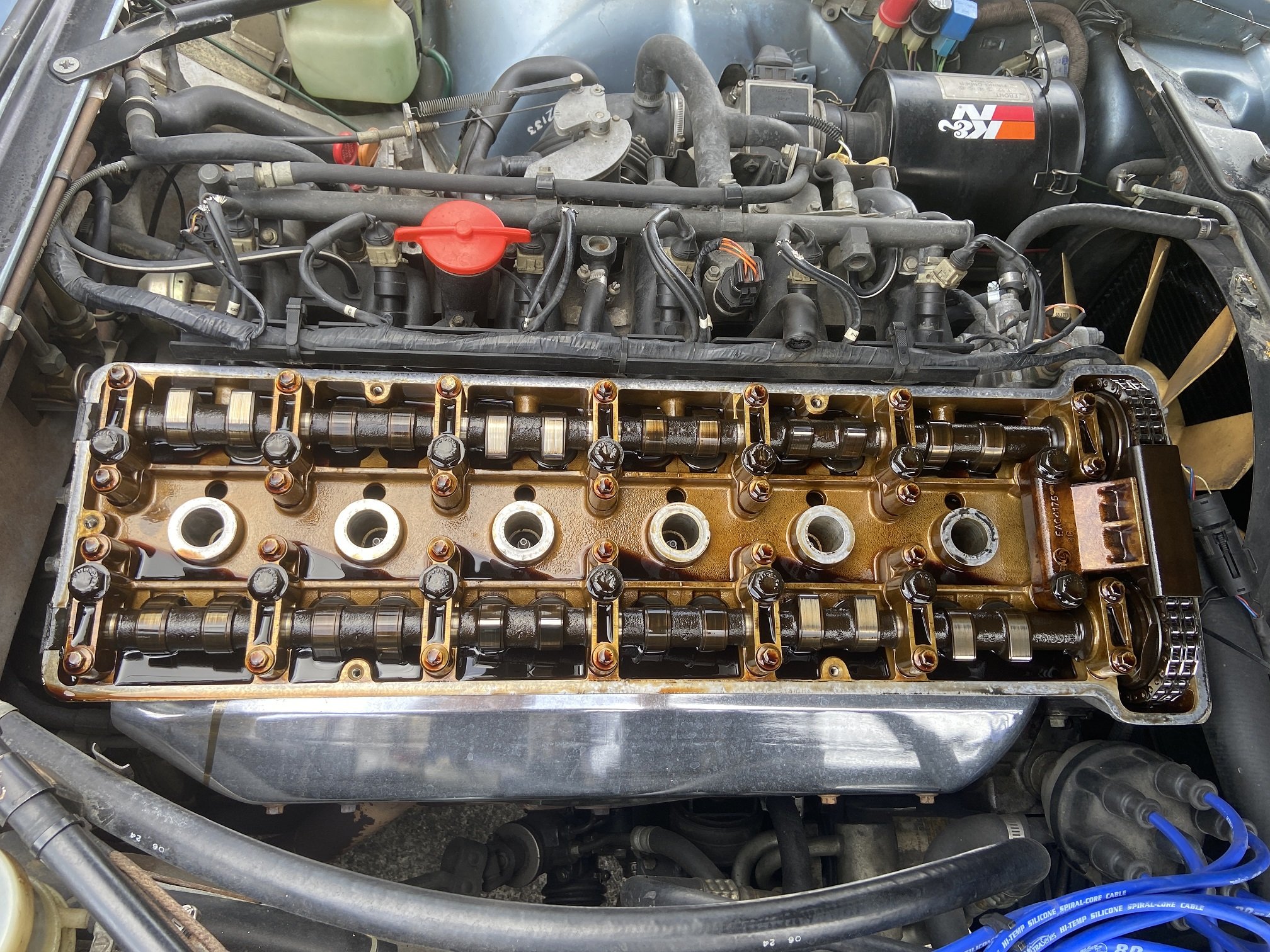

Now back to our regularly-scheduled programme - the impossible quest to make a Jaguar XJ-S into a good car. I decided to install the rocker cover gasket I bought when I was worried that oil leaking into the spark plug wells was causing misfires. The end snapped off the cam breather hose when I tried to detach the hose from the cam cover, so I guess the hose gets to be shorter now.
Check out the mighty 24V DOHC valvetrain which gives the AJ6 the ability to rev all the way to 5750 or so..
