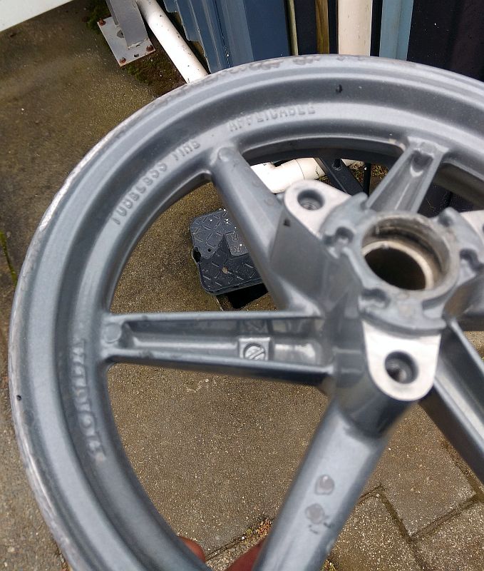

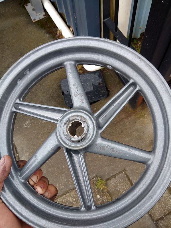

Stoped in at the painters just before and showed him, he's fucked off it's happened and wants me to bring the part that's gone to shit in and he said he will make 100% sure it's fixed for me! Says that it's possible Honda used some kinda wax when molding the plastic that's absorbed into it, has a few ideas for a solution though, so that's good! Rode through town earlier on the way to the paint shop, so so many people turning their heads trying to check it out, courier driver just about crashed as he was too focused on the Gyro haha -

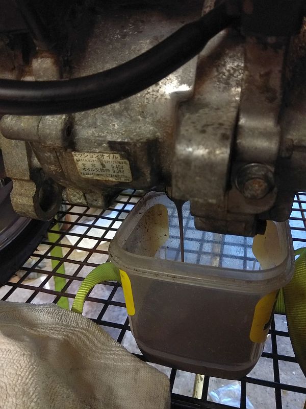

The gearbox/diff takes 400ml of 10w30 engine oil... Got 100ml-ish of this out... Think I might leave it at that for tonight... New page soon -

Also discovered that the primer hasn't adhered to the plastic, slightest knick and it will peel off in a sheet, thankfully the worst peeled off offcuts, but fuck it looks like it'll need to be repainted ASAP! Looking for advice on WTF to use to get primer to etch into/stick to the PVC (I think) plastic, one wash and this thing will be white again! That's a shanked bolt, the head barely contacts the paint at all, look close and you'll see the massive bubble -

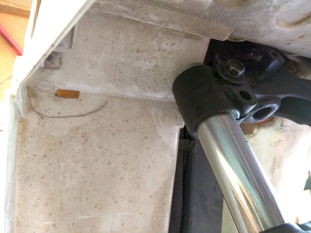

That hurt! Ended up taking a bit more off too! Took a template from it once done and cut the other side too! -

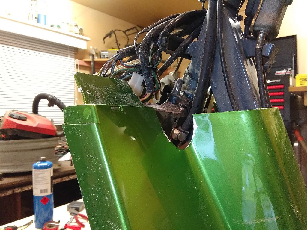

Back to the plastics, I realized that option A was never going to be an option, so once I had all the wiring, controls (which I still want to replace one day) and cables tidied up and ready to cover and I'd run out of ways to put it of any longer I just had to go for it! -

Now I knew how much had to be cut up to clear the forks, I had a fairly hard choice to make, do I A: go back to a stock leading link fork and save the AF35 shocks and disk brake for my Matty B hack build? Or B: bring myself to attack rather pricey brand new plastics coated in an equally expensive coat of paint? -

A quick test fit of the old plastics very quickly highlighted what was lost in translation! q Yeah that ain't going to cut it! -

Stepping back in time a week or so now. When I brought the AF35 fork and AF56 stem combo I was told by a couple different guys in Japan that I won't have much steering etc, thanks to the language issues we had I had taken it to mean that the fork hit the steering stop etc on the frame, which is part was right (I posted my mod to get around that a while back) Turns out there was more to it than that though! -

Bike shop came to the party though and offered to cover the cost of recoating and the new bearings I'd fitted etc. So another week later (today) I got it back again -
