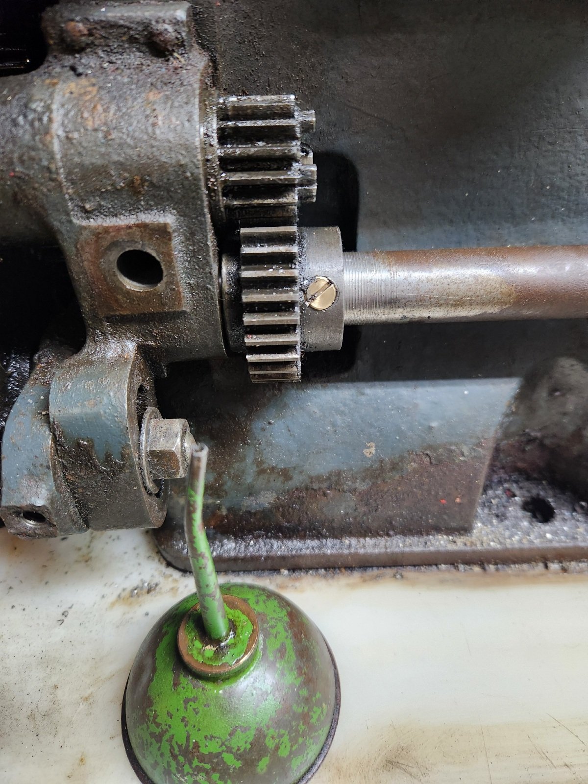

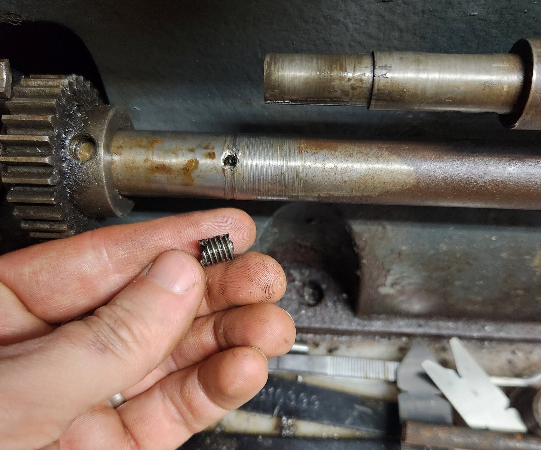

This is the power feed shaft, gear, and what should be a brass shear bolt.

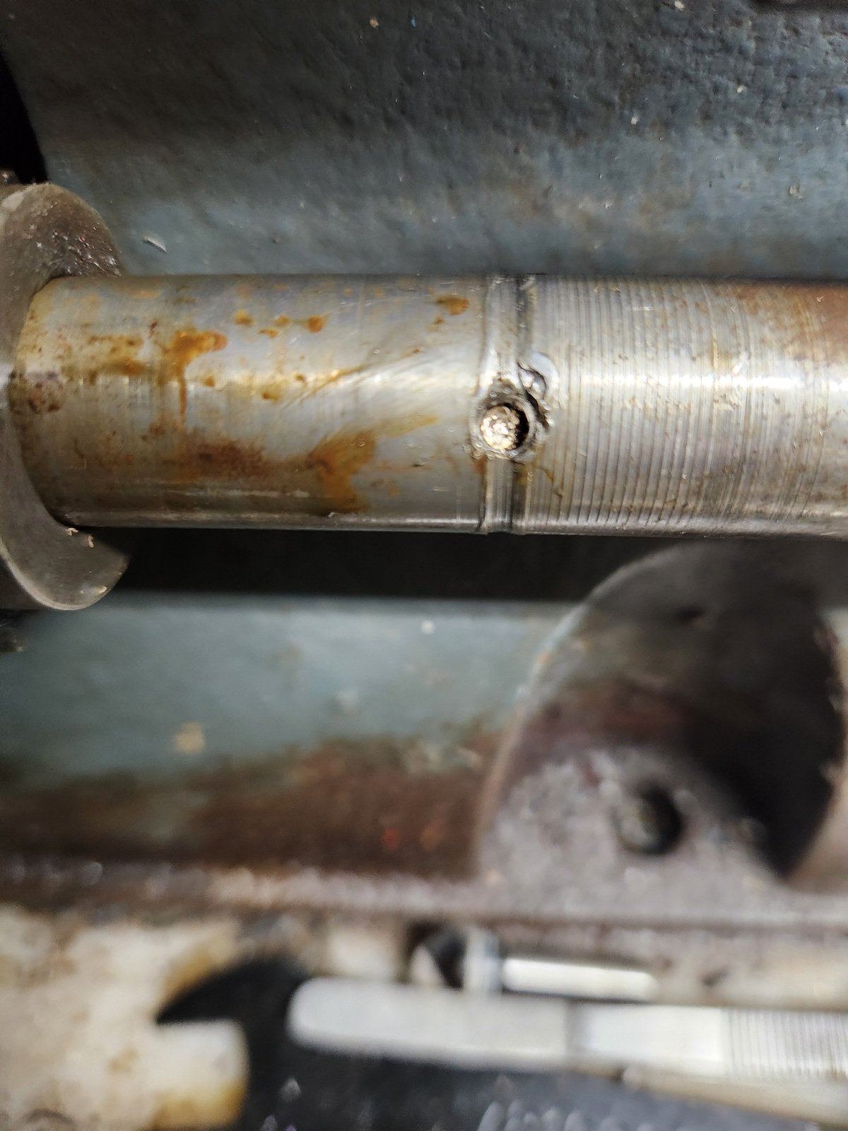

as you can see,the lathe has been crashed at some point (at one point really well, theres a beautifully rebuilt, half braze and new teeth cut gear in the apron) and the original has been broken, and a mild steel one made. This has apparently also broken and groved the shaft where its spun. But not drastically.
i thought it would be a right pain to drill out, and was going to mount the shaft on some V blocks and drill a new hole a little bigger. But itnturns out they just left most of the original pin in there and made the new steel one shorter. So once i drilled the nub off the brass one just fell out. Later shafts have a through hole so you can punch the nub out apparently.

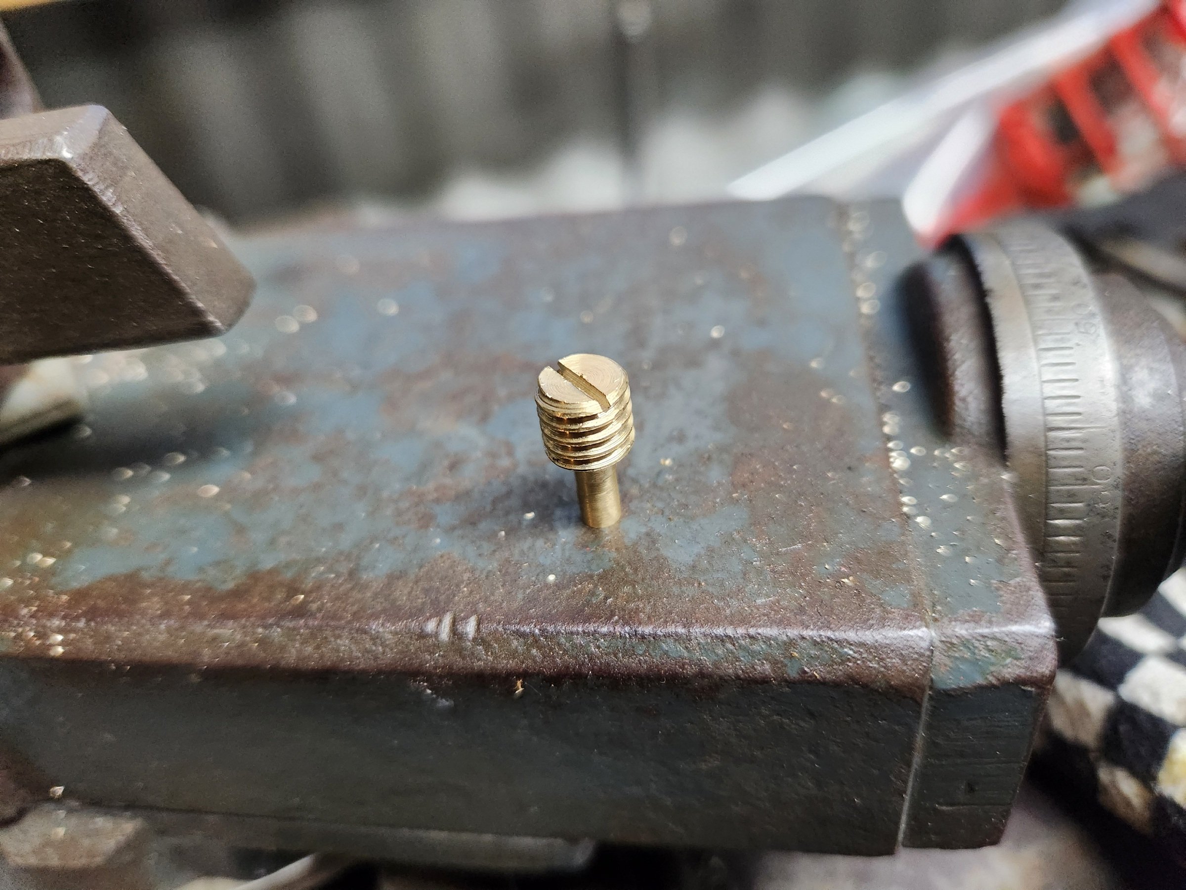

Got some 8mm brass rod. Spun it down to 7.94mm so i could apply the only thread you will ever need, a nice 5/16 BSW. One could not help but feel a surge of loyalty to Crown and Empire at the sight of it.
Then i locked the chuck in place and with a thin parting tool mounted on its side in the tool post, i cranked the cross slide back and forth a hundred or so times to make a screwdriver slot, sized off an old wooden handled turnscrew for authenticity. Then spun the pin down to size and parted it off.
Wow it fits and the shaft turns, and didnt break off when i twisted the gear and shaft in opposite directions by hand. Very nice, will be handy to have power feed going.

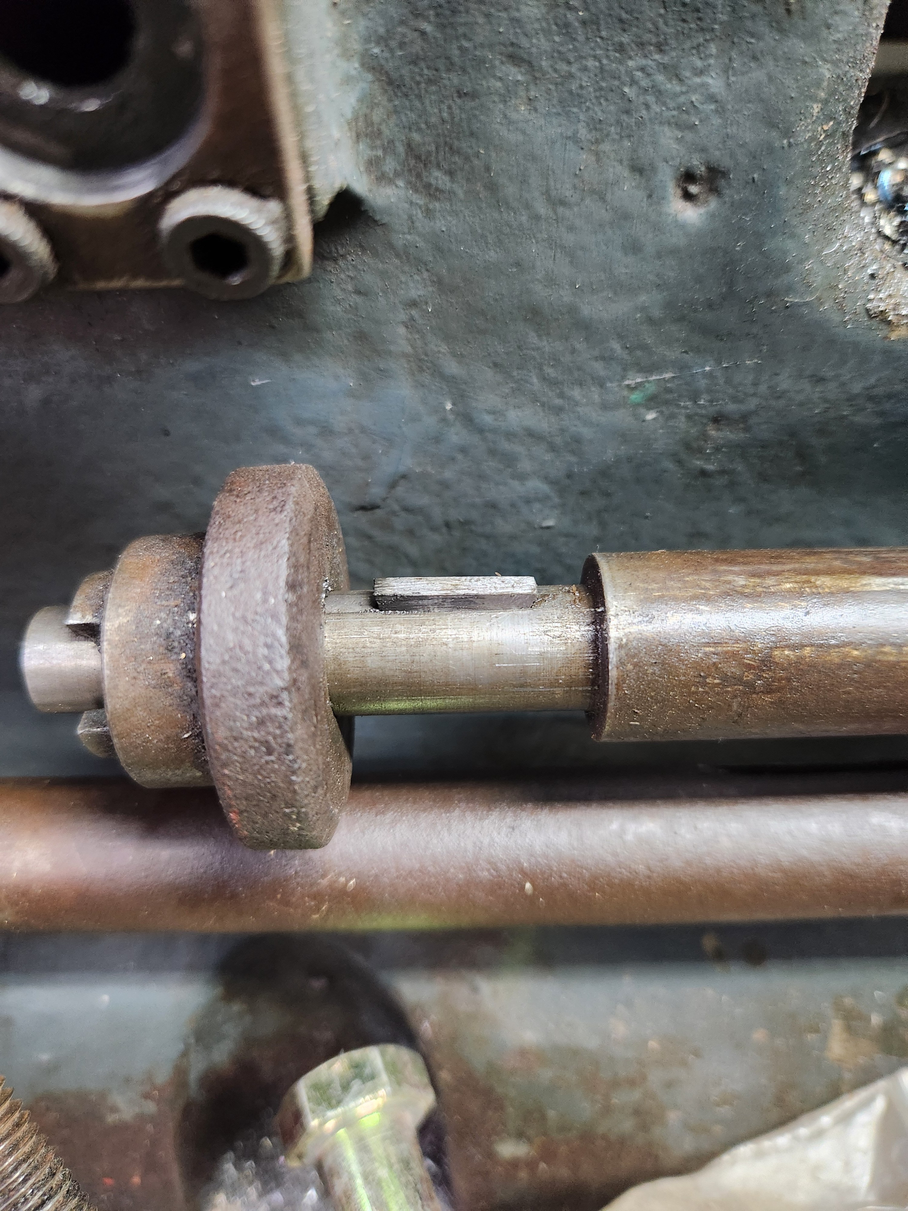

Next is the dog gear for the leadscrew. Im missing the (imperial sized) woodruff key and a bsw grub screw. So more of the same. I dont really want to pay postage on a single woodruff key tbh
