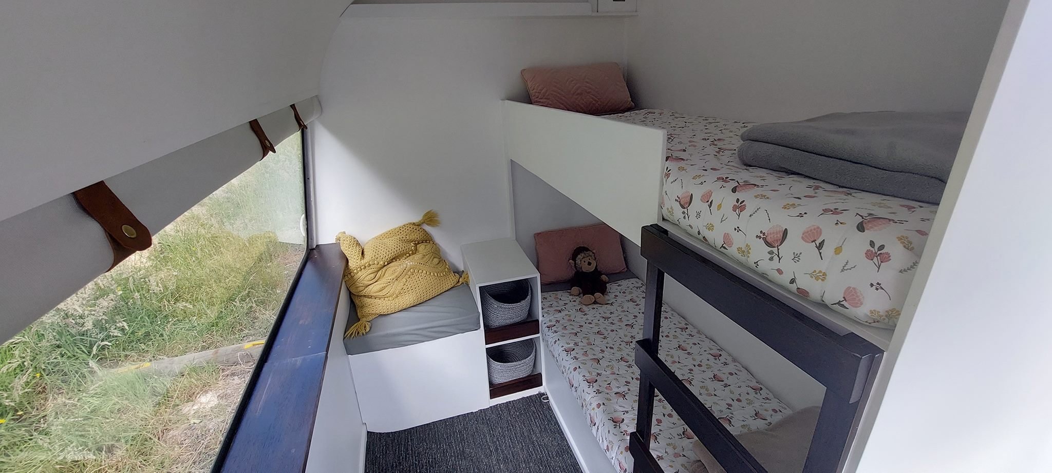

  3. Going to change the top from ply to acacia to match the bench top. New carpet square's for the kids room courtesy of Rosie O'Grady's Irish Pub (RIP) Mt Maunganui:
  4. This curved piece was bugging me so decided to square it up and make a shelf under the window:
  5. Bunks with storage under, boom: Emergency loo (for self containment) and shelves to go to the left.
  6. New quality laminate flooring and relining done. Wall to separate the kids room and provide support for the new bunks:
