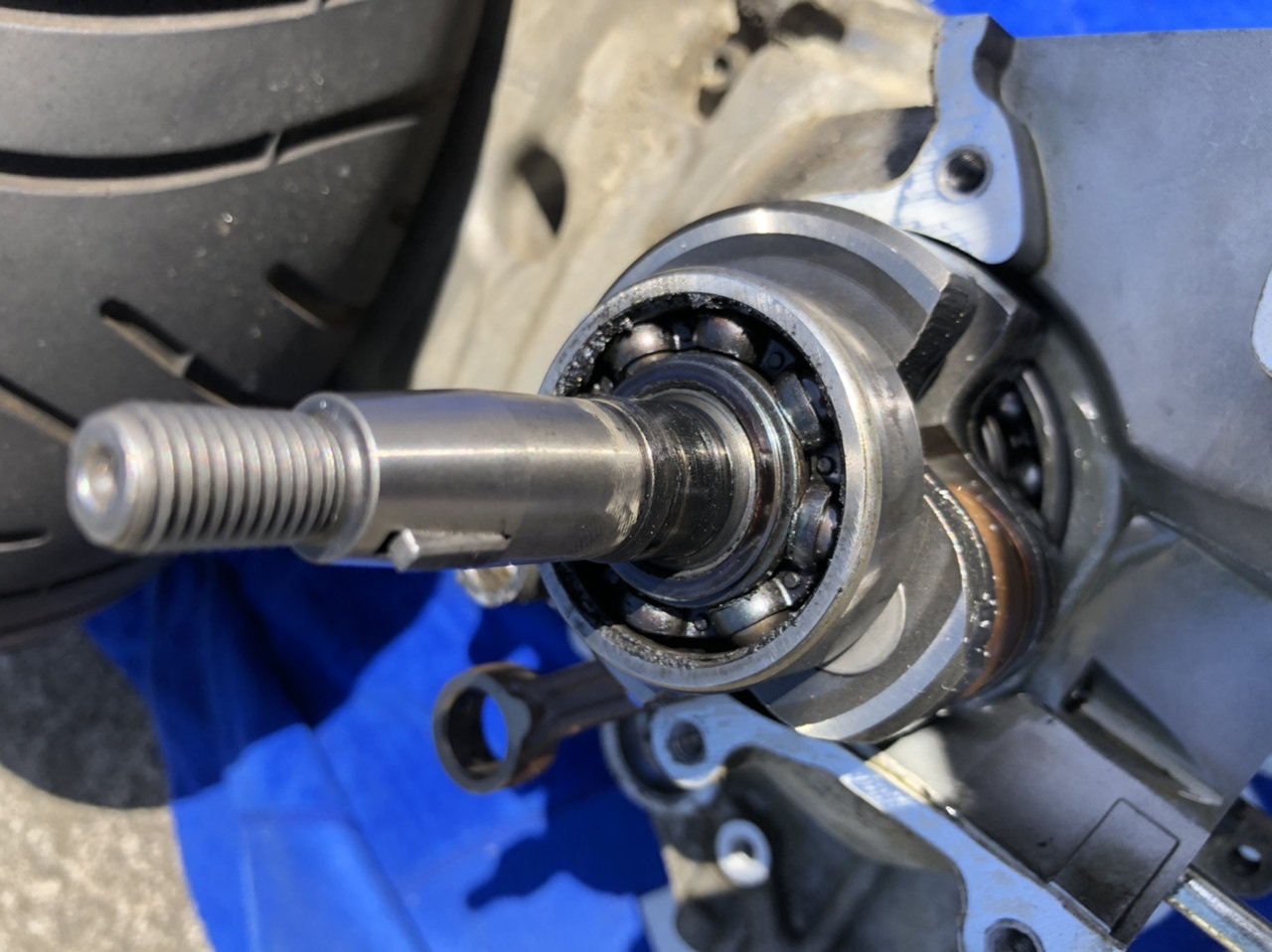

Pulled bike apart, turns out I had water in the carb which was causing it to dirA, but also had a busted stator aide bearing, properly pulled apart now, but anyon e know why I have so. Much crud on this bearing side? Maybe I should get a shielded bearing next time and only take off a cover on one side
