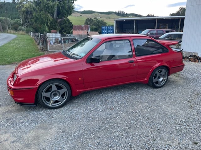

Well I was super happy about having a list and I loved the excessive noise… that’s because I cut out the muffler cause it had holes in it .so I went about putting a new muffler on and adjusted lights replaced lower control arm even though it was brand new but was rubber and had excessive play which they showed me so I cut the rubber bush out of it and replaced it with a Nolythane bush out of the old one I had and that seemed to make the caster much better got a new rack end for the steering rack and finished other jobs took it for retest and pow I got a WOF and then Registration so I’m on the road for summer ……… so happy so after 3 years it’s legal again of course there’s still bits and pieces to do but in the meantime I’ll just enjoy

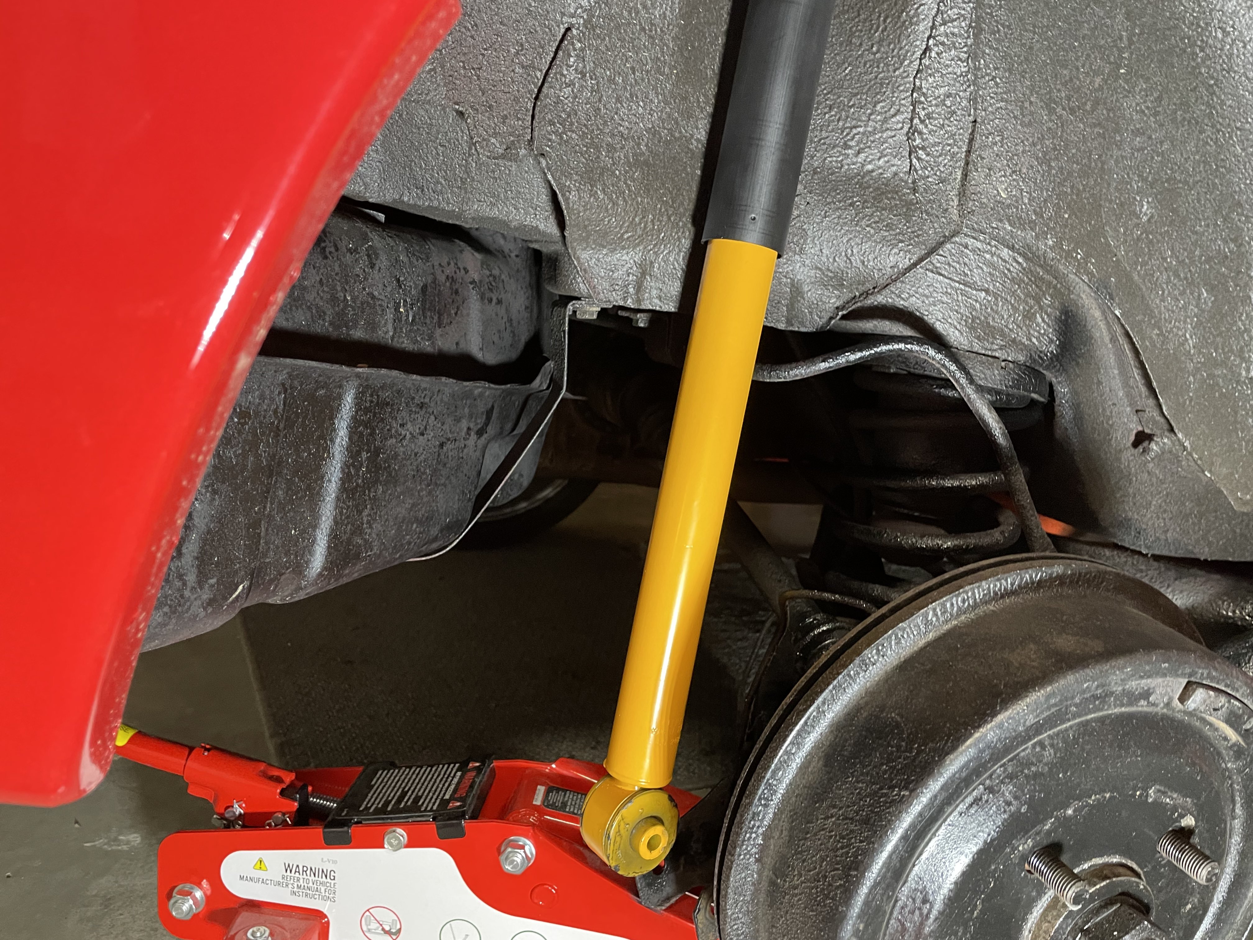

I also brought some new suspension which I have fitted just the rear at the moment I hope to fit the front over the next week , also I’ve had the side glass turn up so that’s another job to do anyway that’s all for now

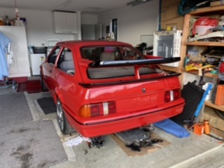

Got some photos of it in the garage before I took it out to my mates place , just to look at I’m still trying to get rear side windows but they are like hens teeth
