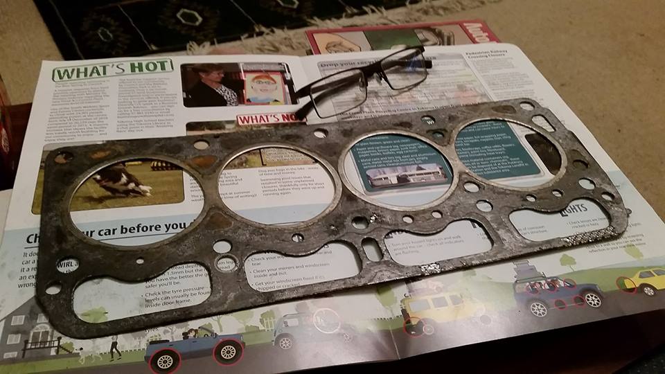

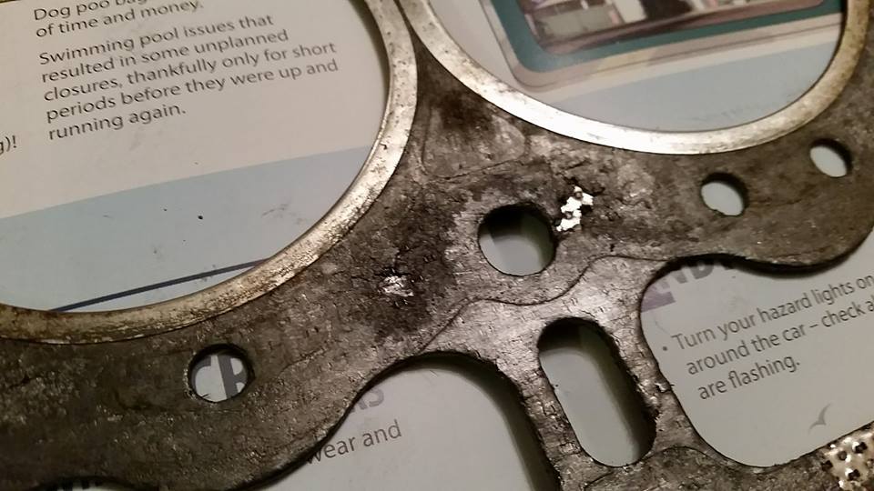

  19. Hi all, any k engine guru's know if theres much difference between 3k/4k head gaskets? I've managed to cook my 4k (seized thermostat! ) and pulled it out, its an aftermarket 3k gasket which seems to be missing plenty of the water jacket holes, does this matter? first pic is the one i've just pulled out, second pic is some chinese one which has passages that match that of head/block. 3rd picture is where I assume this one has failed. Chur
  20. Well, tits. Hooked up the speedo cable (bodged ke20), a vacuum gauge (epic bodge involving the cut down end of an old grease gun extension, v proud) and a new temp gauge. Had the thing running for a while (perhaps 10 min) when I plugged the temp sender in, oh f**k its boiling! turns out the thermostat was seized shut, didn't even think to check if the radiator was getting warm. Binned thermostat and now theres oil/compression bubbles in the water, hooray! thankfully only a half hour job to tear it down (realistically 15m of which was smoko). Never would have happened with a leyland product, thermostat would have been binned decades ago! Will get head reco'd & planed, some new head bolts & round 2
