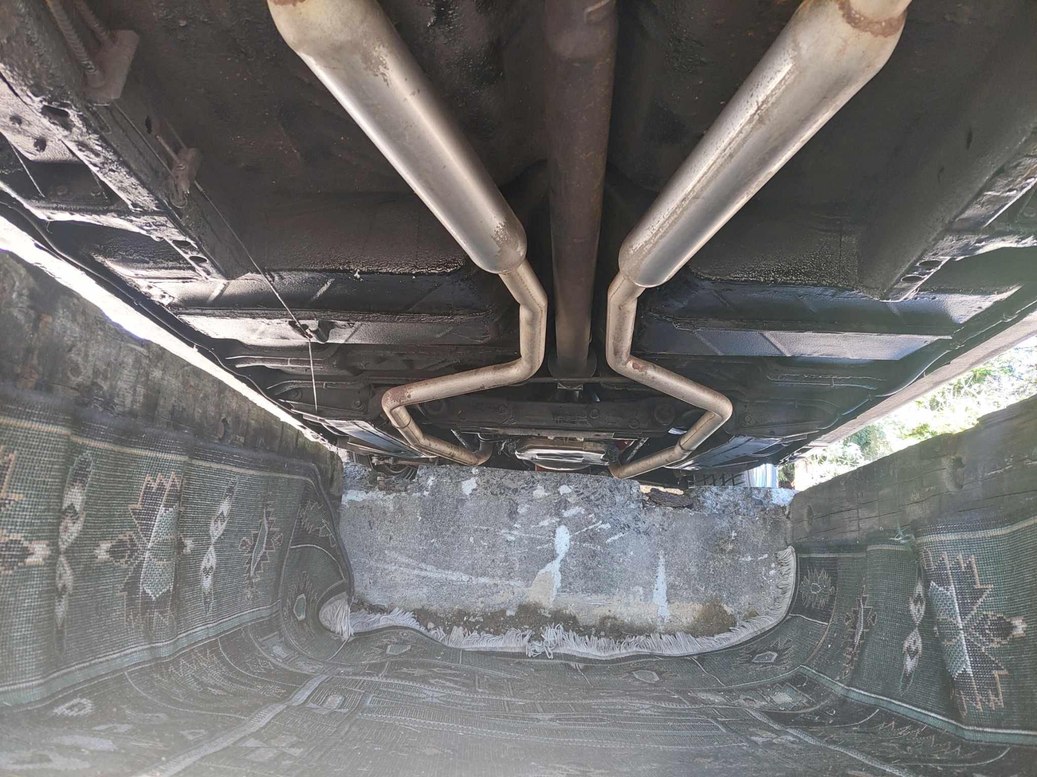

Rustproofed underneath both the old cars with my usual mixture of black oil paint & penetrol. This handy ramp makes it much easier, but still came out looking like a seagull in the aftermath of a shipping incident. Polara's wof has just run out, I think I will leave it shedded until september or so before bothering to get another. Where are our 40+ year long wofs at by joves

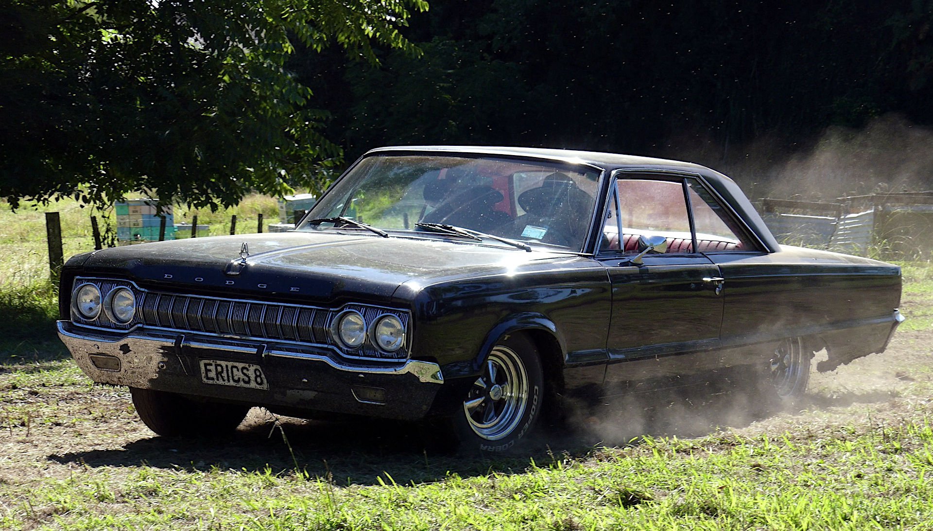

And so there was, a 66 monaco. Different tail-lights extending onto the trunk lid and different grille for 66. The monaco was the up-spec 'fairmont' to the polaras 'series 1 au falcon forte'. Great show, roughly 100 old mopars in attendance, split pretty evenly between aus & yank. I especially appreciated the rainbow array of chargers. Suprisingly there were no ap5 or ap6 valiants or dodge vans in attendance.@Roman came too in order to graph number of antiquated jalopies vs soil hydrocarbon levels.

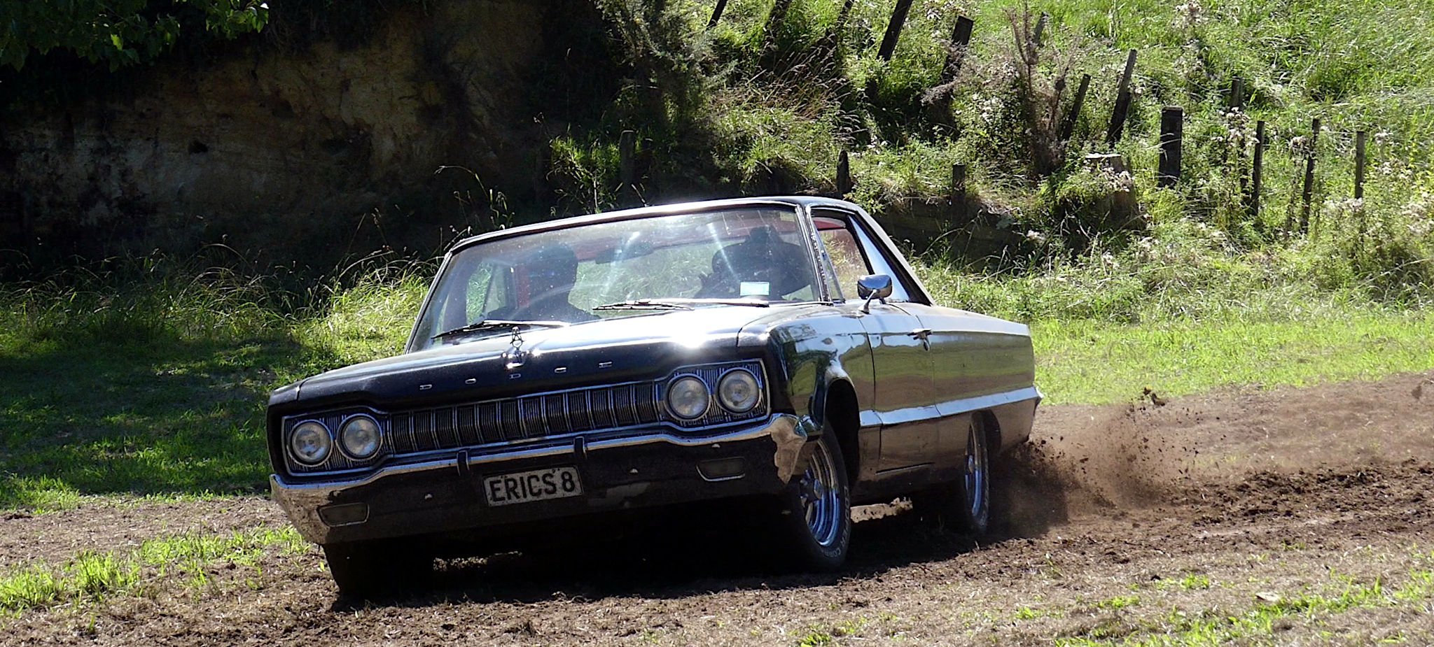

Random car update, no further work has been carried out but I have been using the car a lot. Took it to OSnats which was great fun. I was a bit nervous about descending the kaimai range each way with single circuit drum brakes but it was fine, no drama. Spent quite some time removing all the mud from underneath!

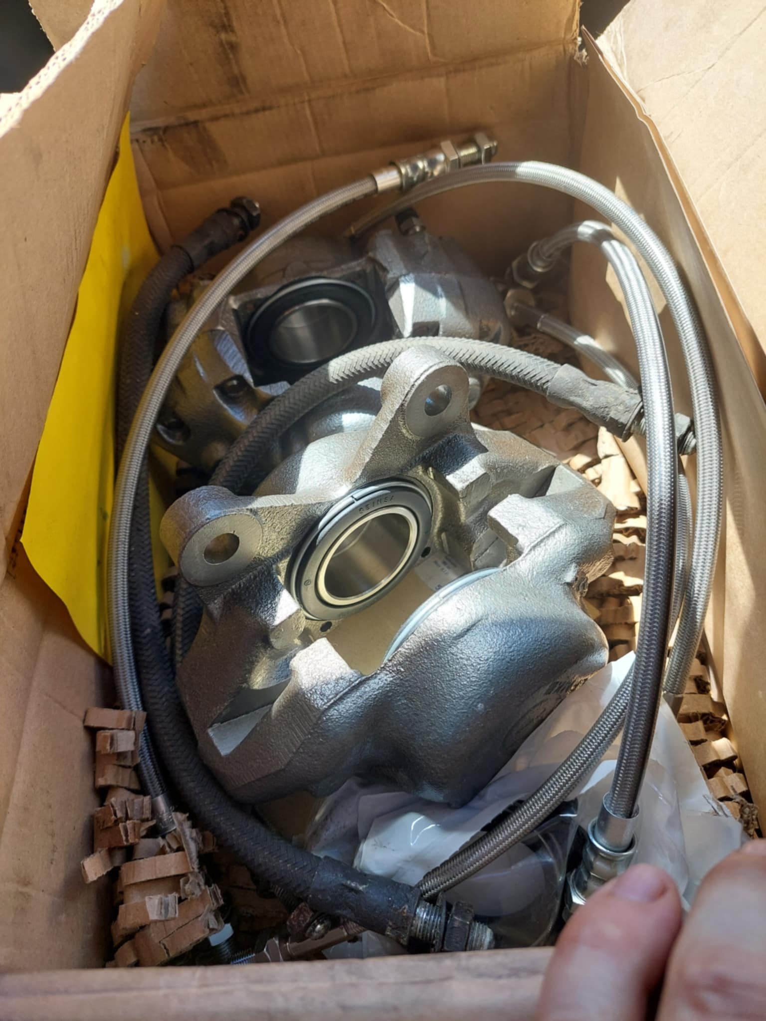

Got the calipers & lines back yesterday, they look great and apex in hamilton were good to deal with. They relined my rear brake shoes way back in the mists of time too. Slapped it all back together, painted and polished the wheels since they were off (and then had to do the back ones too since the fronts looked too much better). Took it out to bed the pads in and the brakes are noticeably better, I wonder how much of that is the stainless flex lines. Washed the dust off and now it is (fingers crossed of course with a leyland product) ready for its wof. It'll have to be week after next due to important railway business, a pity as it would have been handy for nats - will just have to bring the dodge instead (sufferingfromsuccess.jpg)

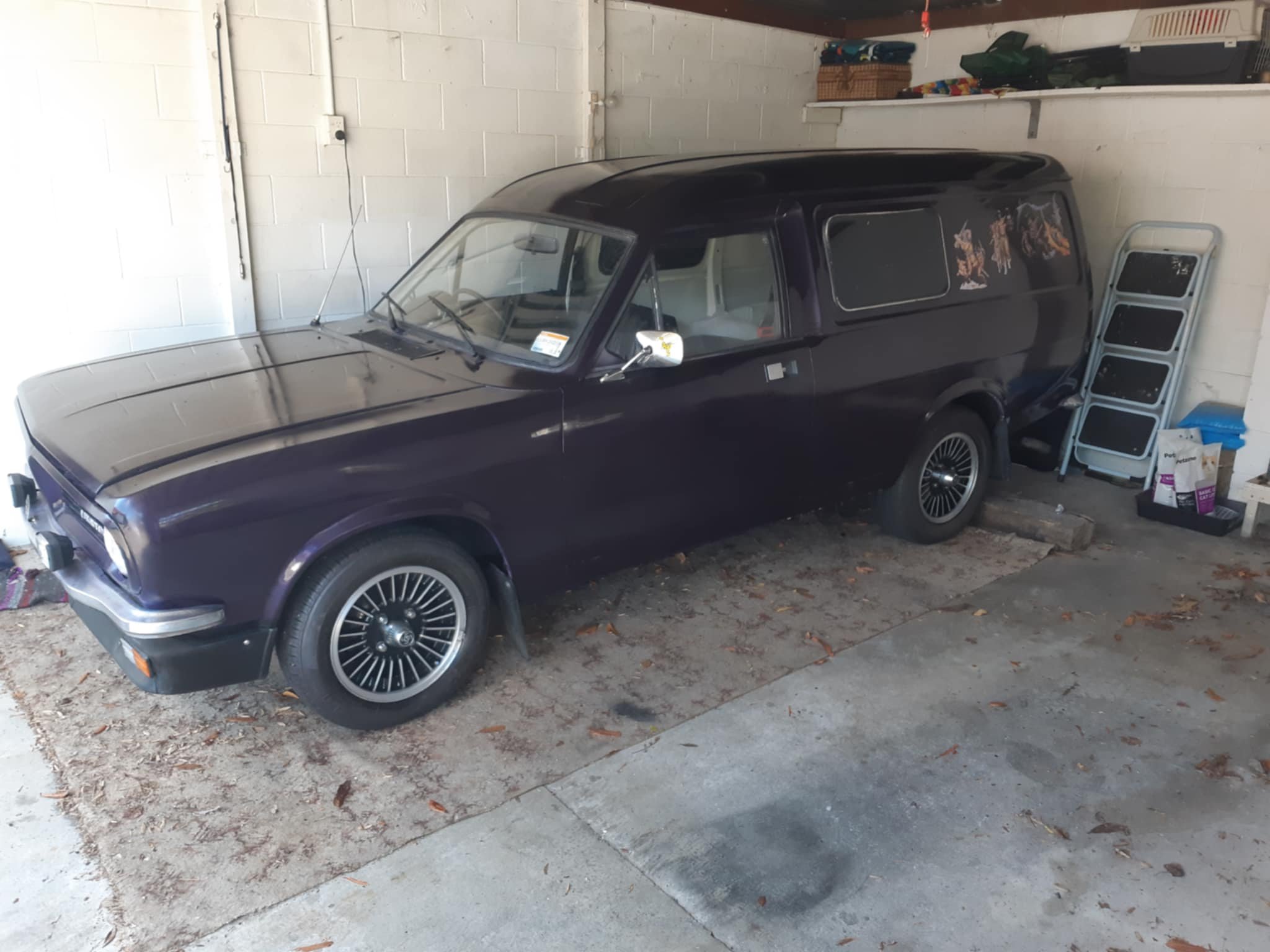

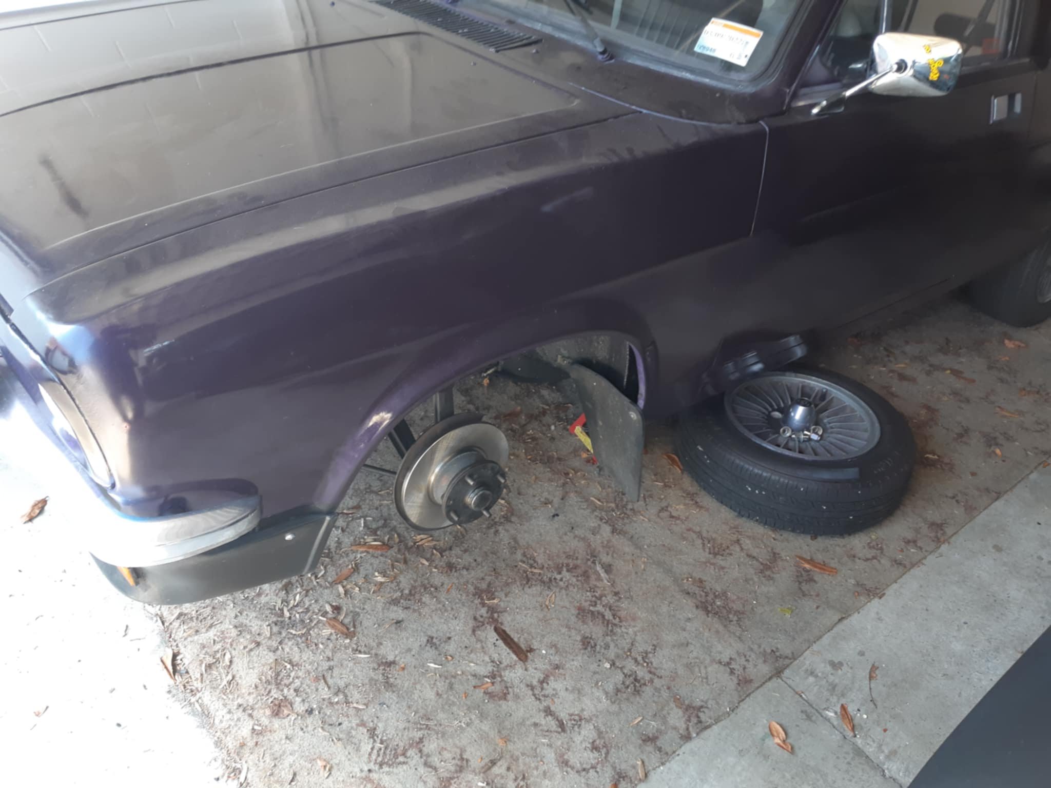

Almost there for a wof with the van. Got a new fuel cap, morris minor are the same as marina van/ute, but not car as far as I can figure out. The drivers side brake caliper was not playing ball so I pulled the calipers off and have sent them to apex to be reconditioned with stainless pistons, flex lines etc. Thought I may as well change the rotors, not in terrible condition but are at least 18 years old. The hub has to come off to change the rotors anyway as they bolt to the rear of the hub, so did the drivers side wheel bearings as the outer race was a bit ugly. Pax side was fine and just got some new grease.
You would scarcely believe it but I have a van update. I had a wof booked today, I was going to take my daily ute in but thought bugger it, i'll take the van in - it needs a good run and i'd rather the ute didn't fall due just before xmas. Didn't fly through but pretty good for a 70s BL product that has been essentially parked up for 6 years. Brake lights weren't working - the switch had died during hibernation. It exploded into shards of mediocre 70s plastic upon removing the wires, I had a spare - 3 whole years newer so swapped that in. They didn't like my radiator blanking cap as gas cap - So I guess i'll find a fancier radiator cap, the filler neck is literally a radiator neck - leyland build efficiency. Only other things were headlight aim and front brake imbalance, they are discs with sliders greased & pads changed maybe last year or the year before with practically zero mileage since - I think they just need a bit of exercise. Should get a sticker early in the new year with any luck
