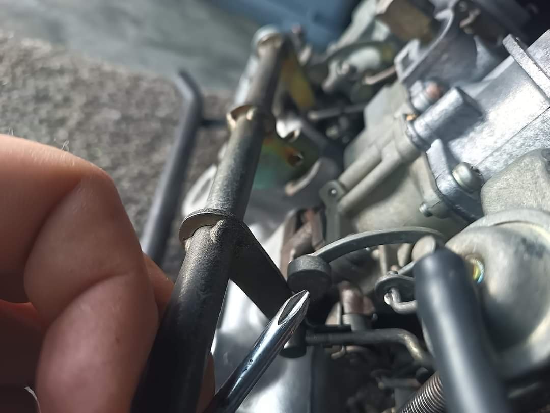

  9. Some abstract art later with a bolt and some spacers welded together and good to go. When closed it has a 2mm deflection on the other lever so I have copied that to the second carb.
  10. Hi All Probably going to need this thread shortly. Just wondering does anybody know what this round end lever/valve does? I have to make my own throttle linkage bracket and just wondering if that arm should be touching it when the throttle is off.
