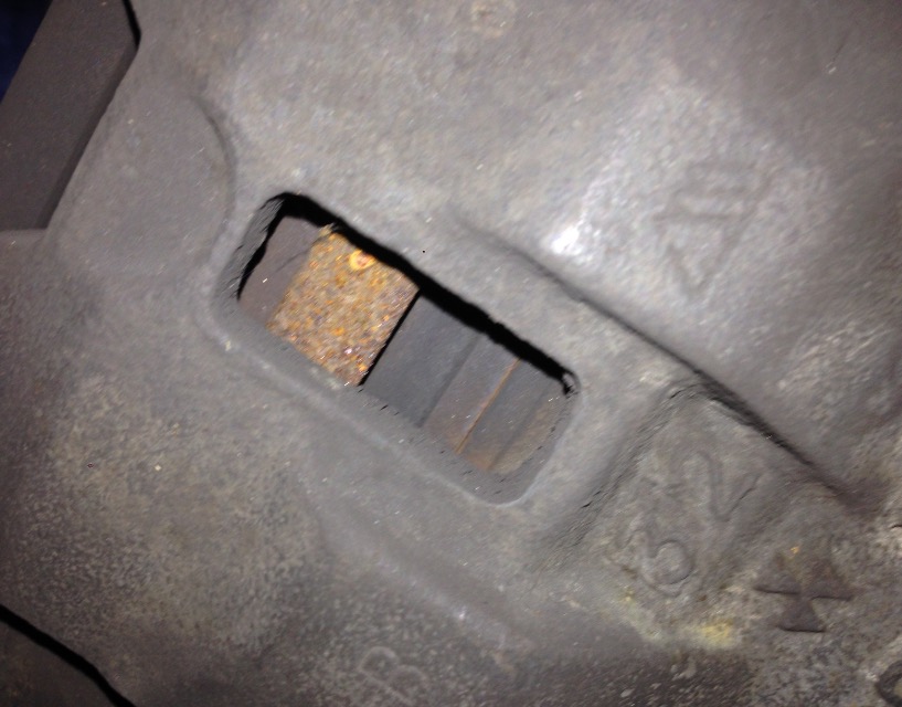

Hey so I've developed a problem with my from drivers side calliper its a Toyota spider style. seems to not disengage properly and is still holding a bit of pressure on the disc. so much so when I remove the wheel and turn the hub by hand I haft to put my elbow into it to turn it. i can hear the pads on the disc when turning. is there a trick to getting it to loosen up or does the calliper need to be removed and serviced? cheers ash looks off more off centre then it is from photo angle

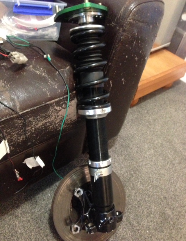

Chopped a bit more out the rear to get it sitting a bit flatter. picked up some 15" ssr meshies off a mate for peanuts sweet cause I can swap the centres over to my flashy 8.5" barrels too had a geez at yota fest at a couple trigger setups. photos from a 3tgte rina and look exactly like what I need. ill use the factory pulley as it's harm balanced etc etc. but for the spacer to sit flat I'll need to lathe the inside surface down and possibly tap the lip off. only needing water pump and alt I might be able to cut the front grooves off as well aaaand I was making coilovers but ended up finding some already made on AA60 stubs so should have those here I couple weeks too -
