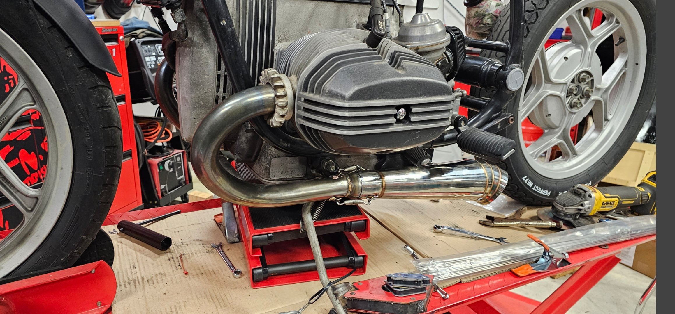

Fuck yeah, best day ever! @Geophy took car of these welds, so much better than I could. Bike started up and I rode it around the driveway out of excitement. Nothing is spanner tight, just loose nuts and bolts held in place by faith...but fuck yeah...fuck yeah!! -

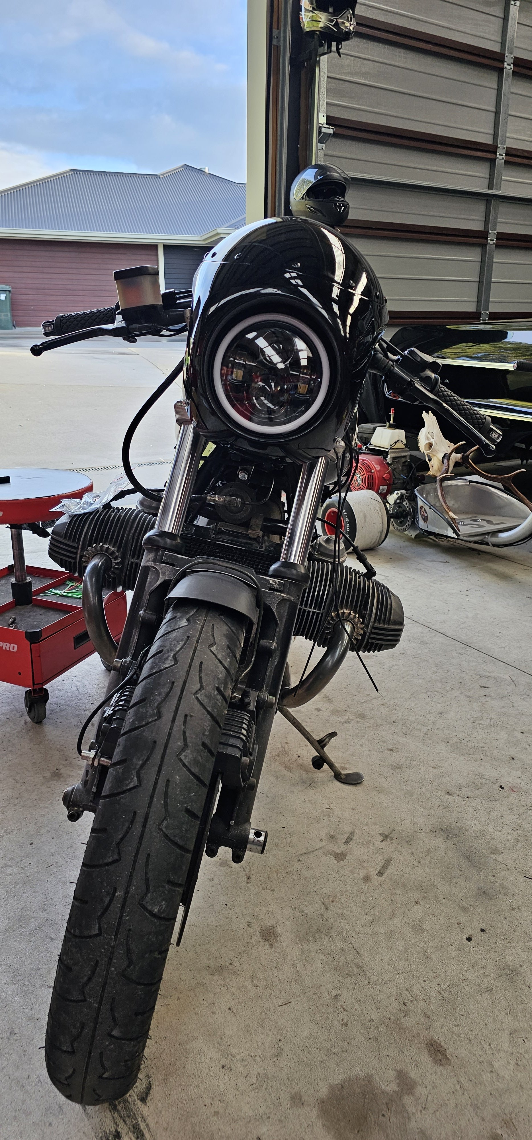

Headlight properly centred in the hole. I made aluminum spacers and finally got it sorted. Such a cunt of a thing that fairing...such a cunt! But fuck it it looks sweet. When it was apart the bike looked so stumpy and just wrong. Im so glad I went through with the fairing idea. -

Front fender mounting all figured out. I rolled a thick bit of panel steel to hide under the fork brace, then bolted the fender to that. Sits nice and tight to the wheel, with about a 10-15mm gap. Its not a part I want to stand out at all, as I personally hate the way all front fenders look on motorcycles, but needs must for legal requirements. -
