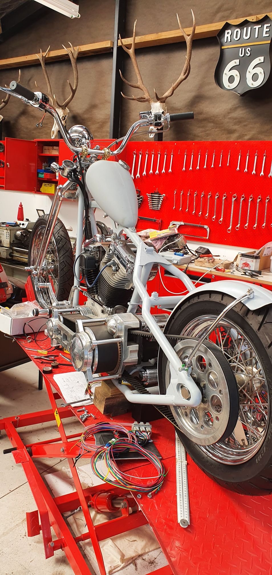

  19. I had to weld a nut to this stud, to extract it like a bad tooth!! Long story, but the engine steady (mount) can't go over 2 studs in a V formation. So I've replaced with 2 cap head bolts.
  20. Unobtainable bolts (technically a screw, as the thread goes full length) ...no choice but to make them: And all set in place with keeper nut
  21. Then I looked at the oil tank. Brand new item...removed caps...full of rust, metal filings, all sorts of crap and corruption inside the tank. I did 5x rinse outs with petrol. Used about 10L of it. I figure $20 of gas is cheaper than 5K on replacing fucked motor. Here's some of the shit that came out. Harleys have a gravity fed oil system. The filter is on the return line as this is under pressure. The fed line is unfiltered, no oil pressure until the pump. So if I started with shit in the oil reservoir it would go through the motor first!!
  22. Life goals - do a little bit everyday if possible during lockdown. And Pretty happy with that. Ticks a box for cert.
  23. More shit done. This remote oil filter has been a total pain in the arse the entire way through this build. Ive never found a great place to put it, plus each time I do, it ends up in the way of something else later on. So I think I've found a new home for it: Brackets getting made Welded Boom!! In position, nicely hidden behind transmission. It unscrews with room to clear the belt, frame, transmission and fender. Any oil should fall straight down (into a waiting catch pan) with nothing in its way. So I think this may be the best place I've tried to date?
