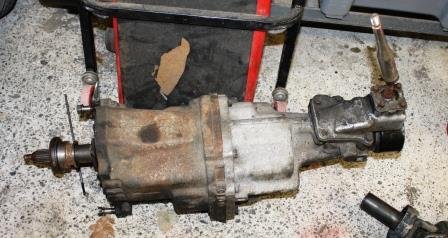

Still stripping rust and painting car parts but have managed to pounce on a few good bargains to feed my compulsive Trademe addiction, (as with the best of my addictions, it’s never satisfied). Found a Steel case W50 5 speed and snapped it up for $150 (Rigamortice will love the extra gear). A quick visit to Zebra parts Manakau found a Triumph 2000 Steering Column for $24, the original one had dry worn out “unobtanium” bearings and was getting a little manky. (For all you “Trumphy” exponents out there Zebra have two cars in stock). Talk about on a roll; picked up a complete HD rear end for $50, (I suspect the old girl has a bent axle and possible bent flange from the accident). (The megaphone gets the occasional “recreational” use with the beautiful Mrs sr2 but its normal application is deadly serious!). (Sometimes playing in a Pink Floyd tribute show has a lot to answer for!). Buy of the month had to be a set of these bad boys. The world’s coolest 14 x 7 old school Cheviot mags that still even have the original centres, all for only $100! Plan is to get Bruger Engineering to give them the once over for alignment, do a little dye penetrant crack testing, (boring safety stuff), do a little media blasting and then apply a lick of matt black Paint. (Very flash stuff and a big step up from rusty old HQ rims for my dear old Rigamortice). The only problem is the cheviot’s are not hubcentric, i.e. they rely solely on the studs for wheel concentricity. Question is; after 20 years of refusing to have non hubcentric wheels near any race car I’ve been responsible for do I swallow my pride, say the rules do not apply to street cars and bolt them on to the old girl? Any opinions will be gratefully accepted and deliberated on by both Rigamortice and myself. (Please feel free to visit and contribute to our project discussion thread- //oldschool.co.nz/index.php?/topic/49843-sr2%E2%80%99s-1947-vauxhall-%E2%80%9Crigamortice%E2%80%9D-discussion-thread/ )

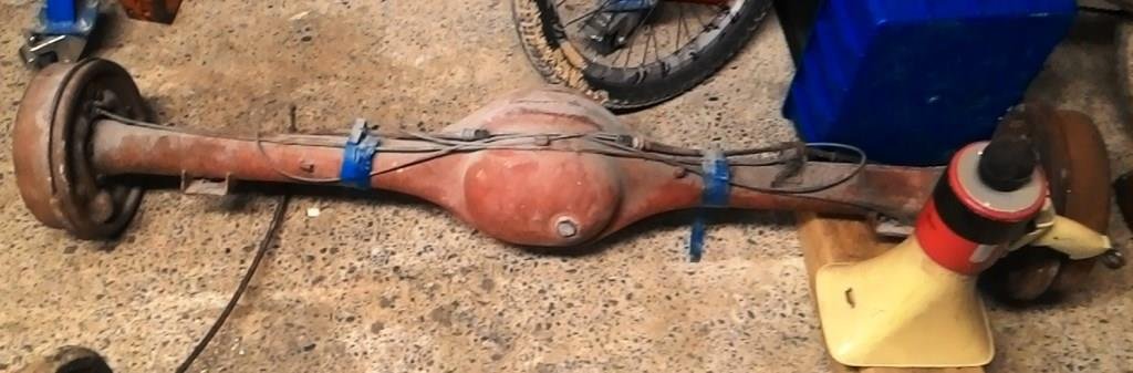

I'd love to get some clarification on this subject. I was talking to Diffs R Us recently and they said they often welded and re-drilled axle flanges and if done properly there should be no certification issues. Enjoying your thread by the way, great fabrication skills and I'm green with envy re your access to a 3 D printer!
