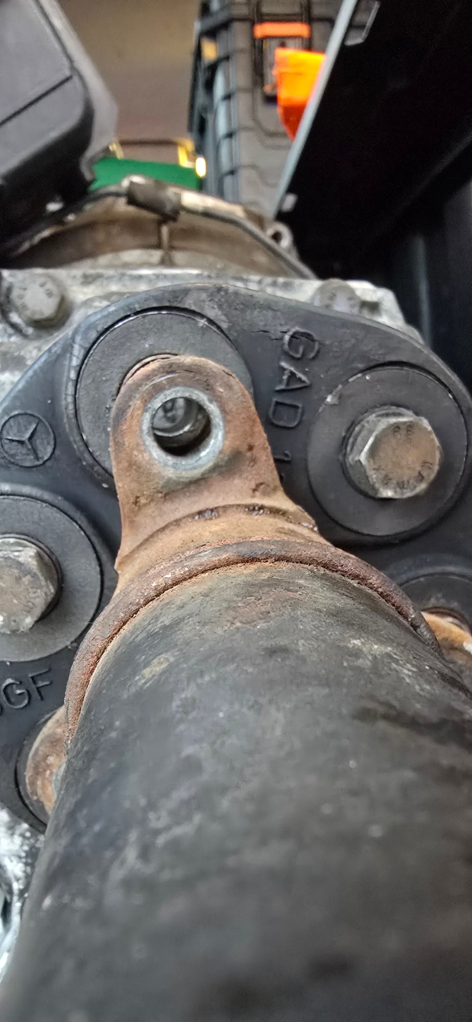

Which $80 part did you mean? The uj? Issue is the manual gearbag flange is different from the auto. (btr vs Mercedes) So it'd be better to go for a two piece shaft with merc triangle and slip joint etc for the diff on the other end made by a recognised industry specialist? Technically need a cert for auto to manual swap anyway 😉
What's the go with Driveshaft adaptor flanges etc? I had a quick look through the construction manual and only saw driveshaft spacers Would something like this be okay? https://www.benzforce.com/products/mercedes-90-100mm-transmission-driveshaft-adapter?srsltid=AfmBOoqloi4WlYsehMEd6kHQtVsoaNVMtH95AAI0gLs2meChwdjSY3s6 Stock trans has guibo and locating shaft Would be nice to ditch the guibo and have this style uni and slip joint shaft in its place bolted to a adapter on the back of the gearbag

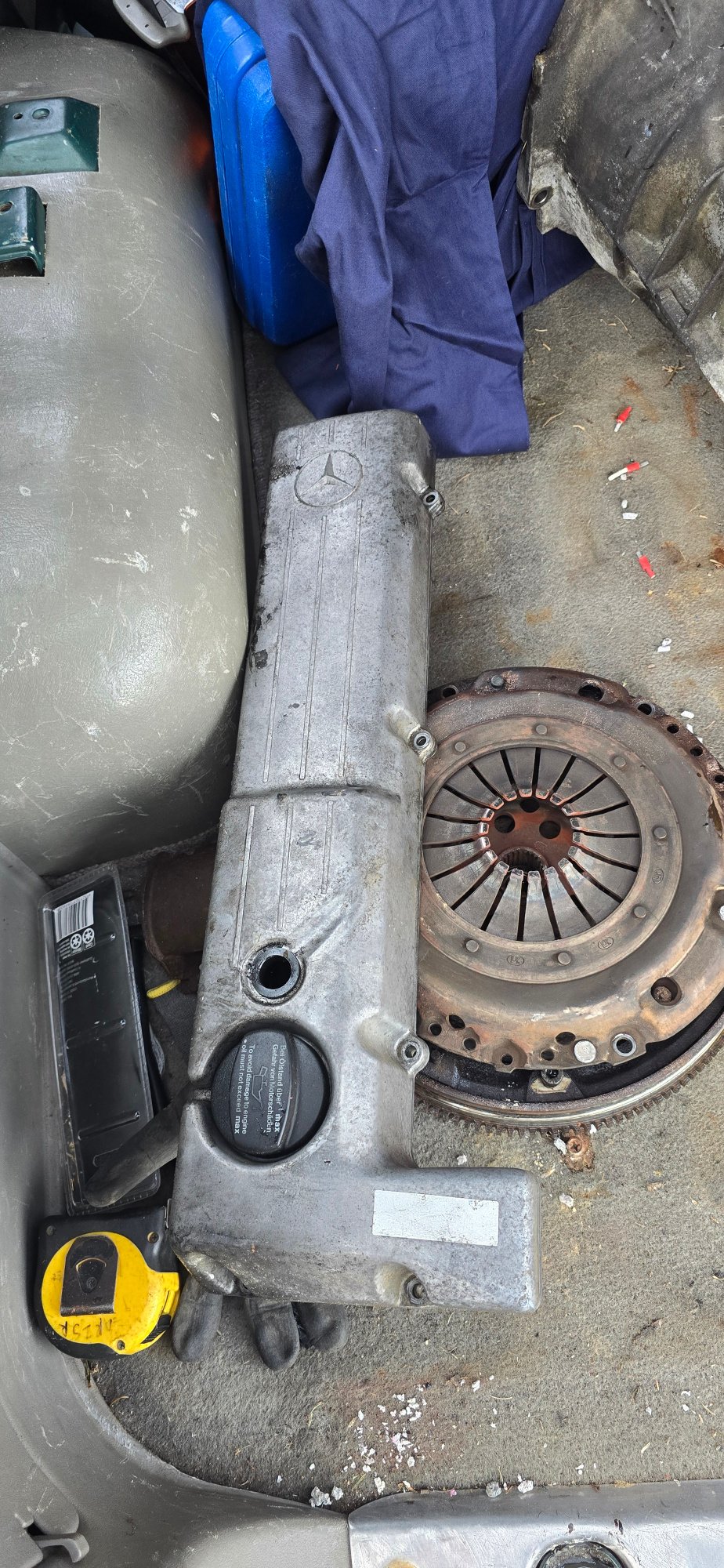

Now I can get wot and actually have the throttle return so that's nice. Seeing as the fan clutch and thermostat are om606 parts I figured I'd get more om606 stuff to match. The tremec fell through so I went for a 5 speed and flywheel out of a w210 Oh and a om602 rocker cover to confuse the barries Yes the 717.xx 5 speeds aren't as strong as the 6 speed boxes but if I double the 662 power it's just above a stock om606 so it'll be fine Spent a couple of hours a pick a part puddle getting a driveshaft out thinking they it was going to work as a doner but the hole centers are different between the earlier and later shafts The auto box must not have liked the extra 1.5 turns worth of power as it'll randomly decide it doesn't like 4th and bang into 3rd when doing 100 Another fun fact is the w210 gearbag does not have a speedo sensor or any provision for one as it uses the abs sensors for the speedo so It looks like I'm going to have to mount a hall sensor and find someone smarter than me to write a arduino code to convert the hall signal to a pwm -

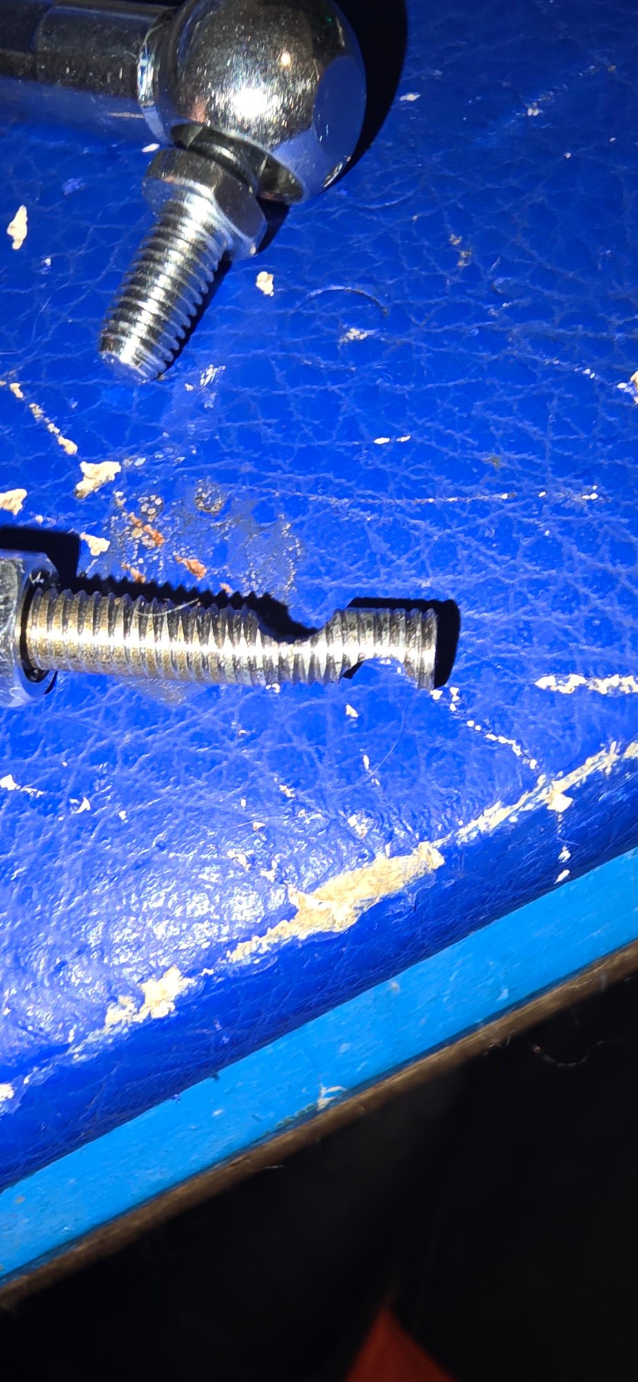

I'd hoped the m5. Alix rod ends would have the same size ball as Mercedes /ssangyong but no Ran a die down the shaft And installed it Turns out the locknut hit the injector line so I backed it off -

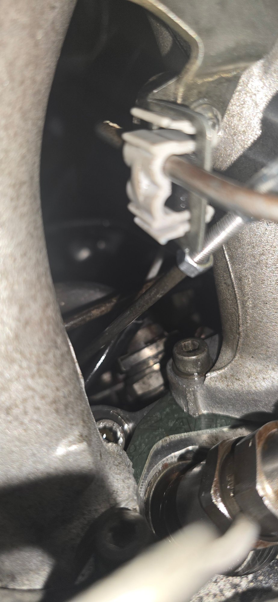

Number one cyl got treated to new lifters as I only bought two. Trying to remember the sequence of the 22 head bolts was fun. The two plus 90 deg turns was a bit puckering but went well. Chucked some assembly lube on everything Cam caps on and torqued to spec Turned it over by hand a few times and it even stayed timed correctly Got carried away reassembling stuff and nearly forgot the exhaust gasket I attempted to replace the thermostat but got the wrong one. Looks like the musso has a om606 thermostat and fan clutch. Chucked the original one back in for now. Annoyingly I broke the throttle shaft so will need to figure that out -

It's fixed. Well the intake side is I checked the exhaust side and No3 has decided it wants to leak Gave No3 exh a quick lap and it's fixed Head just fell on which was nice Now to battle the pins for the timing chain and hope I don't drop the two m6 bolts for the front of the head down the front of the motor -
