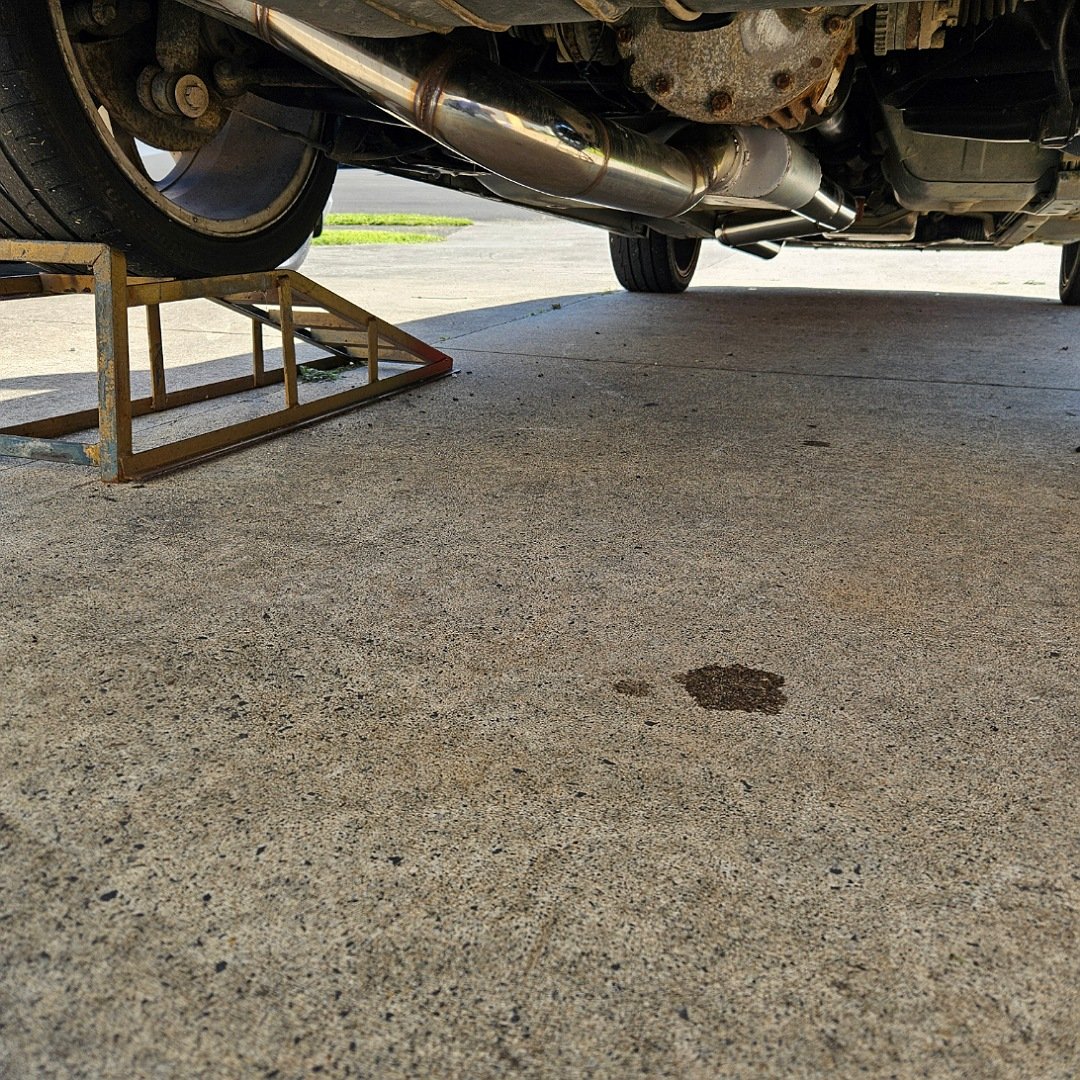

Have driven this around for about an hour few rattles from exhaust needs lots more mounts who knew 3.5" exhausts were really heavy, go figure.... easy fix though it's quiet enough wastegate has a bark to it. Appears PCV system will need an upgrade its struggling a bit few more oil leaks than normal. Catch can incoming. 2000rpm idle is a bit annoying either I have a vacuum leak or a dead IAC valve, trying a new IAC as current isn't right it's gm but never has been 100% so bought the expensive commodore specific one. If it's a vacuum leak that might be trickier. All in all no check engine lights gets up and boogies seems pretty happy has lightest wastegate spring I have so should be about 4psi. Time to figure out wideband and do road tuning once the niggles are done. Think the stock bumper is perfect BTW.- 741 replies

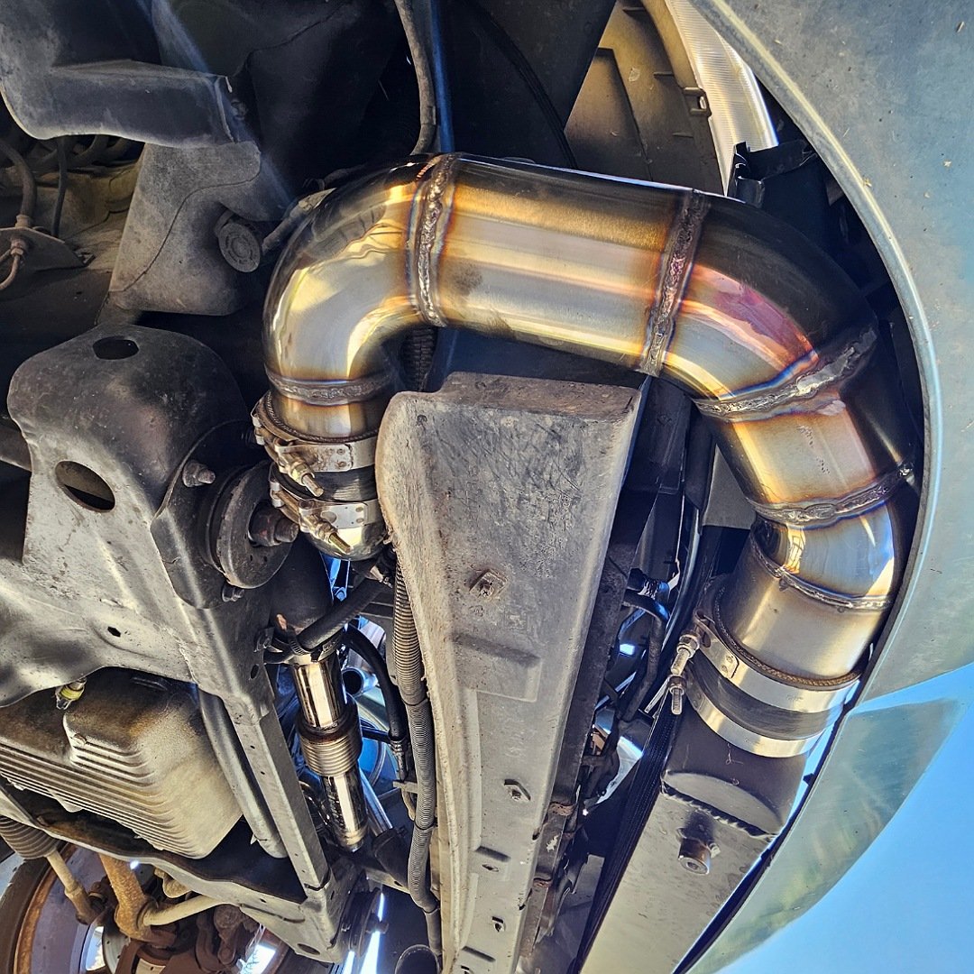

Had some plumbing to do under car first one was hooking back up exhaust. Which is done not 100% happy but fully functional though I migged it as currently it's one piece front to back was to hard to do with tig. Will order a few more v bands and a flexi make it 3 pieces.- 741 replies

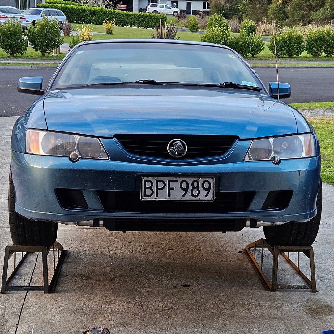

Epic day on this! It's back together finally just fettling now it's a running driving car. Front bumper back on kind of a sleeper kind of isn't.- 741 replies

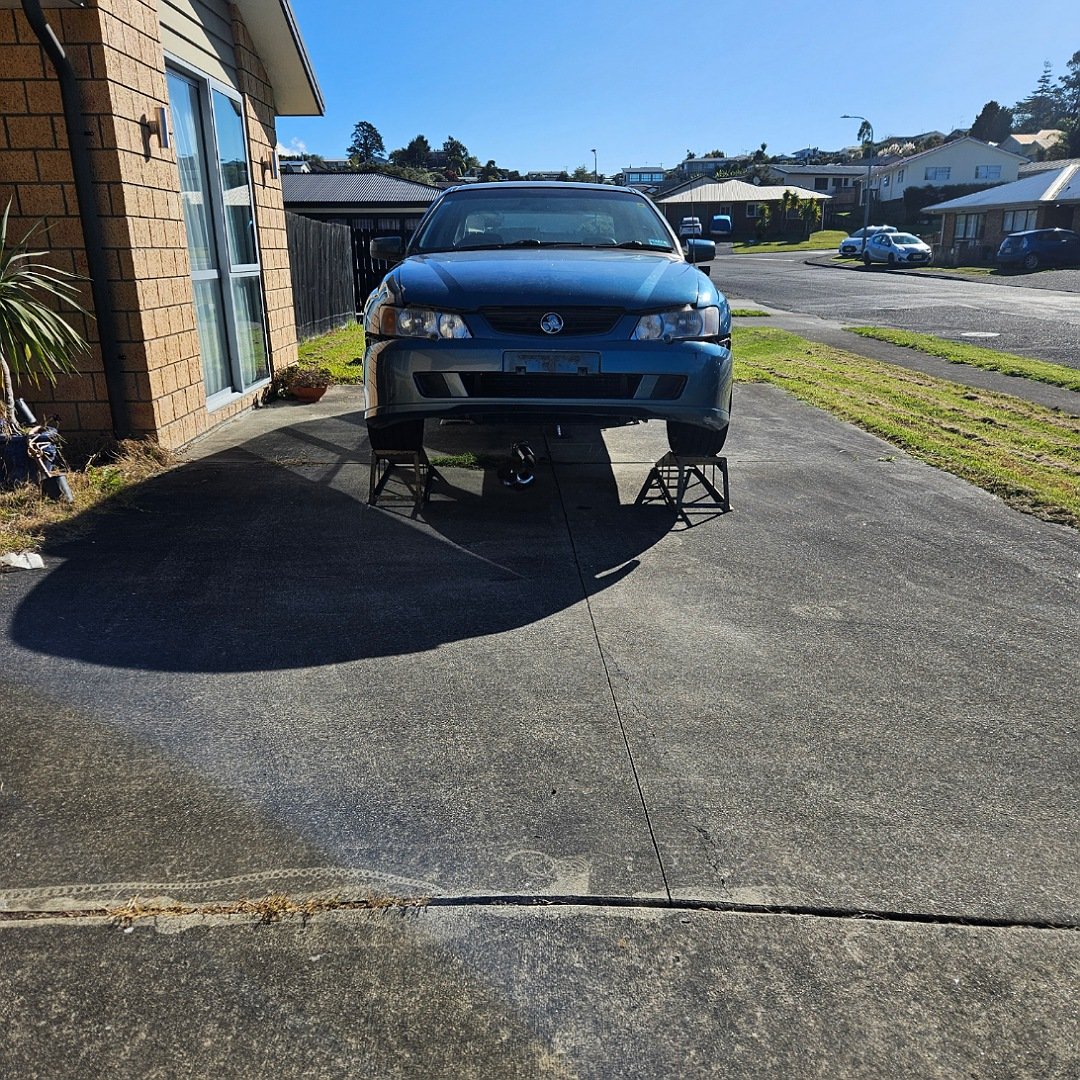

To finish up the intercooler pipework I need to cut the inner guard theres no where else to bring it through nicely. There is already 3 large factory holes so will just cut between those will leave a good size opening. Makes for a piss easy path for pipe.- 741 replies

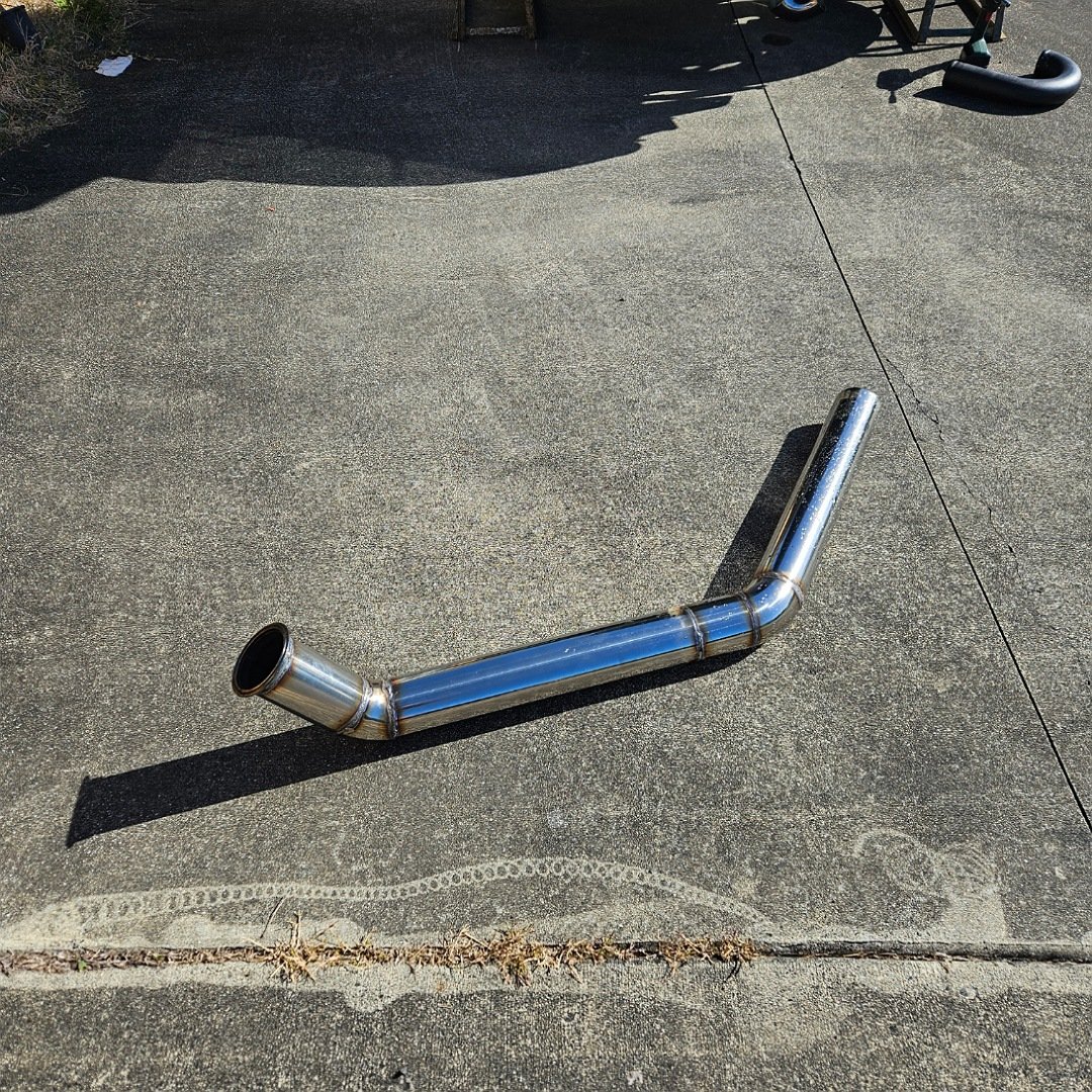

Exhaust chopped back to just behind the trans pipe off turbo has had a few more kinks put in it to worm down past steering rack and is in a good spot to build off now. Going to focus on Exhaust hooking that all back up before passengers side intercooler pipe as its a bit loud and I'm waiting on some silicone parts to finish intercooler stuff.- 741 replies

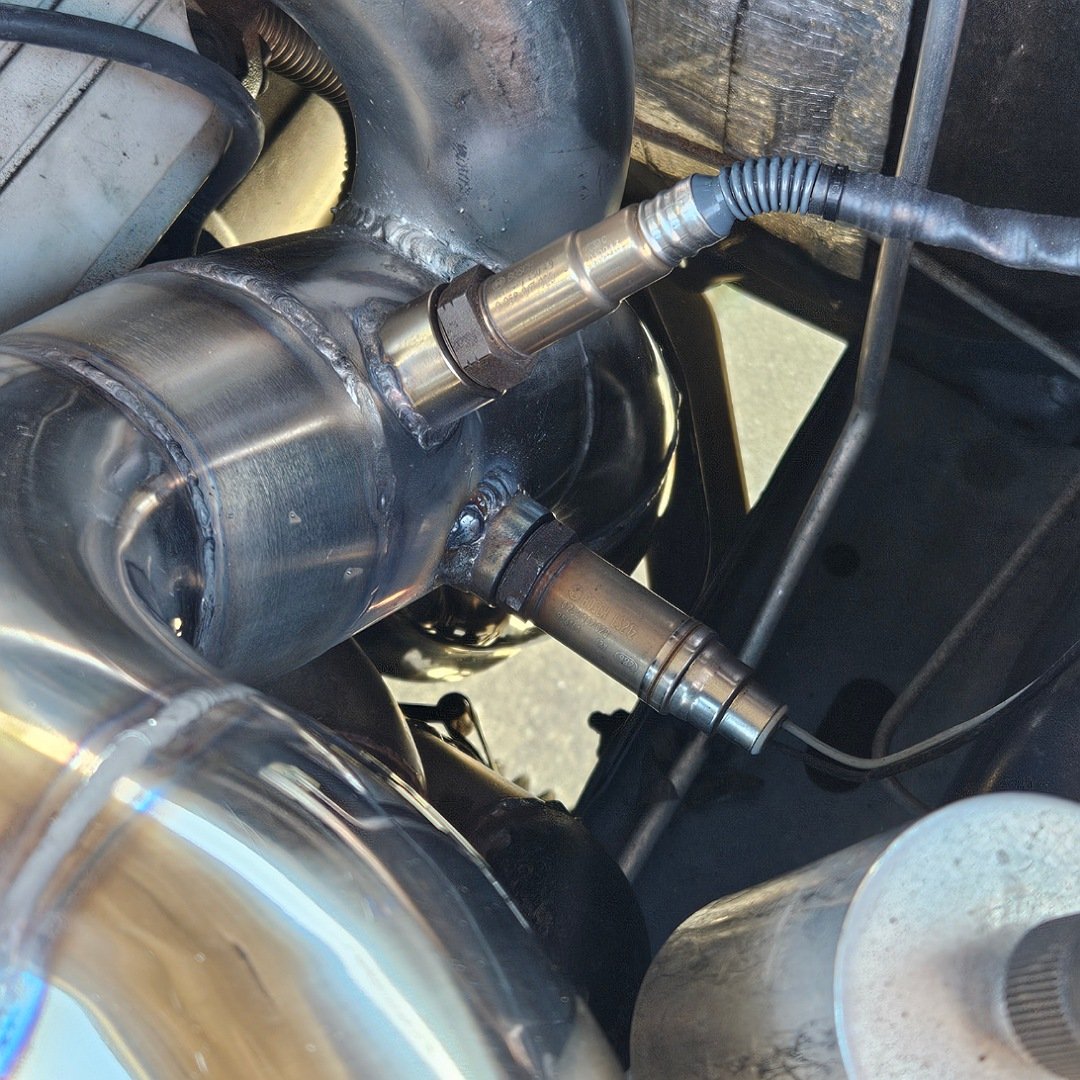

Fitted a Narrow band o2 sensor to keep the ecu happy and see if once up to temp it would trim back the A/F ratio on its own. Short answer was yes it will but not far enough, so pulled more fuel from tune and it now idles at 14.7:1 Close enough. Cold start tables are so far off its not funny its so rich it struggles to run pulled more fuel there slightly better. Once it kicks over it runs mint and is pretty snappy. Have had it up to temp and been for a quick drive turbo is loud and spins up at about 2400rpm.- 741 replies
