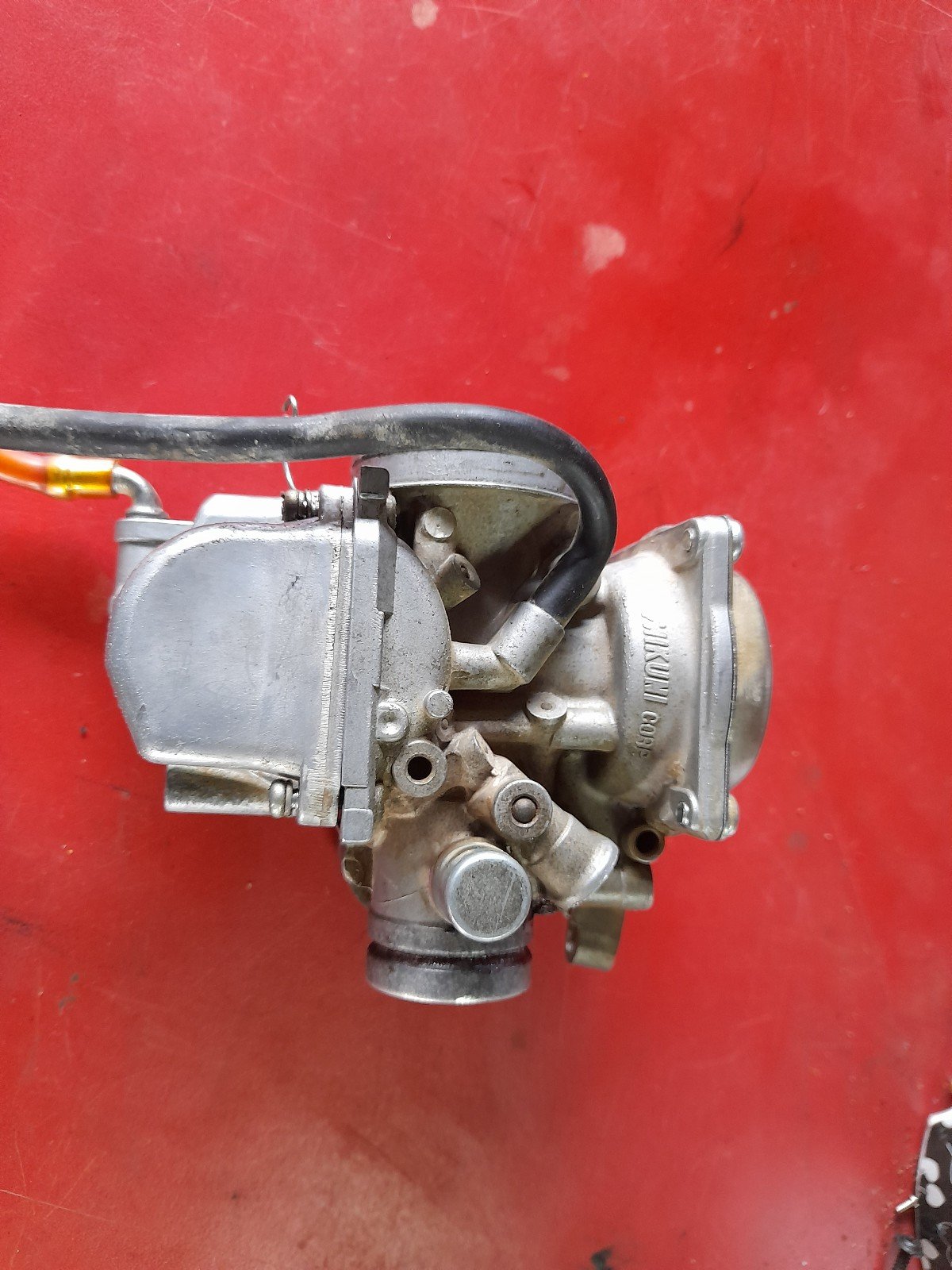

New manifold, choke cable (was siezed), and a diaphragm for the carby was the initial idea along with obviously cleaning the years of shit out of the carb.
There is a rubber bung that plugs the pilot jet tube that was perished but not available locally so i put it back in and reassembled the rest.
Took the tank off and gave it a rinse out too. So of course after that the fuel tap leaked out its base. New gasket in there and no more wasting the liquid gold.
Started on 3rd or 4th kick so not bad. Still wouldn't rev out, smelled and sounded like it was flooding itself. Brought it home to have another look over the weekend.
Float height is good, jets and ports are clean. Hmmm pulled the pilot jet out again to check the oring at its base. Not looking too flash, so pulled a box of dhla spares off the shelf and found a suitable replacement.
Had another look at the rubber pilot plug. If it wasn't sealing properly then nothing will work right. No fuelproof rubber in the shed so came up with a different solution.
Cut a thread inside the tube and cut down a countersunk machine screw to plug it up.
