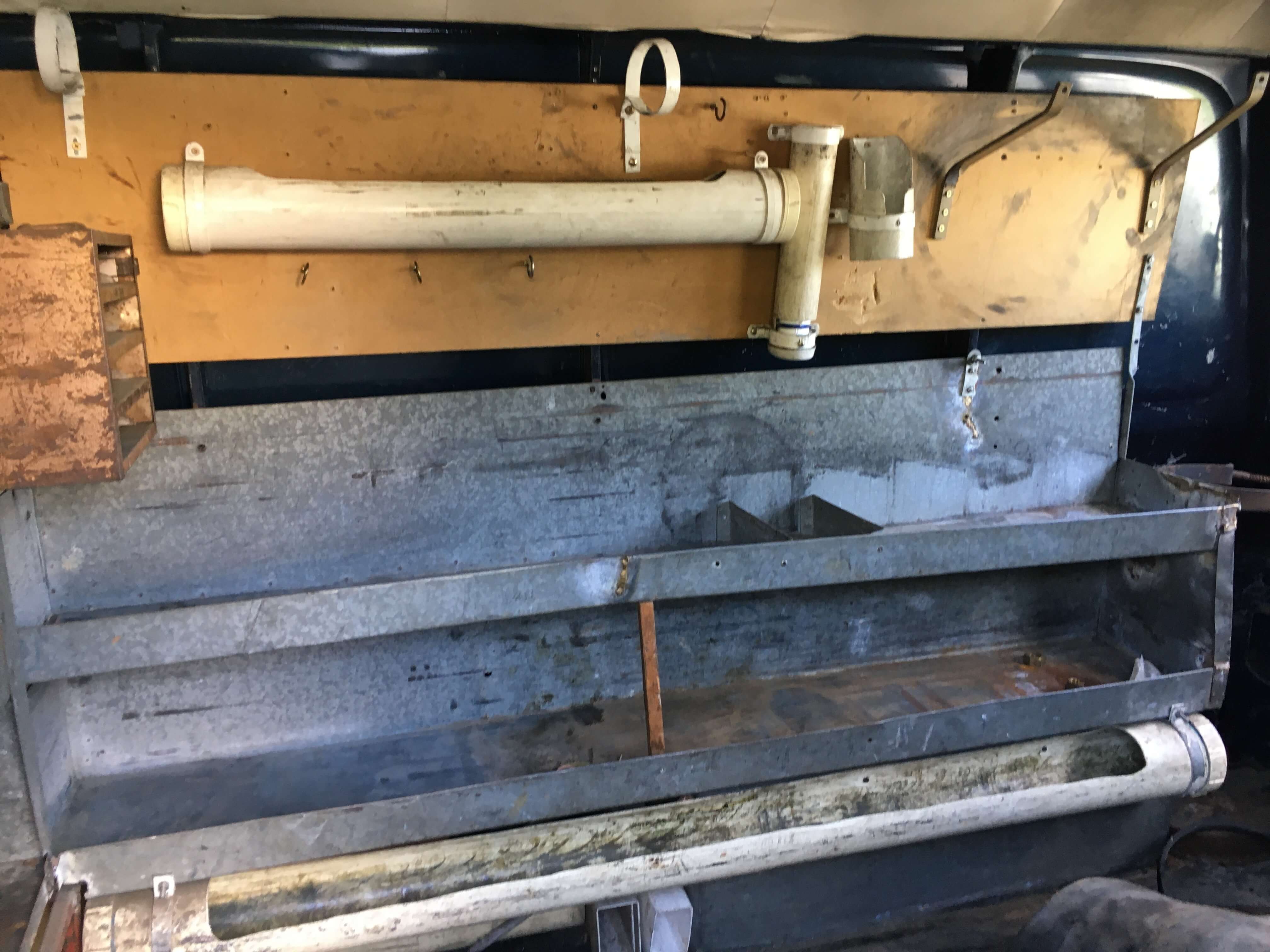

browndog Posted July 7, 2021 Author Posted July 7, 2021 So fast forward to early February, and discounting the various other hiccups in between, the mighty van was finally delivered to my place! Turns out it was an ex plumbers van, and even came with all of his old stuff still in it. I googled his name, and found he had died in July 1979, aged 81. The van had probably been sold by an executor of his estate or similar. So it had been used as a work van, and was fairly beaten up in the back. But as with most Aussie vehicles I have bought, rust was fairly minimal for something of this age. First job was to remove all of the shelving and other crap with had been Tek screwed/rivetted/welded in! 8 Quote
Popular Post browndog Posted July 8, 2021 Author Popular Post Posted July 8, 2021 So I gave it a good cleanout, removed all of the old shelving etc. I gave it a machine polish, as it was very dull, and I wanted to see what the finished product would look like. It had probably never been polished in 40 years, lots of blue coming off on the mop! 18 Quote

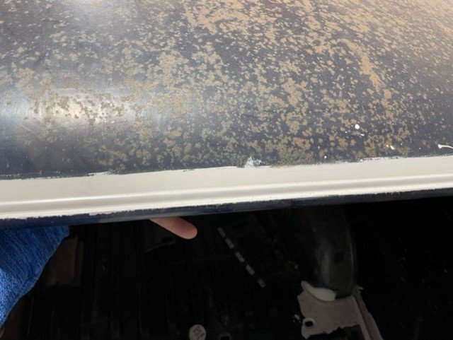

browndog Posted July 26, 2021 Author Posted July 26, 2021 Went to panel guy's place this morning to drop some parts off, and check on progress. This guy just amazes me every time with his sheetmetal skills! Door steps had some rust holes in them, so he fabbed up new ones, complete with correct swaging. Check out the detail, once painted it will be impossible to tell from original. Same goes for the chassis section which carries the LH rear spring shackle. Compare to the pic above, perfection! It is quite nice going up there and seeing progress. 7 Quote

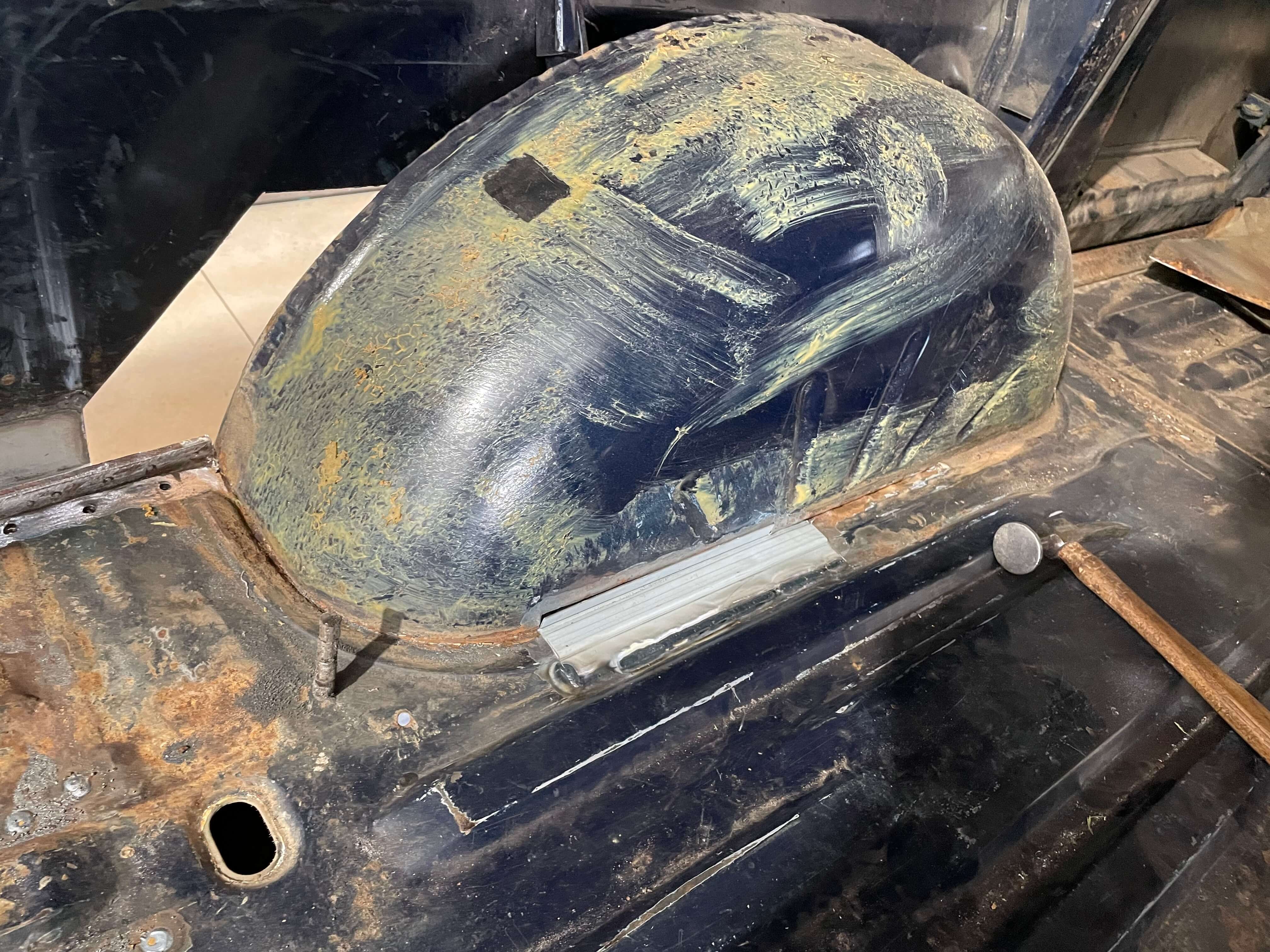

Popular Post browndog Posted August 17, 2021 Author Popular Post Posted August 17, 2021 A small update. Left rear wheelarch repair panel welded in, and lower rear inner panel repaired and welded back in. There is a small triangle panel which I was waiting for which is the lower inner arch, now the this has arrived my guy can weld it in, as well as the lower outer rear quarters, as well as the rear valance. Super happy with the quality of the job so far, it is really nice when you find someone who does this level of work 15 1 Quote
