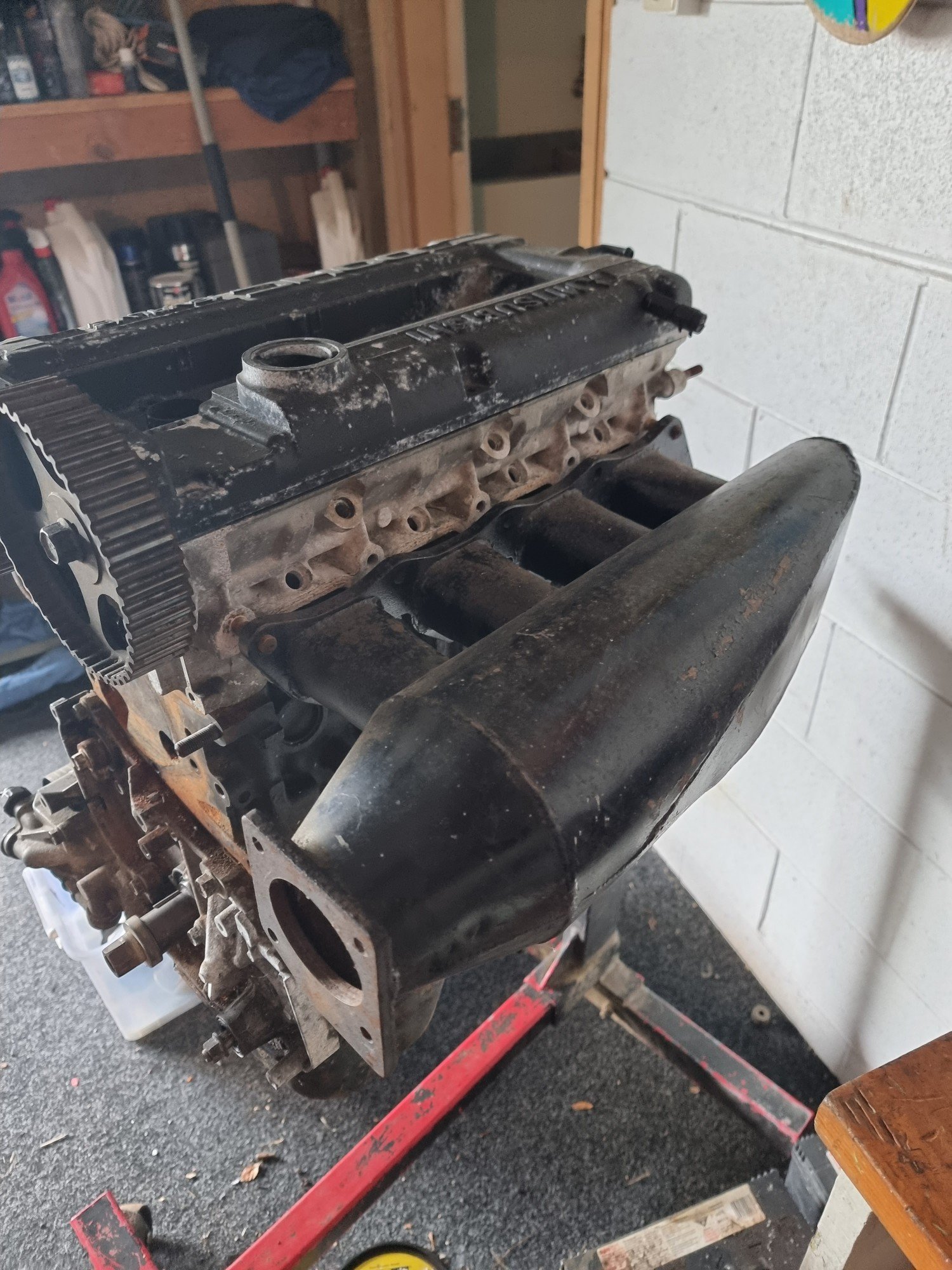

Stumbled upon this haul of parts today on Facebook. Dude was local and had a good yarn with him.
Potentially may have more parts for me to purchase once he empties his storage unit.
Got a 1600 crossmember,  some suspension parts, there was also new tierods, castor bushes, pitman arm etc (not in pics) and these sweet manifolds. They're a little cuzzy custom spec but will still function no doubt.
Will install/swap the crossmember when I get a chance as the one In the car has been redrilled for wider wheel track but Im not too impressed with it.
