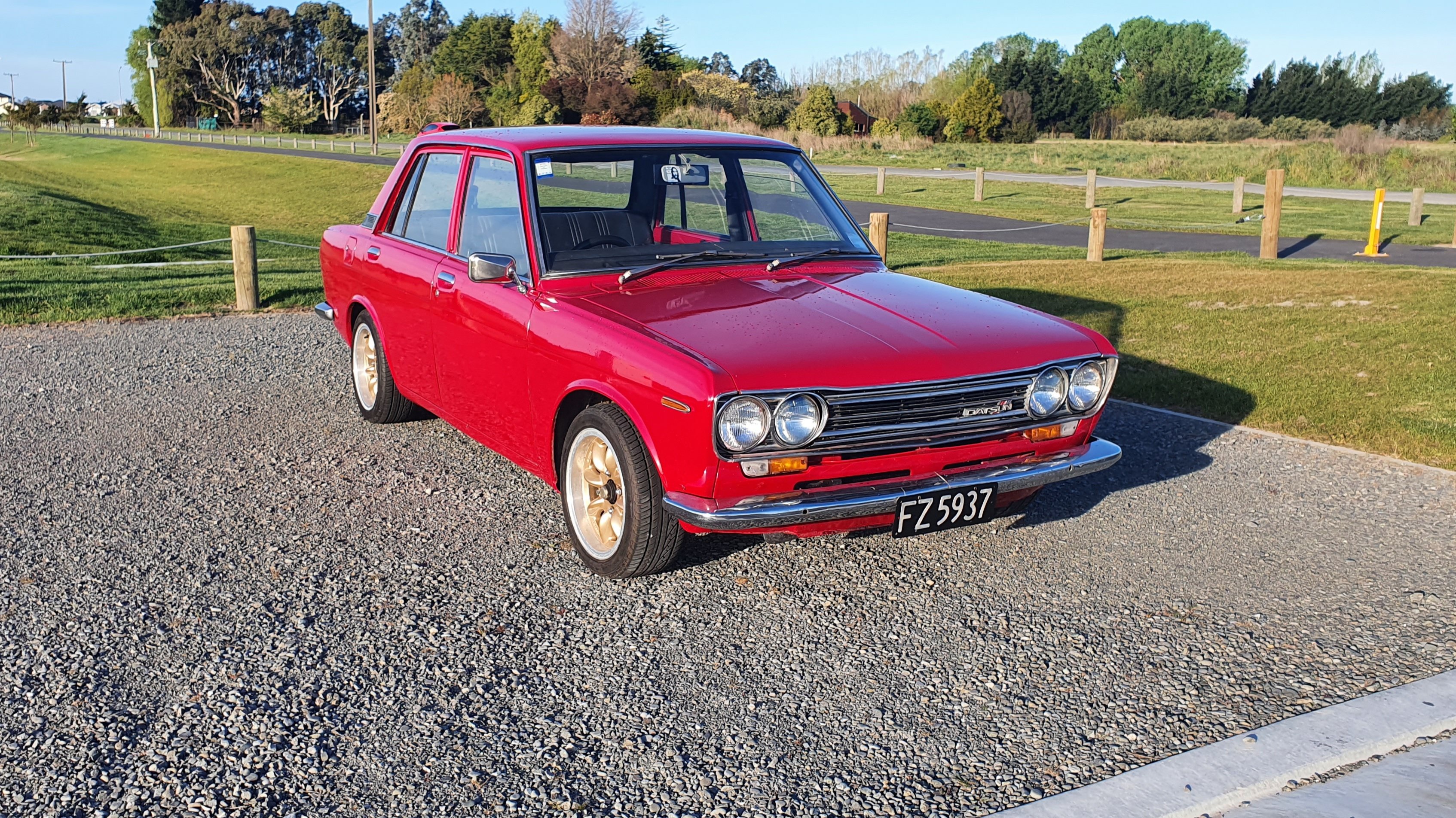

Popular Post Cullen Posted July 27, 2020 Popular Post Posted July 27, 2020 Covid. Ruiner of adventures. In this case a trip to Europe. As this year is a write off I had some walking around money wanting to be spent. I happened to come across Bart and the previous owner early last week and he showed me a picture of a datsun that had been sitting around for a few years and needed to be moved on. You don't need to hear my life story so let's just cut to it. It had been off the road for a number of years - last wof passed in 2015. It has a CA18DE and 5 speed. R180 diff, S110 disc brakes and height adjustable front suspension and uprated shocks and springs etc Certed way back in 2005 for the mods which is sweet. As it stands it will idle but die when under load so is not drivable. Shouldn't be much to sort out. Only a couple of photos shot so far. Plans are to give it a bit of a tidy and just hoon it round. Should be fairly reliable. 43 1 Quote

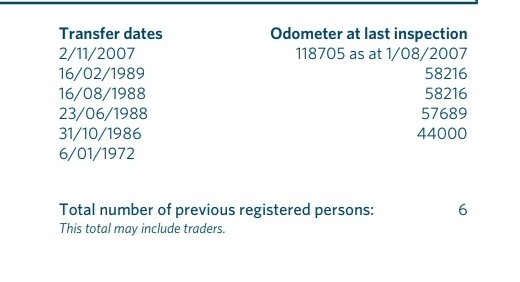

Cullen Posted July 29, 2020 Author Posted July 29, 2020 This was surprising. Low ownership numbers and it looks like the guy who built it owned it for a long time. 7 Quote
