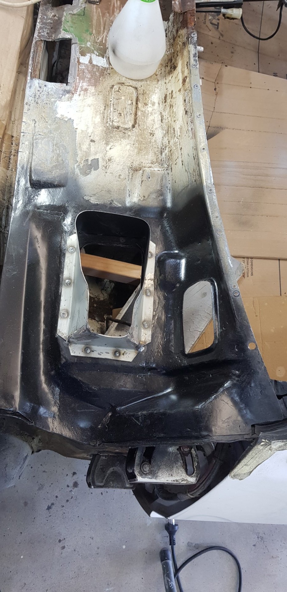

gibbon Posted July 12, 2020 Author Posted July 12, 2020 The green and silver rust converter earnestly applied by someone down the line was reminiscent of band-aids on a terminal cancer patient. Turns out after all the love and attention the car received back when I knew it, it'd somehow ended up parked under a tree for a few years which basically rooted it Inside of one of the guards. Both were completely blown out at the bottom. Someone had cut the top of the firewall out to assess the rot beneath the scuttle, it'd punched through in about half a dozen places This was rapidly getting beyond my mediocre ability to fix. Workmate knew a panelbeater who worked from home and offered decent prices. I tee'd a time for him to come and have a look, then lockdown hit. So I stared at this rotten old thing for a month or two. Actually I did a bit more than that, fixed the brakes up, and pulled the turbo to bits for fun But first some more corrosion gore 5 Quote
gibbon Posted July 12, 2020 Author Posted July 12, 2020 I pulled the dashboard and wiring looms to get them out of the way, had a bit of a panic here as I thought the floor had been dodgily repaired with fibreglass, but on second inspection it's clutch fluid leaking from the blown master eating up the dynamat. Here's where the water has rotted through the scuttle, through the upper firewall, and is running down to the bottom of the A pillar, to rot out the sill and onto the floor. Door hinge attach points are mercifully solid. But it's the reason all the wiring had to come out. LHS was marginally better so the (extremely rare) ECU hadn't gotten wet at least Lockdown was dragging on so I started to peel the scuttle back, to just find rotten shit everywhere. Had a look around for donor vehicles (good luck) 4 Quote
