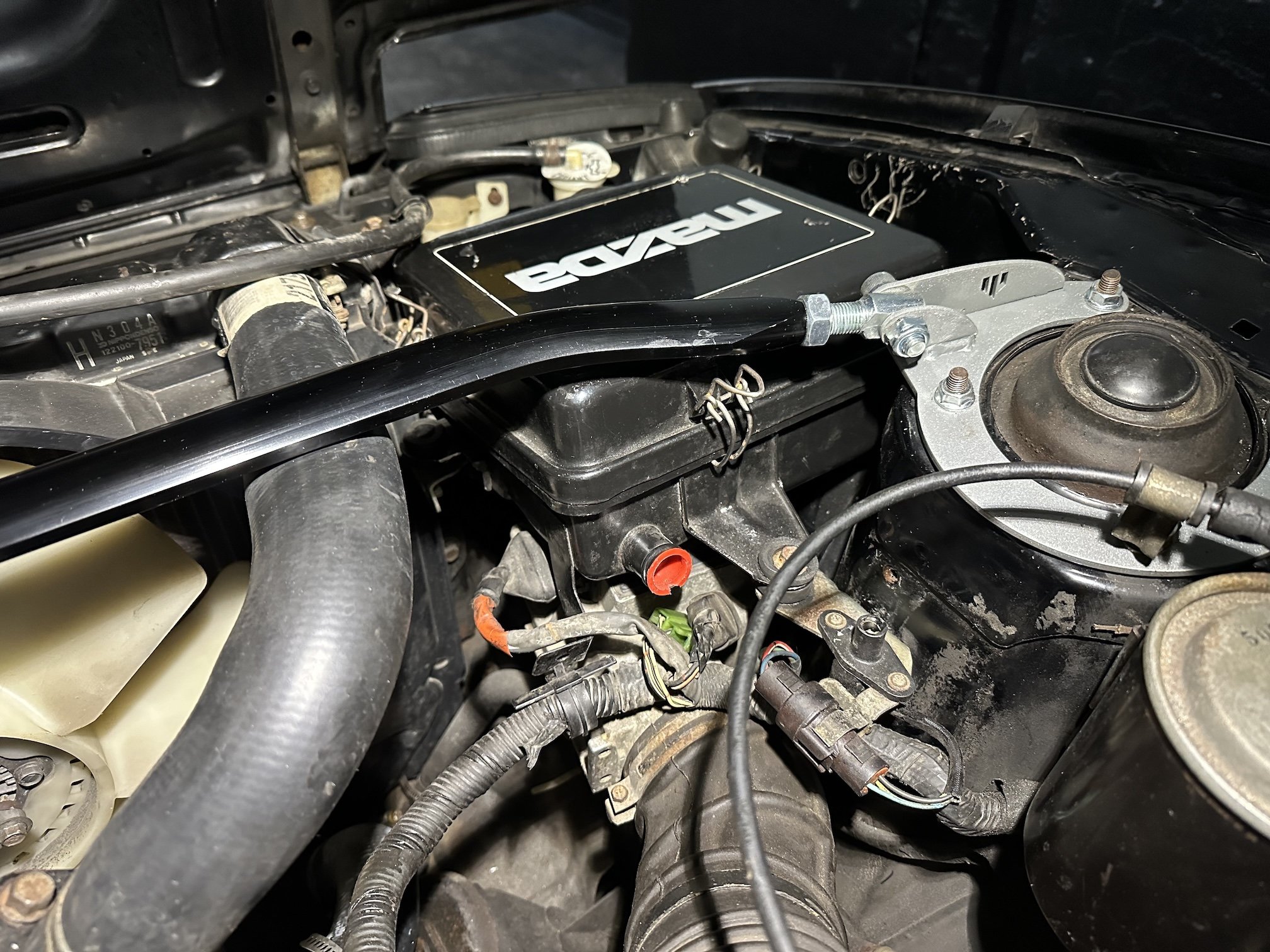

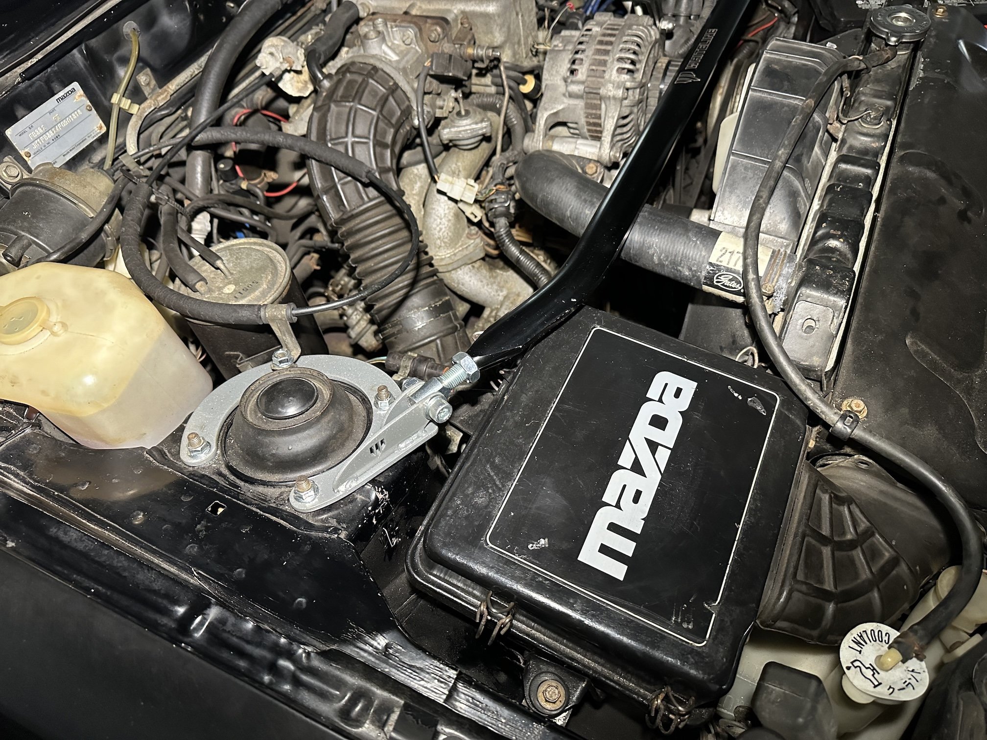

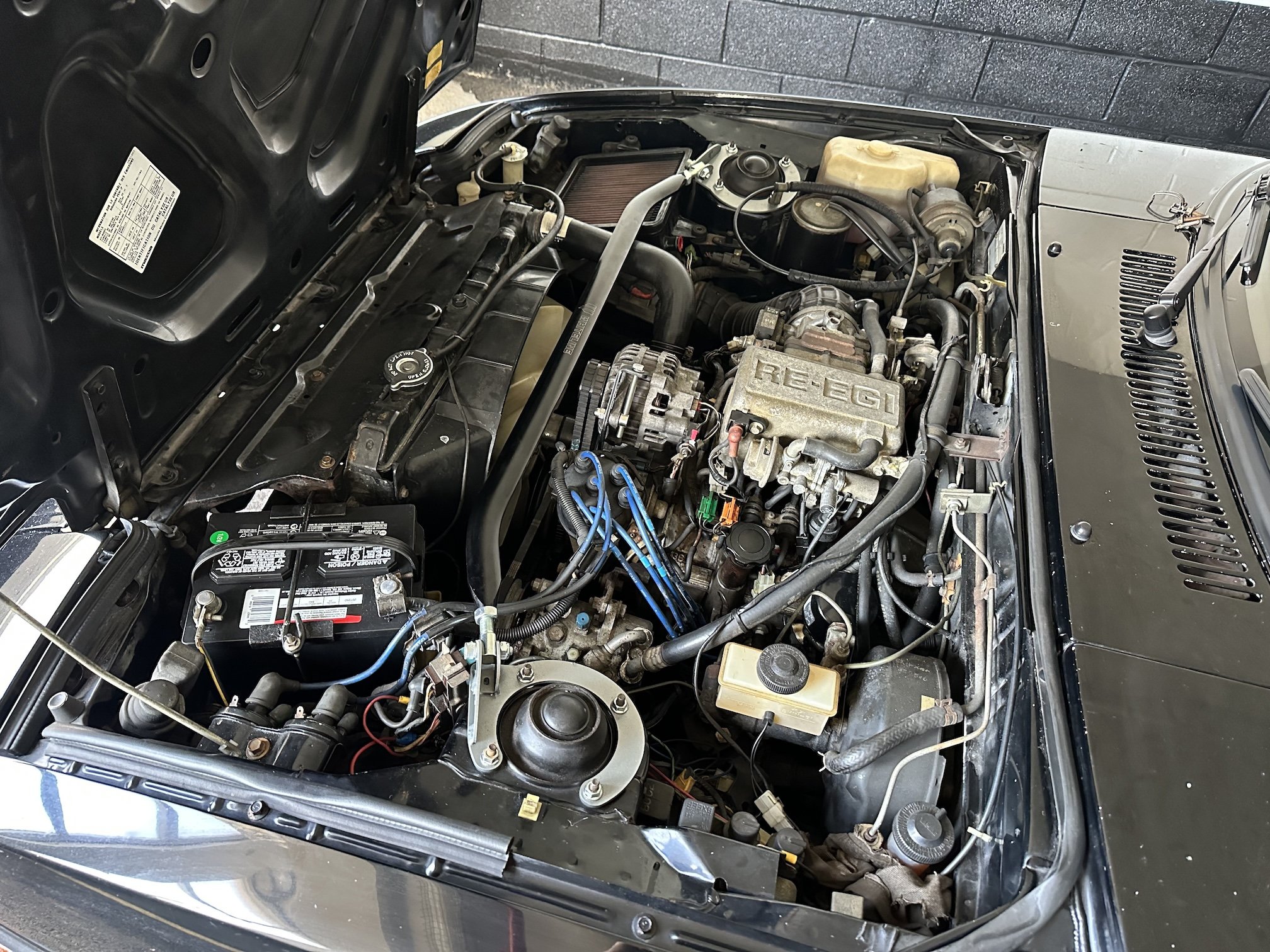

Popular Post fuel Posted June 7, 2024 Author Popular Post Posted June 7, 2024 I still have this and am starting to get back into working on it before I lose interest and sell it too. Recently purchased a Whiteline strut bar that was listed on their website as fitting the 13B GSL-SE but turns out it fouls on the air filter housing and the upper radiator hose. Rather than return it, I opted to modify the air filter housing mounts and shorten the radiator hose for more clearance. 12 Quote
