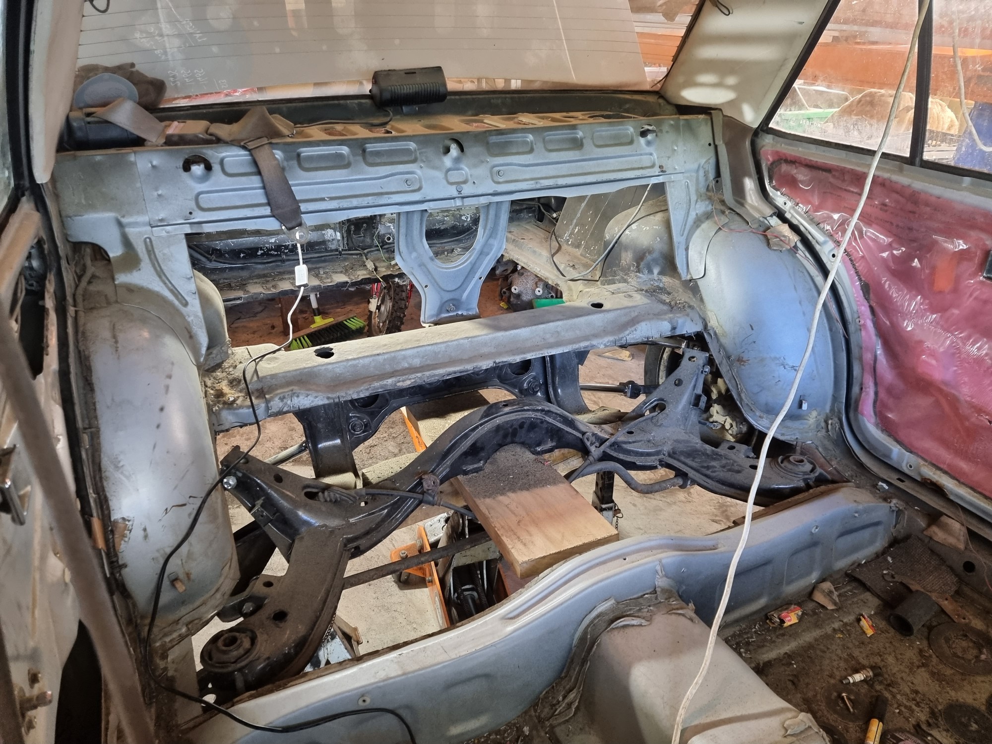

Ditched the borg Warner diff idea when I had a mind explosion. Now has a s14 rear end I'm trying to modify into it.
The surgery started with small cuts and ended up at this current state...
definitely in the deep end over my head but all decisions have happened slowly with plenty of good advice from mates that are experienced in this field of torture.
S14 subframe was purchased for one 18 box of 7p Cody's, no covid or rfb tax to be seen
Obviously next step is to make a new rear chassis to accept Nissan plague into the lancer. This is a huge step and learning curve for me so may be awhile before another update
