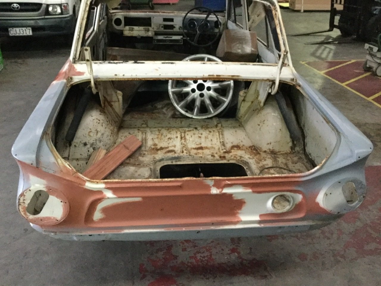

First job is to get all the suspension out of it and build a dolly for it. I know what engine I will be using in it so someone one will pick it as the build goes.

Made up a dolly out of some Unistrut I had and found 4 decent sized castors as well. 2 have brakes and the other 2 have swivel lock pins. Probably a bit overboard however the wheel track width is the same as the car so no problems getting on and off the trailer. Rip the suspension out this week and get it on the dolly and over to the blaster next week.
