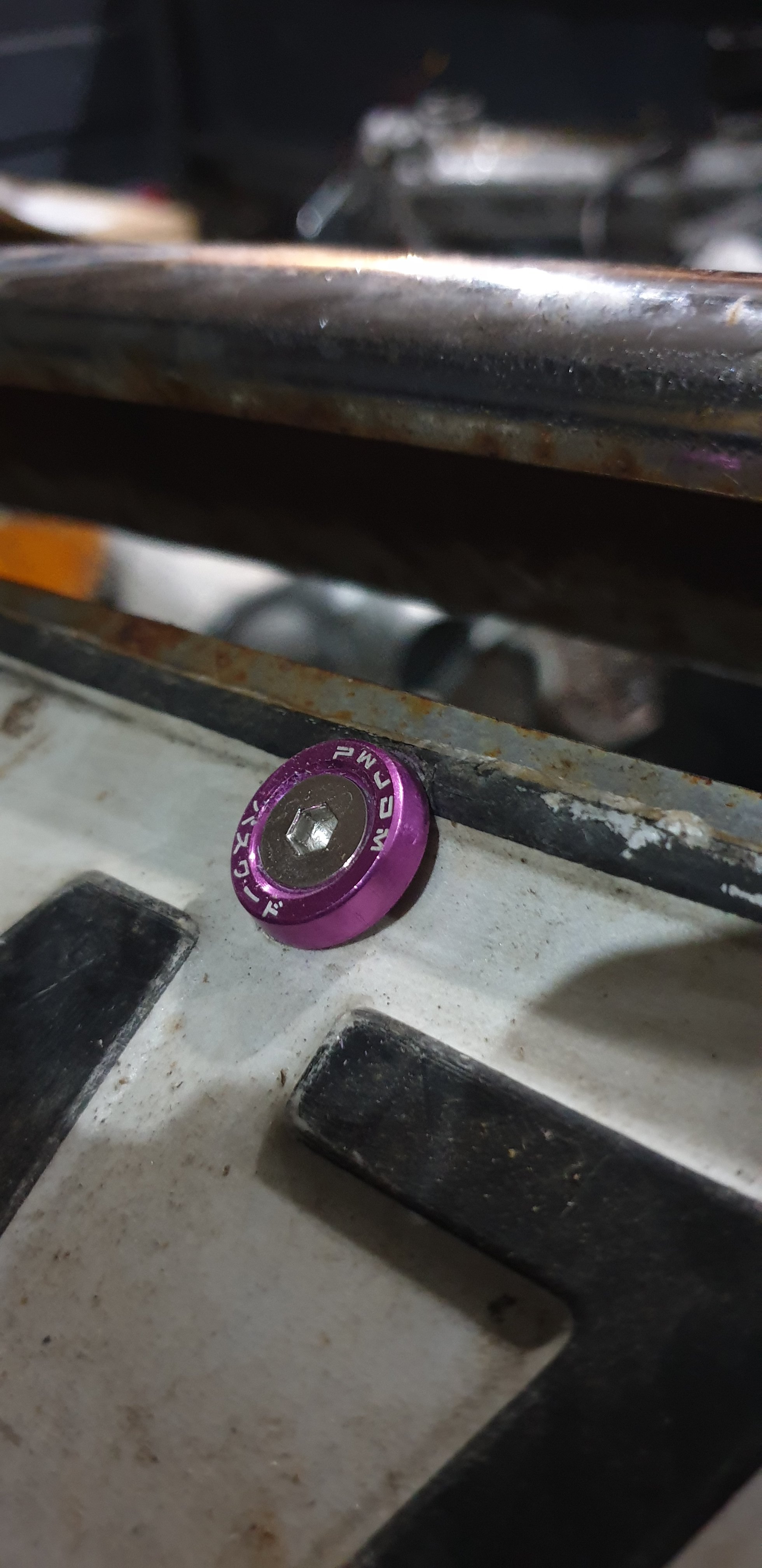

Got bumper brackets and end caps fitted. Chucked two rivnuts in for number plate to mount to and fitted it using those sweet wish accessories everyone loves.

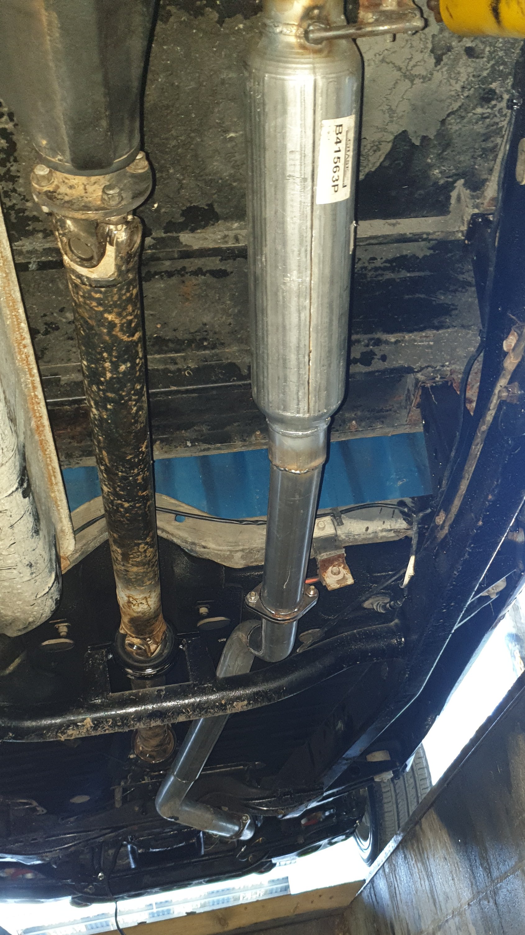

Finished off the rest of the exhaust, its 2.25" right through, one hotdog muffler and one big boy keep this thing quiet muffler at the back because I'm too old for noisy shit...
Has a nice tone to it 20200317_181925.thumb.jpg.be5cc1be3723edb24a7fc407e701d1ae.jpg
