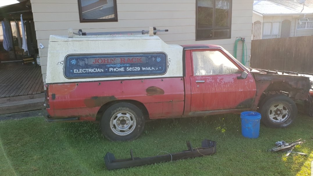

lush Posted February 1, 2020 Posted February 1, 2020 Okay like always I haven't been on here for quite some time, so here's what I've been working on the last two years or more. So here's a few posts hopefully in order all at once.... Purchased this sweet L200 off westley, I think hes on here, another mitsi buddy. Was rolling body, didn't look too bad rust wise but whole reason I bought it was because I'm a sucker for twin round headlights This is where it started Discuss here... 2 Quote

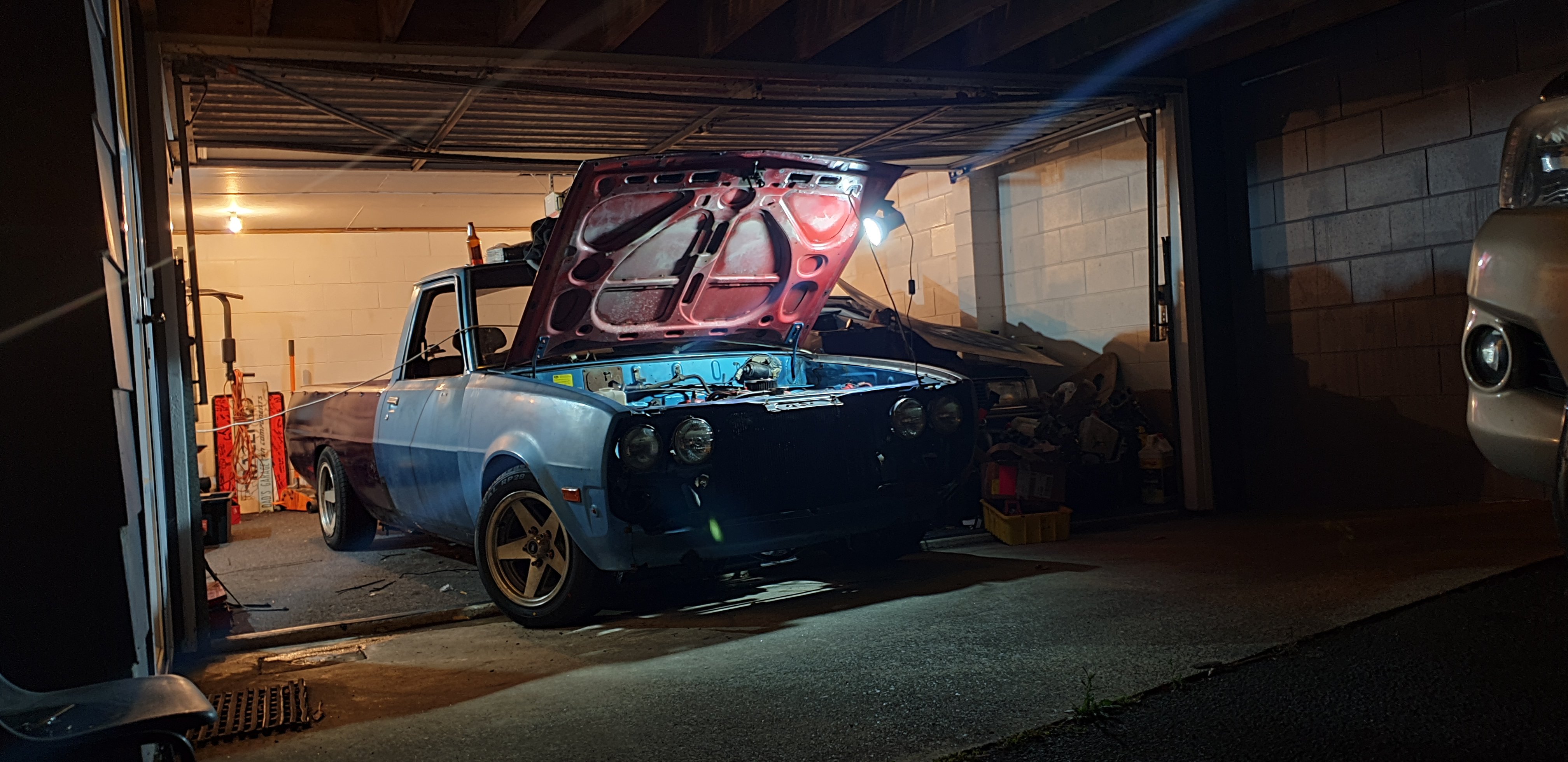

lush Posted February 1, 2020 Author Posted February 1, 2020 Decided to remove cab from the chassis as chassis needed some love, made it easy for rust repairs on the cab too Please note this was my first ever attempt at rust repairs too so go easy on the judgement With the chassis I wire brushed it back, covered in crc rust converter, and brush painted smooth black hammerite on it. Why? Because the quote I got from the sandblaster was way out of my budget... Also got my leaf springs reset almost flat, got 3" tapered blocks, new bushes too Also took a L300 van diff, these are wider and 5 stud, cut the mounts and shifted them to suit L200, put a later model L200 lsd in it too Here's a photo dump.... 2 Quote

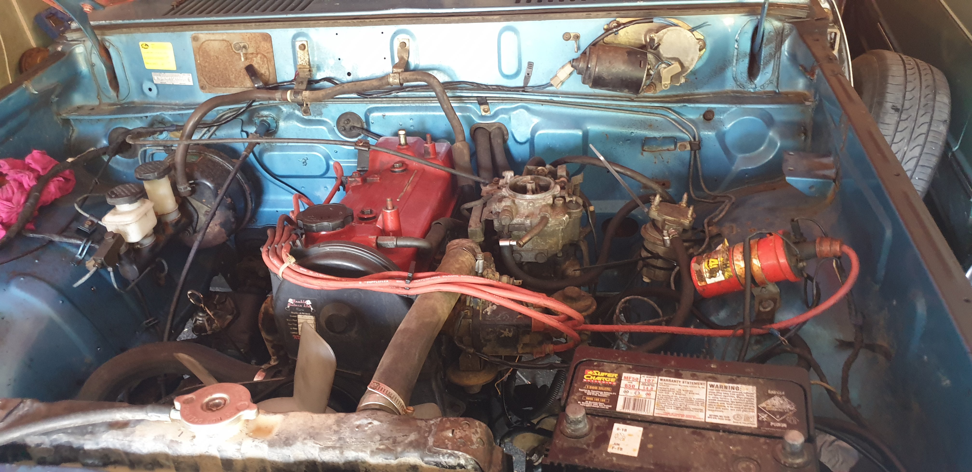

lush Posted February 1, 2020 Author Posted February 1, 2020 So with the wider diff I've had trouble getting wheels to fit, my mate has lent me some 14x7 pro stars which fit but the 215/70 tyres will be replaced with 185/60 tyres. Eventually I'll get diff shortened so I can fit 14x8s but that's out of budget currently. Also was always planning on running air shocks in rear but beach hop is getting closer and my goal is to drive there legally kinda so pinched some good condition monroe shocks out of the 4wd parts vehicle for the mean time. Did a few little bits like fill up diff oil, new shock bushes, fill gearbox oil, spray undercoat under the gaurds. All the little things that are kinda important. Forgot to add earlier that the motor I had in this I swapped into my lancer, so I took the old lancer motor, (4g63 sohc) did a gasket set, another head, and valve grind etc. And got it to start as of yesterday but will not stay running so my guess is its something to do with ignition circuit. Will leave that to my mate josh to investigate as I'm no good with electrical shit but it started which is chuuurrrrr 6 Quote

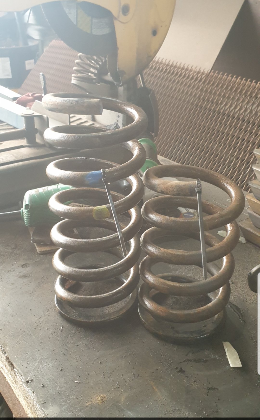

lush Posted February 18, 2020 Author Posted February 18, 2020 Managed to get abit more done two days in a row! Just some small things, steam cleaned and painted my brake drums and lower arms. Fitted new balljoints and bushes to lower arms and bolted those pups back in. Tested a different spring, suzuki escudo springs I cut to be captive but they're slightly softer then the original L200 springs. And lastly I put the new swaybar links in! Nothing too spectacular but it's all the little things thatll make it fly through a wof check hopefully 2 Quote
lush Posted February 18, 2020 Author Posted February 18, 2020 Painted the escudo springs oxide primer "just cause" 1 Quote

lush Posted March 2, 2020 Author Posted March 2, 2020 We will begin this with "work sucks" because I end up doing 15 hour days consecutively but would much rather be in the shed. But working gets me money to spend on this so i keep going back.... Somehow In between adulting and sleep therapy I have achieved very little progress Front end is complete again, new tie rods, balljoints, bushes etc. Rear end has l300 bumpstops as my cut ones would let tyres rub. Broke the bank and bought new tyres 185/60r14 goodrides and we have dropped it back on the ground Ordered new front shocks, gearbox mount, waterpump and bosskit so playing waiting game again. definitely getting nervous about getting this ready for beach hop as its basically 3 weeks away and I still have alot to do..... 3 Quote
Popular Post lush Posted March 3, 2020 Author Popular Post Posted March 3, 2020 Managed to get it started so I'm freaking stoked it runs! Also only has extractors so didnt run it for very long. Ordered some exhaust tube and bends today so will drag the ute in to work one day so I can start on the exhaust asap. Just another tiny step closer 10 Quote
