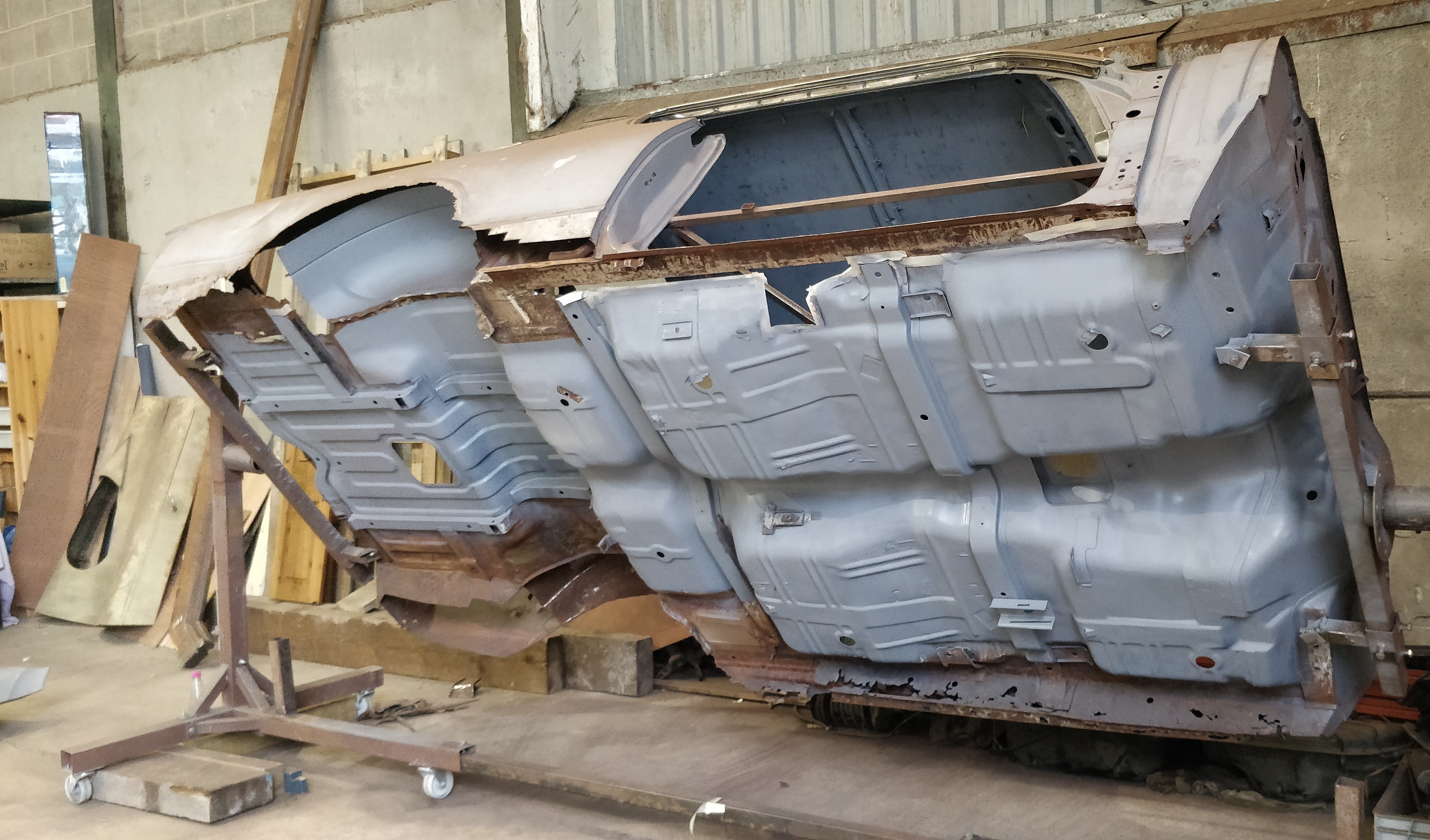

Popular Post Jordan_L Posted April 11, 2021 Author Popular Post Posted April 11, 2021 Big job done today getting the body off, no evidence of chassis rot just some surface rust to wire wheel. Â Â 13 Quote
Popular Post Jordan_L Posted April 25, 2021 Author Popular Post Posted April 25, 2021 Got a jig set up & the car mounted, ready to bare metal underneath & make a start on the sills etc. 17 Quote
Popular Post Jordan_L Posted May 14, 2021 Author Popular Post Posted May 14, 2021 Slowly but surely... 12 Quote
Popular Post Jordan_L Posted June 16, 2021 Author Popular Post Posted June 16, 2021 Slow progress recently, but I have made a start on the sills. Now the outer is in place, i can make an inner & then button the outer up to the A pillar/rear arch   16 Quote

Jordan_L Posted January 1, 2022 Author Posted January 1, 2022 The entire wheel well needed replacing, which ive done while being off work for christmas. glad to say there are now no other big areas of repair to be done underneath. 7 Quote
Popular Post Jordan_L Posted January 17, 2022 Author Popular Post Posted January 17, 2022 Epoxied, seam sealed and Raptor'd underneath. Over the moon to have hit this milestone after so much welding! 19 2 Quote
