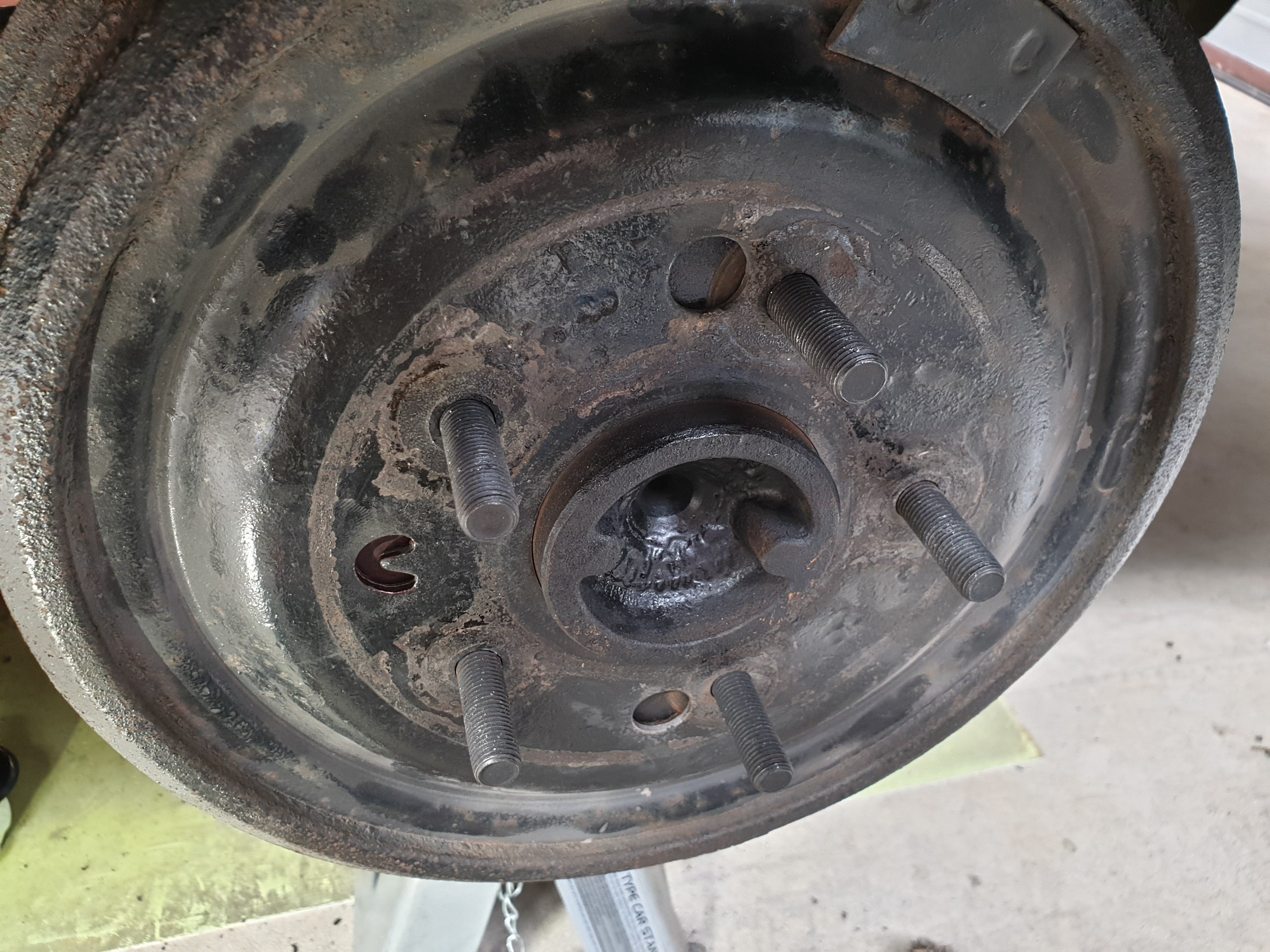

Kimjon Posted October 16, 2019 Author Posted October 16, 2019 Wheel studs, needed to be longer as not enough thread engagement with mags on. Sorted! 4 Quote

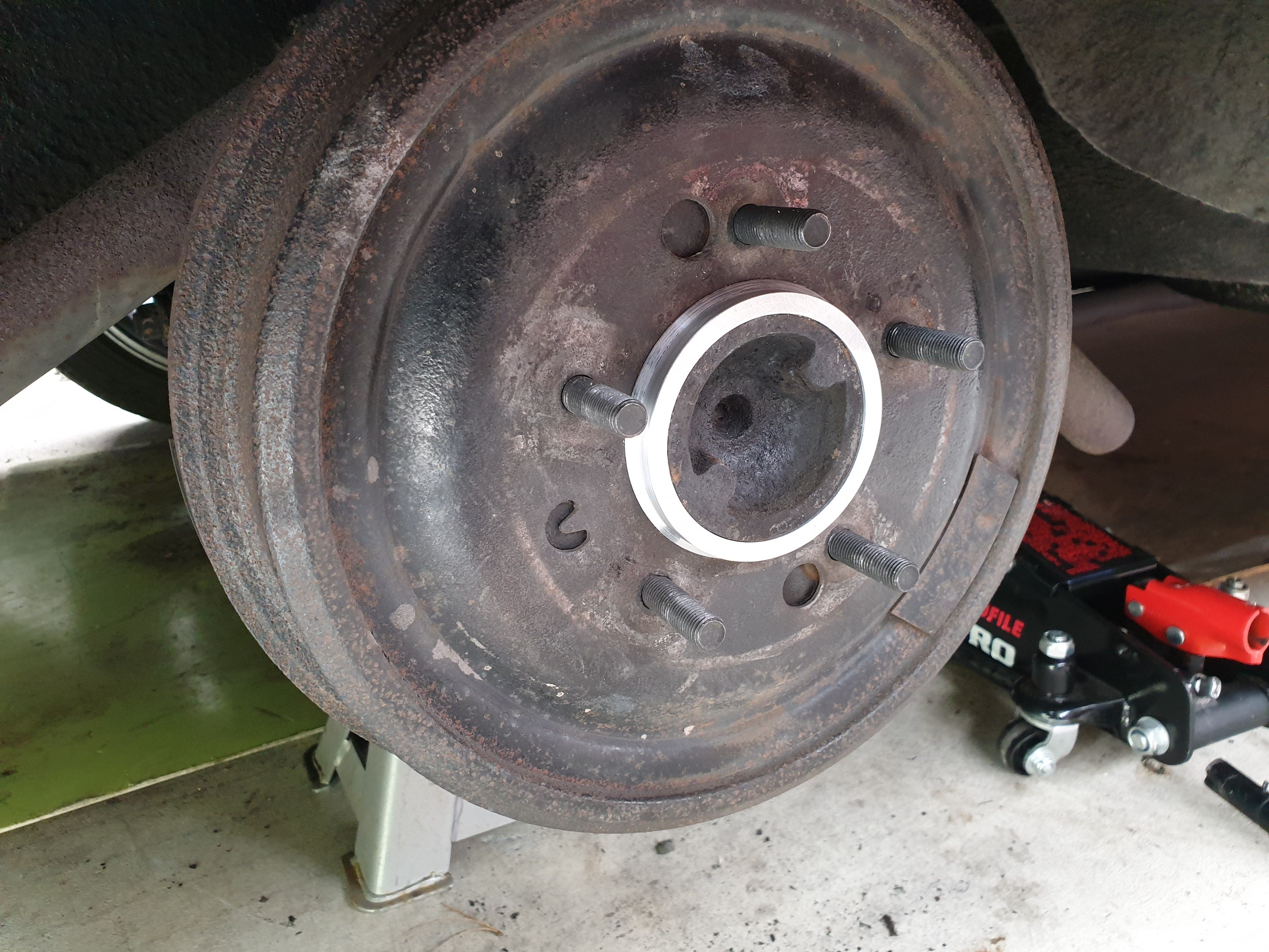

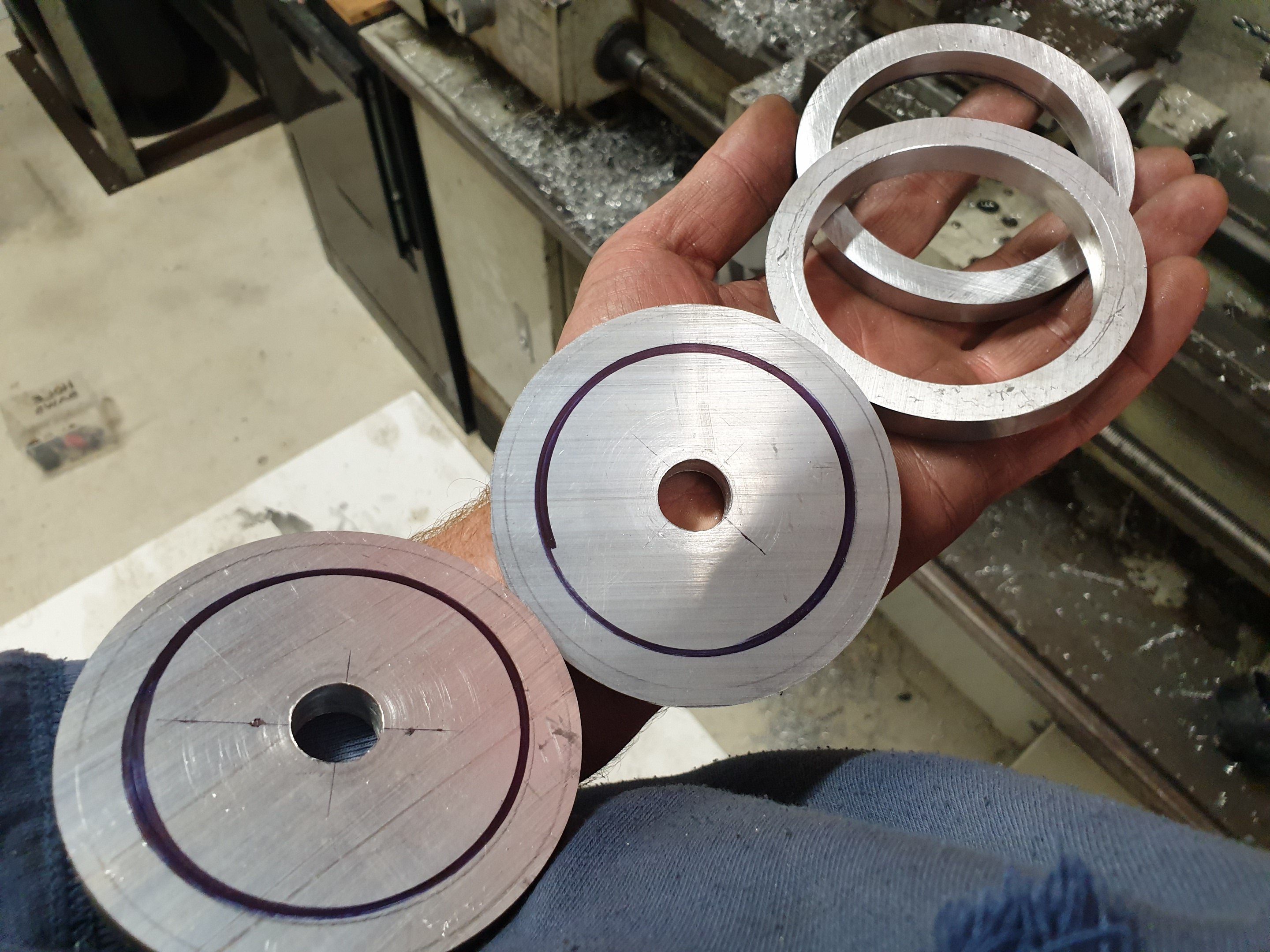

Kimjon Posted October 17, 2019 Author Posted October 17, 2019 Making spigots for the wheels to help centre them. 3 Quote
Kimjon Posted October 17, 2019 Author Posted October 17, 2019 Getting there. Just looked at the time and its after 11pm...time to stop working, will make a costly mistake soon if I carry on into the night. There's always tomorrow to get it done... 5 Quote
Kimjon Posted October 18, 2019 Author Posted October 18, 2019 All done (x4). Phew!!! That was actually a lot of work to achieve... 7 Quote

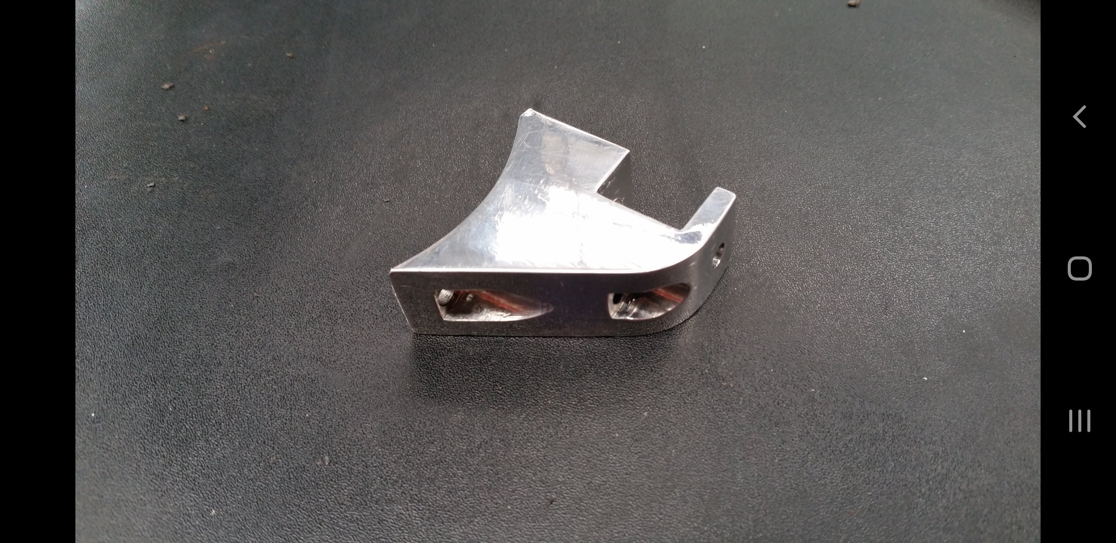

Popular Post Kimjon Posted October 18, 2019 Author Popular Post Posted October 18, 2019 I like this photo, it's the end result of machining these out of solid blanks of billet. A full rubbish bin of swarf!!!! Ones on the car, here's the other three. 12 Quote

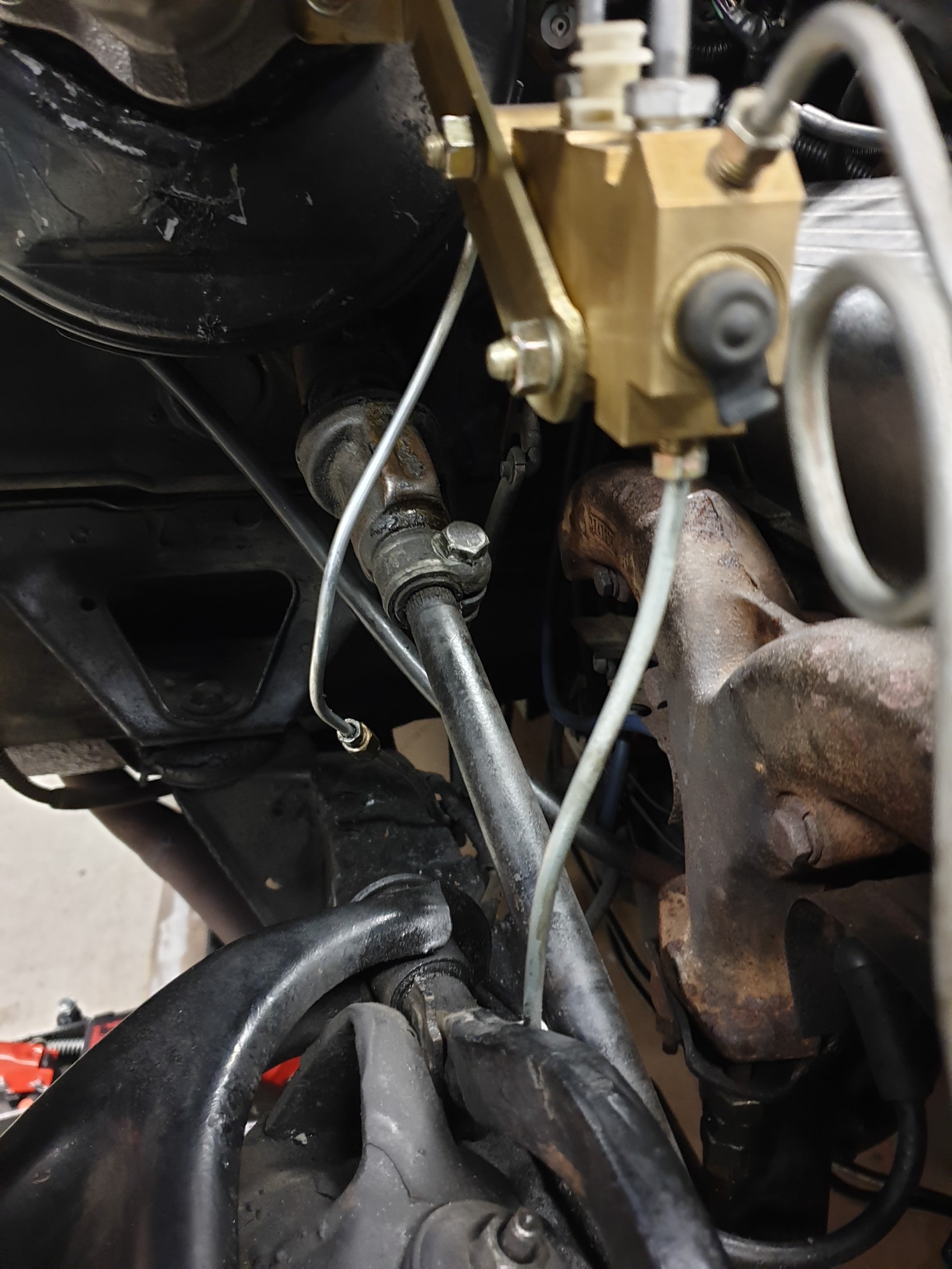

Kimjon Posted October 19, 2019 Author Posted October 19, 2019 Brake lines moved away from exhaust 2 Quote
