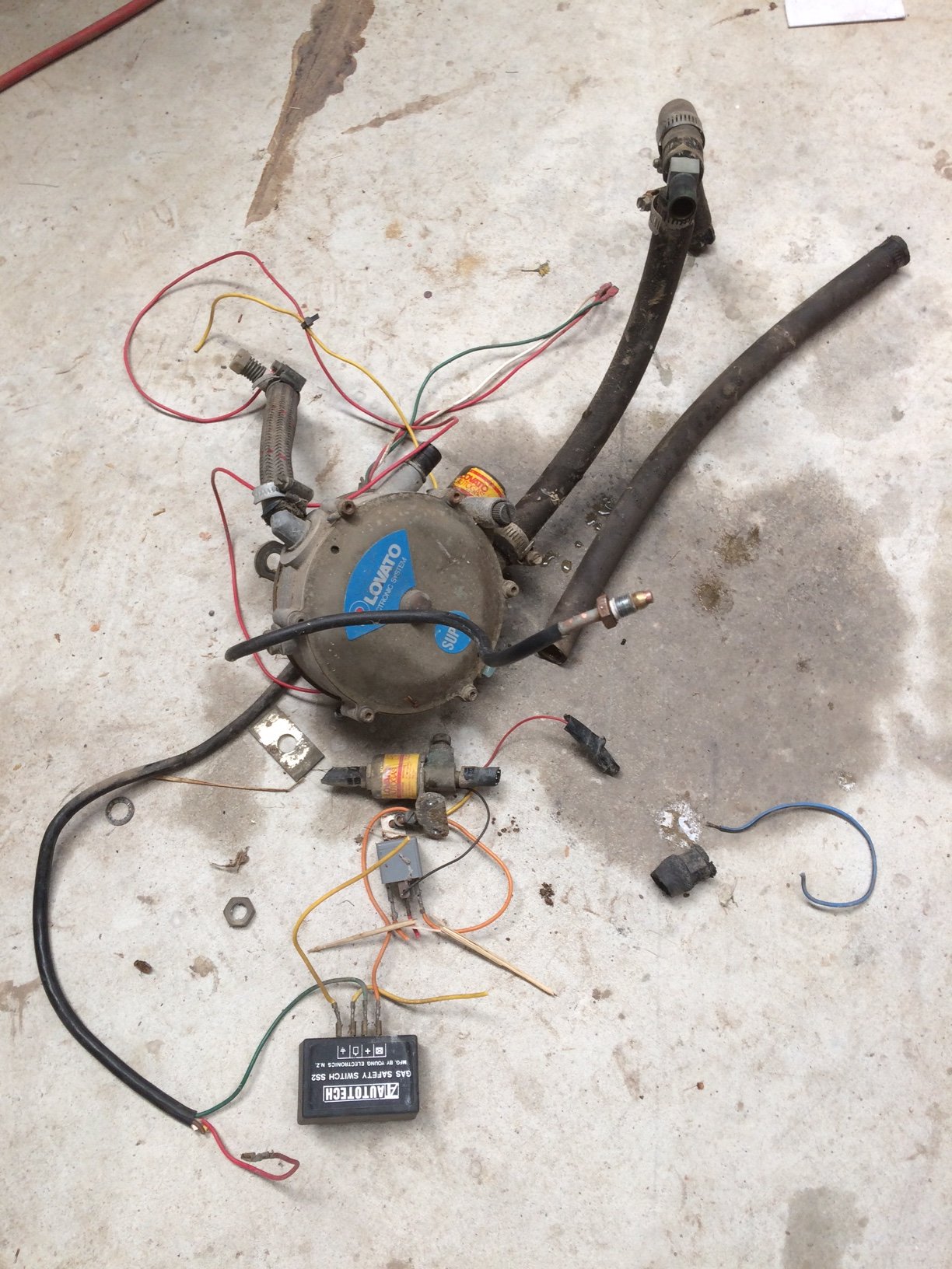

Sunbeam Posted December 23, 2019 Author Posted December 23, 2019 The Landy is great for pottering about with when you have a few spare minutes. LPG stuff. Out. One small issue, however. There is still gas pressure in the hard line from the tank. I very gingerly cracked it and it went hiss, so I’ve nipped it up again. Now, I know nothing about LPG systems so are there any experts out there with some advice on how to safely get rid of decades old LPG? Hit me up here Sunbeam’s Land Rover discussion Quote

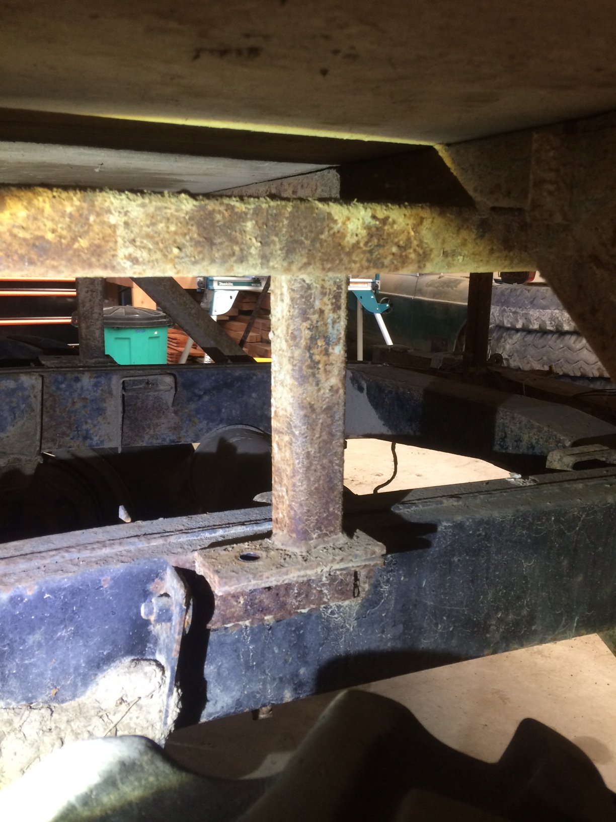

Sunbeam Posted April 13, 2020 Author Posted April 13, 2020 I decided today would be a good day to pull some more bits off the Landy, rather than doing gardening. The deck looks easy to remove. Only 6 bolts, and some tail light wiring. The wiring was carefully disconnected with a pair of side cutters. On the subject of the deck, its big. 2300x1800 big. This seems great, however it puts the tow ball a long way under the deck, and I forsee high head injury risk. Also, the deck is high. It’s been lifted to clear the LPG tank. I would love to see pictures of a properly mounted flat deck, as I don’t think British Leyland had 6 tall stilts bolted through tabs arc welded to the chassis in mind. Anyway, I digress. The bolts are METRIC!! And galvanised, and undid very easily. At this point I gave the deck a test lift and thought yeah, that’s not too heavy. So I stacked some spare wheels on the floor next to the deck, and tipped it off the side. Easy peasy. But then it suddenly got very heavy and not well balanced. Luckily the children were playing in the shed, so while I held on for dear life brewing up an aneurysm, I got the kids to move the cab roof, toolbox, some trestles, and my drop saw out of the way so I could finally lay it on the floor upside down. Stupid idea to do this by myself in hindsight, but here it lays. It is also rotten and not very well made, so maybe I will build one from scratch. Quote

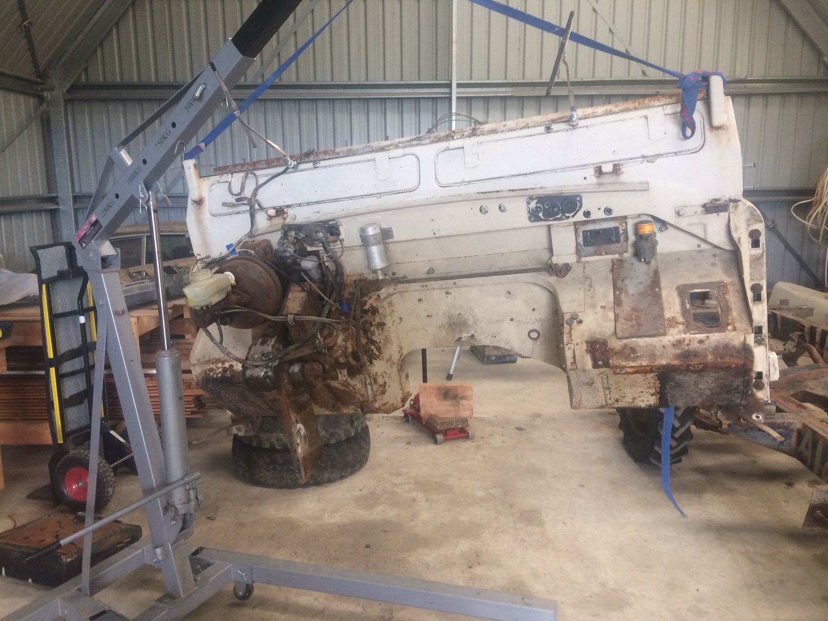

Popular Post Sunbeam Posted April 15, 2020 Author Popular Post Posted April 15, 2020 I managed to get hold of an engine crane today, observing social distances etc. This happened so I thought I may as well take the engine and box out. Finally some bolts that were easy to undo, as they are all coated in liberal quantities of various lubricants. A couple of disturbing revelations, which made me very glad I never drove it faster than about 30km/h. The bolts connecting the driveshaft flange to the diff were less than finger tight. Also the left engine mount wasn’t bolted to the chassis. Definitely a bit of weight in this lot Voila. One nekkid Land Rover 14 Quote

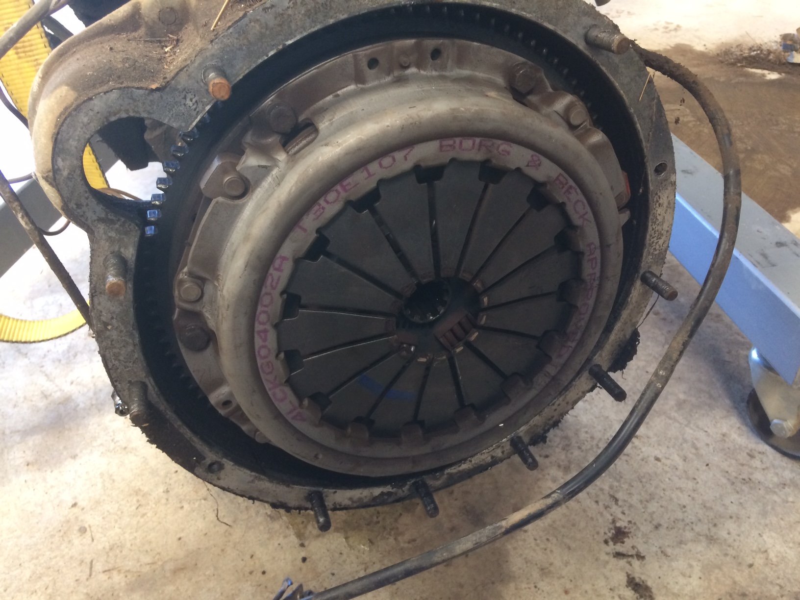

Sunbeam Posted April 16, 2020 Author Posted April 16, 2020 This morning I arranged a divorce There are no rivers of oil etc, so just normal Imperial seepage. The clutch looks quite new, a Borg&Beck. The release bearing also feels new. I think they can go another round. Winning! 4 Quote

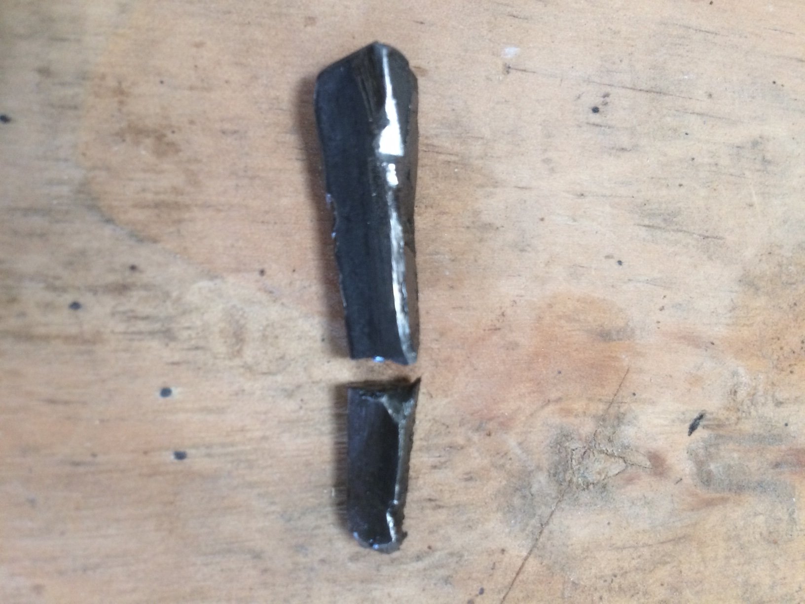

Sunbeam Posted April 27, 2020 Author Posted April 27, 2020 This thing is not easy to roll around on the tractor grips, so I fitted some low rolling resistance tyres I had on a spare set of rims. I also wanted to drain the diffs. Rear diff will have to be done off the car, because some animal managed to shear off the square head on the drain plug. Front diff was easy, but this came out: Probably not supposed to be there. 2 1 4 Quote

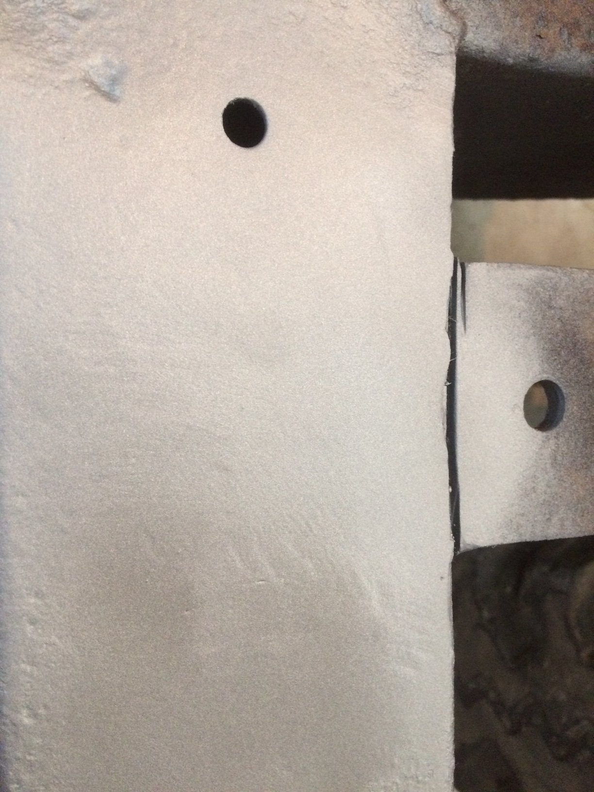

Sunbeam Posted May 8, 2020 Author Posted May 8, 2020 After 5 minutes practice on some scrap steel I decided to do a patch on a fairly no jeopardy part of the chassis. The outrigger in front of the left rear wheel had a rust hole in the top. It so happens that the steel thickness of the front bumper is the same as the chassis so I cut the patch out of the bumper (bumper is bent badly at one end) and ground the galv off with a strip disc. Bear in mind this is the first thing I have ever welded onto a car... Welded it in. Grind down And blast some zinc primer on it. Can I just say grinding sucks. It seems to get good penetration I end up with a fairly thick bead on the top. Operator error, no doubt. Also, a quick run over with a flap disc at the end would make it look nicer too, but hey, it’s only a Land Rover chassis. Then I thought I would try out my new twist knot cup wire brush on a crusty piece. The bottom part of the photo is a minutes work after which I had to undress in the workshop, and pull a piece of wire out of my leg that had gone through my overalls and 2 layers of clothing. I am inclined to dislike the wirebrush. Anyone else get stabbed by these? In contrast the top half of the photo is 10 seconds with a 3M strip disc and zero injuries: 5 Quote
