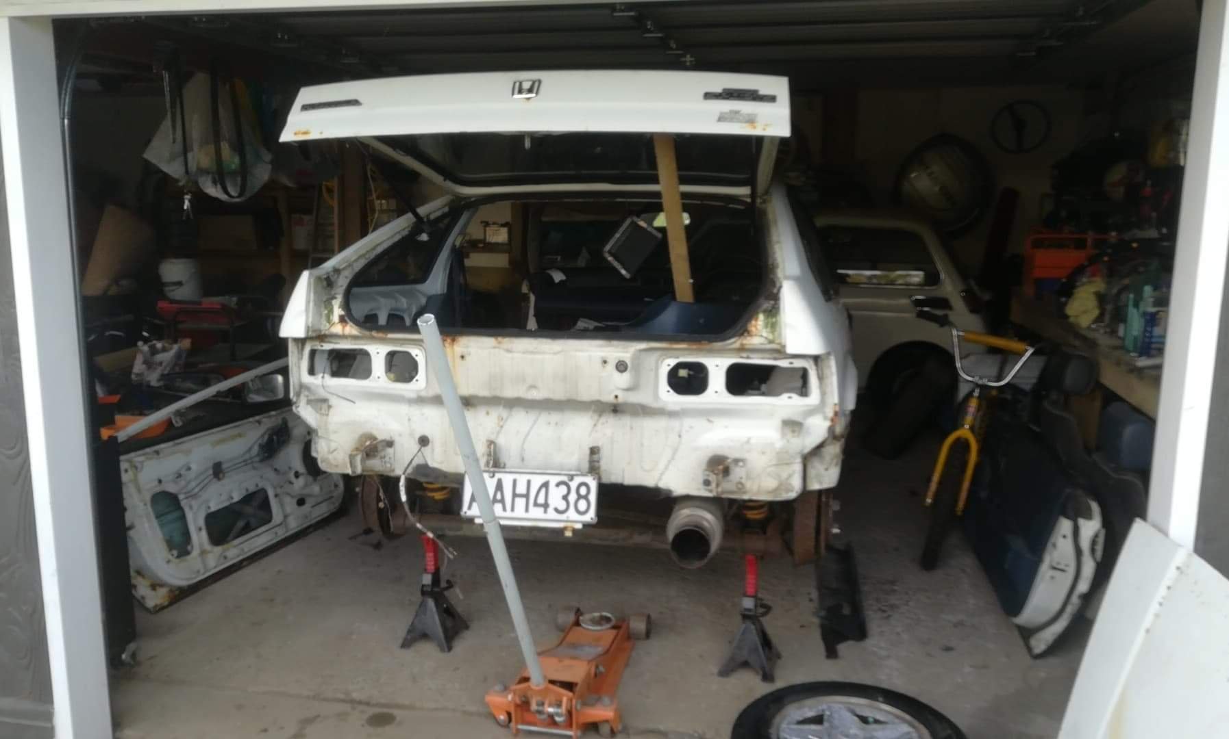

Popular Post SiRge Posted May 18, 2019 Popular Post Posted May 18, 2019 Fleet expanded. Discuss - It's a 1985 Honda Crx, bought it for a sharp price. Its a ex drag hack from a guy on nzhondas Deanis from 2006. It had a feature in July 2007 performance car, yet to find a copy. Its best time down the strip in its hayday was 12.7 I believe. It had a high comp B18cr (kinda), quads, LSD box, super light wheels and drag radials. Current specs are aporox: - Poor man's type R engine - Non LSD box - Rust - No wof and Dereg, but has a cert Plans are: - De-rustify - Get it legal (needs at least washer bottle + motor, quieter muffler, 15 inch wheels, B pilar plastic) - Tidy up and add a couple niceties back in like carpet and a windscreen fan. Will try redo wiring and tidy engine bay. - Later - try add quads back, needs exhaust headers, get an LSD. Garage space at a premium Just fits Now to get it naked to make more space 13 1 Quote

Popular Post SiRge Posted May 20, 2019 Author Popular Post Posted May 20, 2019 After watching that rookie car YouTube guy B is for Build take out a car window ages ago in one of his vids I thought fuck it, how hard can it be. Success. Found some rust hidden by plastic panels too. Well, there used to be metal there... 10 3 Quote
SiRge Posted May 28, 2019 Author Posted May 28, 2019 This weekend was productive thanks to a few friends helping (Was on dad duty as well). While a mate was collecting the engine crane, another friend put the wheels on the car and rolled it outside. Some genius thought it'd be a good idea to do a skid (me) so I started her up, sat on the rusty floor and effortlessly ripped a single peeler. Success. All went pretty smooth form here with removing engine, a few shitty wiring examples from the original builder (Wires crimped instead of plugged) but nothing we can't deal with. With minor swearing, the engine was out and it became apparent that the top radiator stay needs to probably be removable. There are scratches up the firewall on the drivers side where the rear engine bracket has about 3mm clearence when trying to remove the sucker. Engine was out finally and the car could go back in ready for me to remove subframes and go on a hunt for some more rust. After all that, no more photos was taken, it all went back inside in a hurry. Spent an hour with it last night getting it to a good position to lift it on axle stands (See: Final resting ground). Plan is to take all subframes and suspension off, I have requested/ordered an energy hyperflex kit from Adam @ Speedscience. will then clean up arms stuff then Por15, install new bush and reinstall to car. Today also bought an engine and body loom from an SIR EG Civic. This will be sacrificed to convert the car to obd1 and also to ensure nothing is missed/fucked from the current butchered Da6 wiring job. It allows me to have free wiring for things like dash fans etc which the car doesn't have... And now for pictures. Rest now sweet Prince. Location of the engine until I can get new bits for it. Should probably do cambelt etc right? During the process, the was left in the trolley jack... Hmm We only lifted the tow hooks. Hmmm, not this side... (Can also see the traction bar & mounts, needs to be cleaned up or redone) Oh, don't even need to get on my hands and knees to see this lol. That bit to the left bottom is bottom rad stay BTW. You shouldn't be able to see light through that other hole... 8 1 Quote
