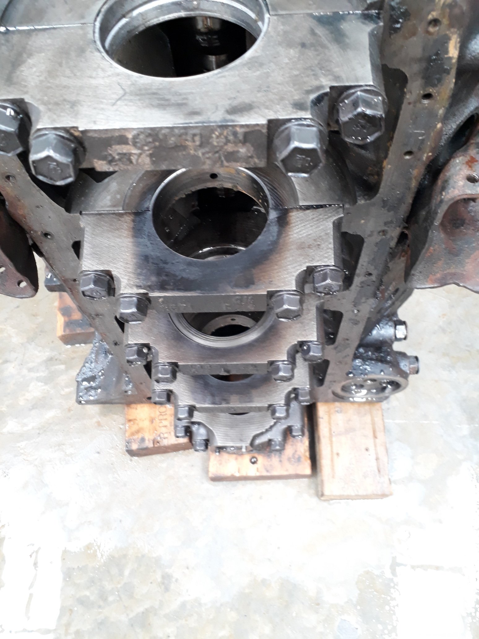

Unclejake Posted March 3, 2019 Author Posted March 3, 2019 Three of the five main bearings looked like this. It's the reason the motor was so tight to turn over, and probably caused by an oil line falling off a couple or months before the vehicle got parked. There's no blueing on the crank but the crank journal is slightly scored, as is the crank. The three mains that spun bearings are the three centre ones. These blocks are known to crack at the crank webs of the three central mains, but with a visual inspection I can't see any cracks. I'm pretty sure the bearings are original size (I need to look up the numbers to be certain) I'm off to find a 1,000 litre water container and a petrol water-blaster to try an clean the block up a bit more. The headgasket where the pre-combustion chamber had rotated shows milds signs of soot past the fire ring. I know the previous owner changed the heads some time ago. The engine bolts were either so tight I needed a trolley jack handle over a strong arm to budge them, or were finger tight. There was no in-between. Ha! I need to decide if I'm going to fix this properly (which means sending the disassembled long-block to either Napier or Timaru for a line hone, crank grind, head job and re-bore), or if I'll risk just chucking a fresh set of bearings at it (and not even bother plasti-gauging it) and re-use the existing pistons and rings. I'll ponder than over a beer later in the week 6 1 Quote
Popular Post Unclejake Posted March 3, 2019 Author Popular Post Posted March 3, 2019 I wouldn't recommend waterblasting a block with the cam and lifters still in, but I didn't have any other way to get it cleaned so I spent 45 minutes pumping bore water onto a ute, then borrowed a petrol blaster and a hose. Gravity feed to the blaster wasn't the best, but at least the block is clean enough to see a bit better, but probably still oily enough not to rust much overnight. The blackened main caps tell a story of no bottom end oil flow and spun bearings. I am not sure which happened first. I reckon I'm going to order a set of gaskets, bottom end bearings, a timing chain and just slap it all back together. 16 1 1 Quote
