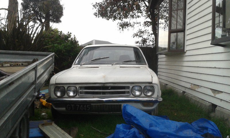

daveyc123 Posted September 24, 2018 Posted September 24, 2018 I thought it was about time I shared my viva with you all. Here we go.... I moved over to nz from the UK nearly 5 years ago. I told myself that once I was settled I would get myself an old car. I was on the look out for an escort or cortina, but with prices rising the prospect of owning one was slipping away. I wanted a rolling restoration something useable that I could tinker with. Previous to buying the viva the most work I had carried out on a car was an oil change. I loved the idea of doing more and learning as I went, but didn't want to take to much on....... I took to much on. Two years ago a viva popped up on a Facebook but sell page. I went for a look. Not having a clue what I was looking at I thought it doesn't need to much doing and I bought it. I quickly realized it was a way bigger job than I anticipated. There was virtually no interior and what was There had been 'modified' it was missing the alternator, the fuel pump, bits of wiring had been cut out, it had a Victor grill fitted. It was in quite a sorry state really, but overall the body was pretty solid. These are some of the first pictures I took of the car 3 Quote
daveyc123 Posted September 24, 2018 Author Posted September 24, 2018 If anybody happens to recognize the car and has any Info on it I would love to hear from them. With no mechanical knowledge I decided to start by doing repairs to the flared wheel arches as these had all cracked and one had a chunk missing. I'm pleased with the results, the car will eventually get resprayed. But for now just blowing in the repair sections is fine for me 3 Quote

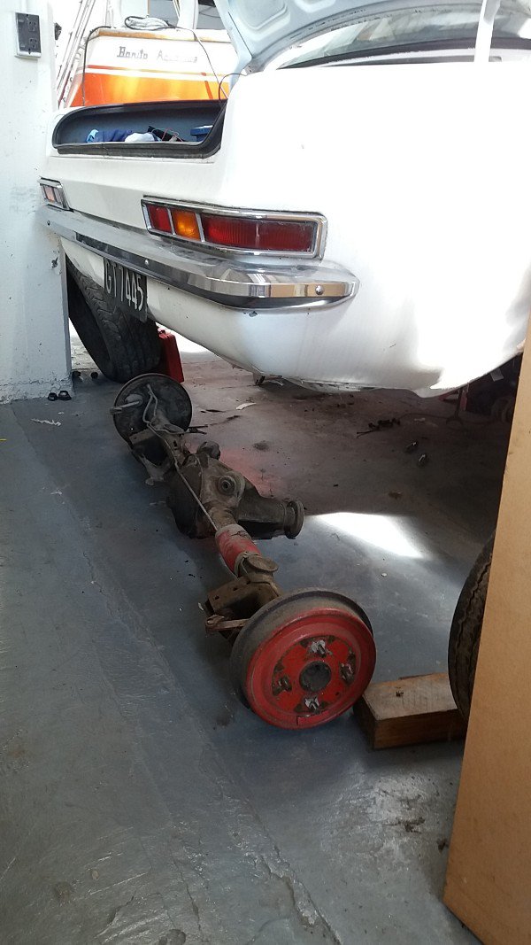

daveyc123 Posted July 30, 2020 Author Posted July 30, 2020 Oh wow almost a year without an update! Things have been happening with the viva but it's still been slow progress. So the car now runs and has had a very brief road test. I genuinely don't think it's to far away from the road! The bigger magnum brakes have been fitted. fully reconditioned calipers and master cylinder were what was needed with New shoes and cylinders in the drums. All electrics work apart from the interior light. This shouldn't be to much drama to sort. Bad earths and poor connections were causing issues with the headlights and indicators. All added electrics run through a separate fuseboard which makes things easier. Top and bottom ball joints replaced Tie rod ends replaced A variety of bushes replaced The engine is running really nicely, no oil or coolant leaks. Most of the ignition system has been changed as i was having various running issues. Ultimately these were caused by the wrong coil being fitted and the ballest resistor wire not being disconnected. The carb will need some fine tuning I'm sure. But I'll get someone who knows what they are doing to look at this. I don't even know if the jets are the correct size. The carb is a bit big for the little 1256cc engine but hopefully it can be down tuned if need be. I'd like to keep the 32/36 but if I need something smaller then so be it. Lots of learning has happened during this project, which is exactly what I wanted. There was an intermittent hot starting problem which turned out to be the inlet manifold had no metal gasket. Something so simple which has caused me years of head scratching and Google searches! The oldschool forum and various viva Facebook groups have been an infinite source of knowledge and wisdom! A huge thank you to all those that have helped and inspired! So i don't have to much left on the 'to do' list. But here it is: The wipers are really slow, so I'm going to give the motor and connections a good clean and hopefully get it working a little better. Tidy up some electrics and get the interior light working. It's mainly just checking everything over and making sure things are sheathed and tight. I'd also like to relocate the rev counter and oil pressure gauges. Which won't be to much drama Fit a few interior bits and pieces like the step trims are to be fitted. And then give the car a good clean. Then the car can go for it's rust repairs and have the new window rubbers that I very prematurely bought fitted. Then off to a classic car friendly garage for a tune up and wof. I'm sure there will be things to sort out for the wof but hopefully nothing major! It still bugs me that the paint and wheel arches are so crap. I aspire to have it shiny with standard arches one day but for now I have a bit of a plan regarding the look, which will be a kinda patina racing look. It just needs a few aged decals and aged door numbers. It'll definitely make it stand out and will be a bit of fun. The app I was using to resize photos isn't working and my phone won't let me download another app so I'll resize them online and post them below. Any thoughts or questions please express them in the discussion thread. I'd love to hear your thoughts. 4 Quote
