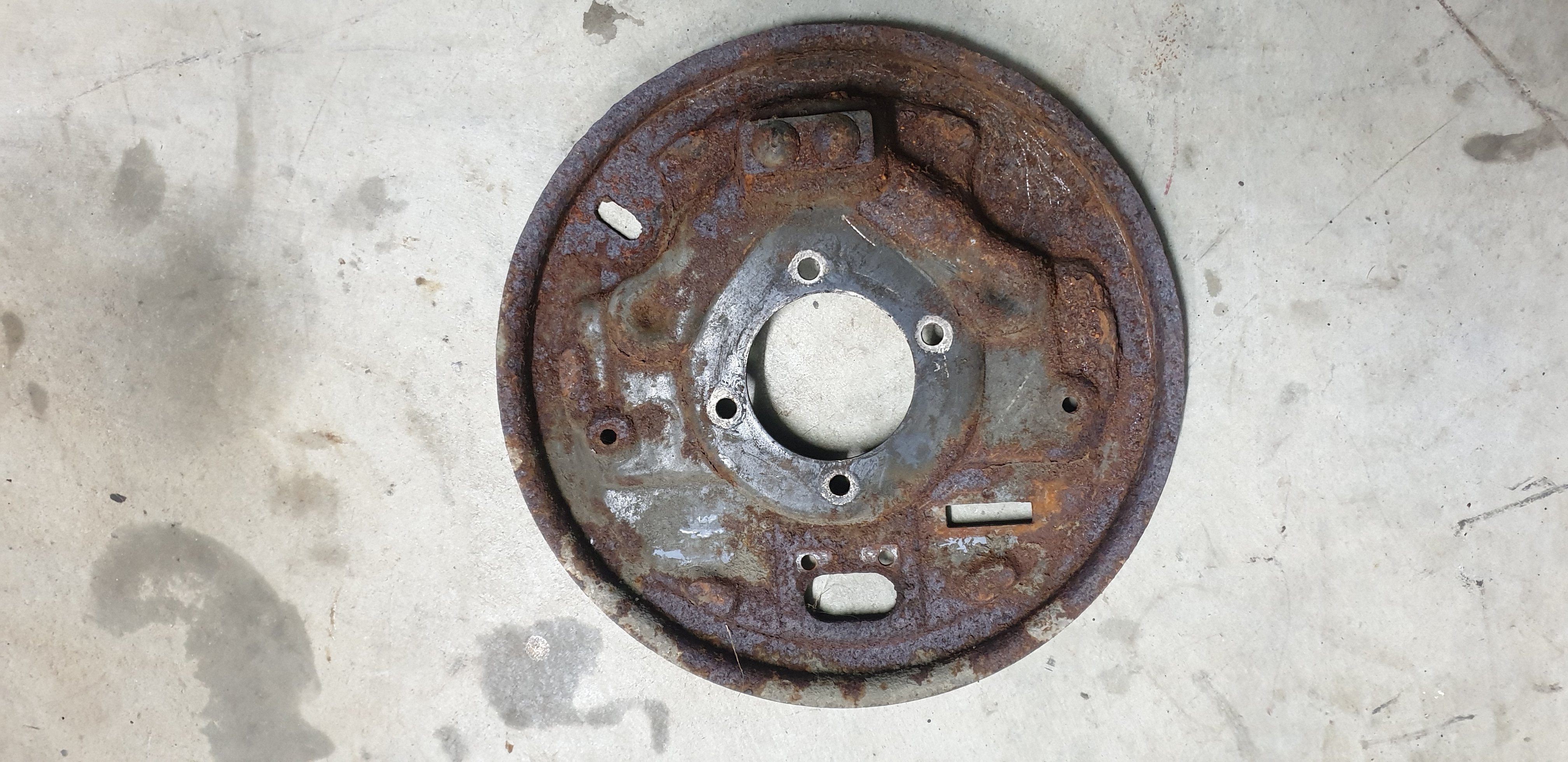

Type49 Posted January 24, 2020 Author Posted January 24, 2020 Have started on the rear brakes too, all stripped and ready for some sandblasting... Quote
