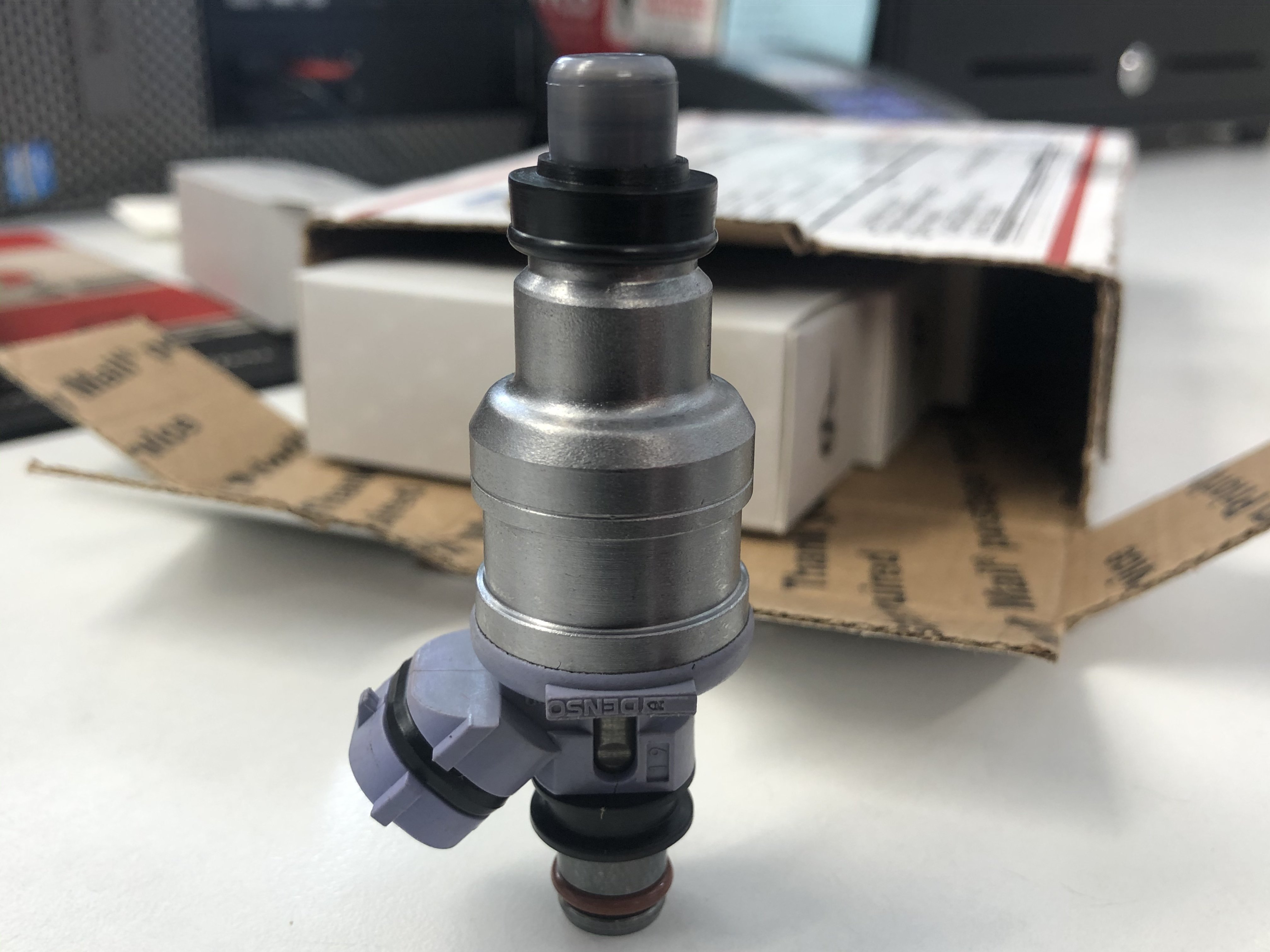

Bluebear01 Posted January 27, 2020 Author Posted January 27, 2020 Rebuilt stock injectors from the States, including all seals. A bargain at $160 to my door. I’ve just about finished sorting out the air filter, then the engine can go back together and we’ll see how it runs. 5 Quote

Bluebear01 Posted February 1, 2020 Author Posted February 1, 2020 So all back together with the new injectors, running much better but not perfect. It’s still got a stumble off idle and still seems a bit rich. The o2 sensors for both banks are reading a constant rich 0.9v at idle, then start a healthy 0.8v-0.2v cycle after 2500rpm. That’s about where it starts running really sweet too. I knew the injectors, leads, plugs and TPS were all spot on at this stage, but I had no reason to trust the air flow meter other than it runs rubbish without it. So I plugged in the scope and had a look. At first I thought I had a bad connection, but after triple checking everything this is the signal at idle. Nothing at all! After revving up past 2500rpm she starts running sweet, leans out and at the same time pops out this signal... Gotcha! It all makes sense now. Time to hunt out another air flow meter. That raises the question, secondhand or chinesium? I can’t imagine it would be easy to make a reliable Chinese Karmen Vortex on the cheap? But it’s got to be getting hard to trust a 30 year old part too... Anyone have any experience with new aftermarket afm’s for the 1uz? Cheers for reading! 6 Quote
