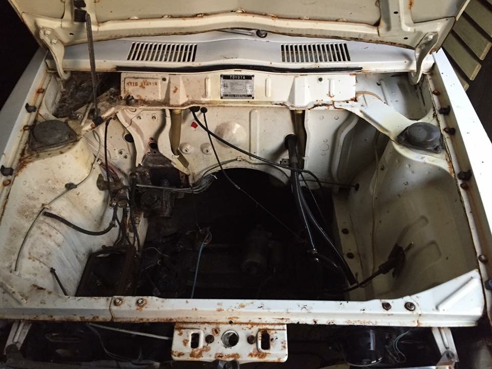

Popular Post rxtoy Posted August 9, 2017 Popular Post Posted August 9, 2017 I've been chasing this thing for years, had the money out of the bank to buy it at one point but the owner changed his mind. He's finally decided he's moving overseas and everything has to go. I struggled to put the money together but the girlfriend really likes it too so she loaned me the amount I was short by It's a pretty much rust free 1968 KE15, comes fitted with an auto but no motor. It's leaf rear, coil front. Apparently they were transverse leaf front stock so I'm not sure if someone has fitted KE20 front or maybe there's a JDM version or something. It comes with a Borg Warner disc brake diff that has been narrowed for a later model Corolla, I need to measure to see if it's actually skinny enough, R31 struts and front brakes, coilover sleeves, a set of watanabes, a G52 box and bellhousing to suit, plus a 7K-E. I've still got to pick some of the bits up, and I've got no idea whether I'm going to fit everything at this point. I'm pretty tempted to just find a earlyish K motor and manual swap and get it on historic rego Unfortunately now I'm flat broke so motor will have to wait a month or so Pics from when I went to check it out this time when I knew it was for sale: 10 Quote
