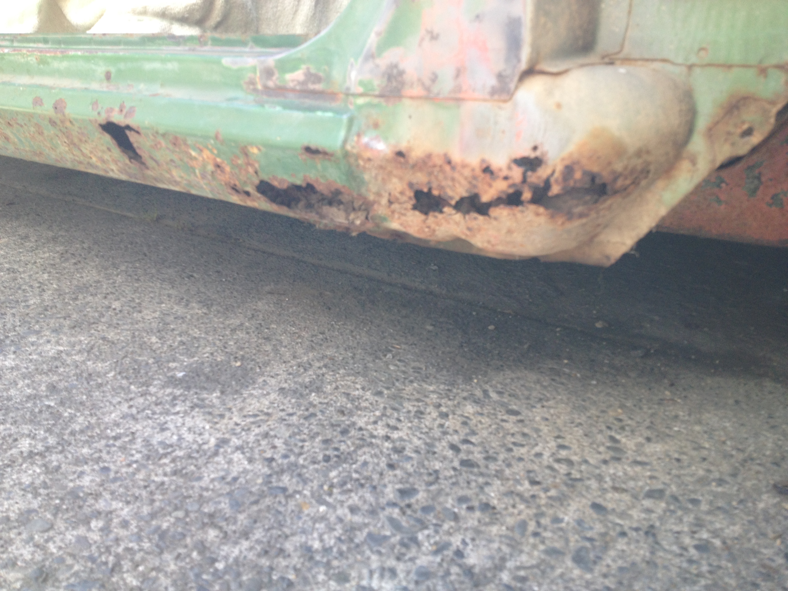

oldmatedan Posted August 8, 2017 Author Posted August 8, 2017 Rhs sill Can't wait to get into this 3 Quote

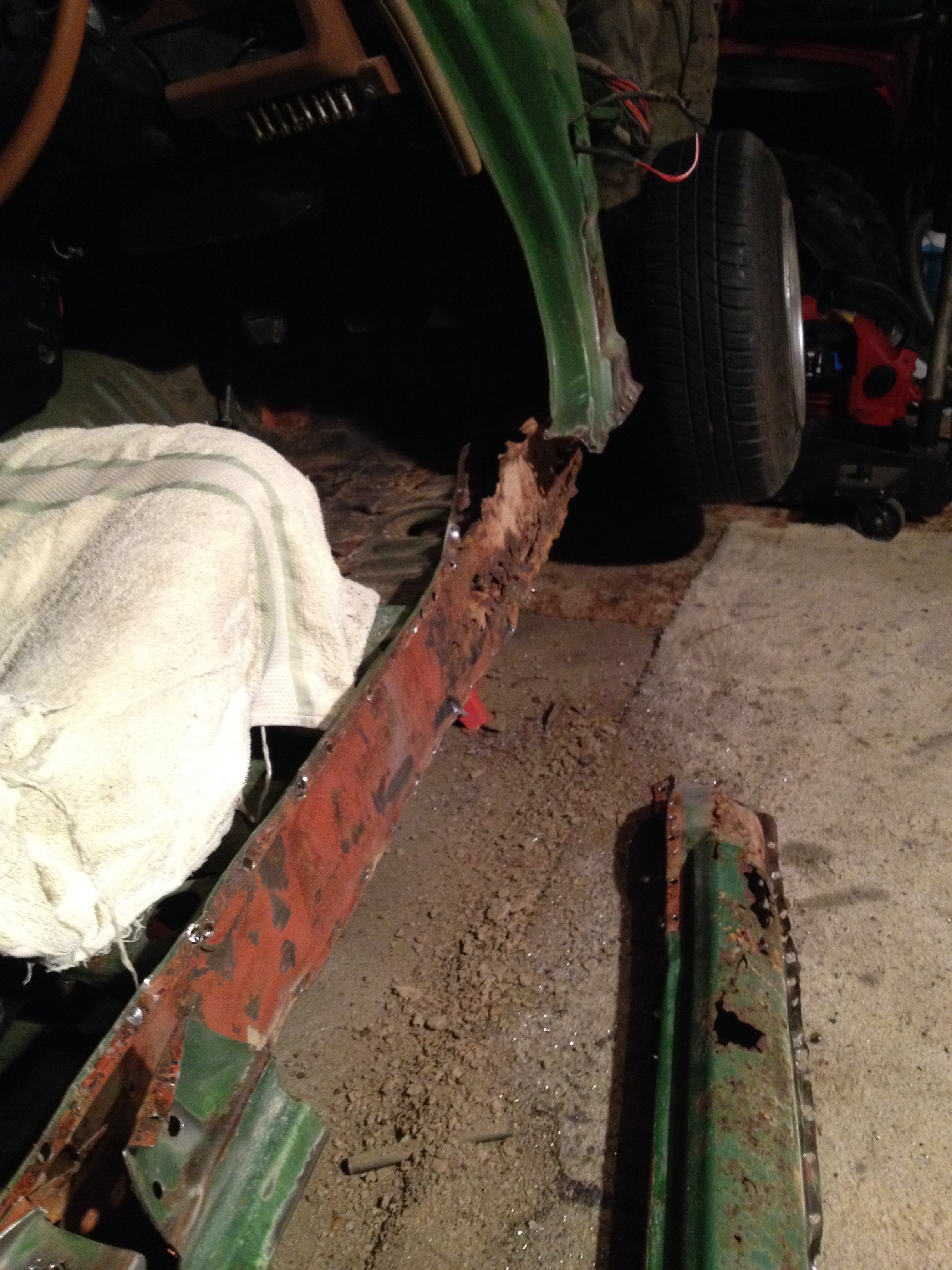

oldmatedan Posted August 8, 2017 Author Posted August 8, 2017 This is what greeted me on lhs inner sill Pics are a bit off centre where's snoozin when u need him? Will post a pic of pass floor too Stay tuned 4 Quote

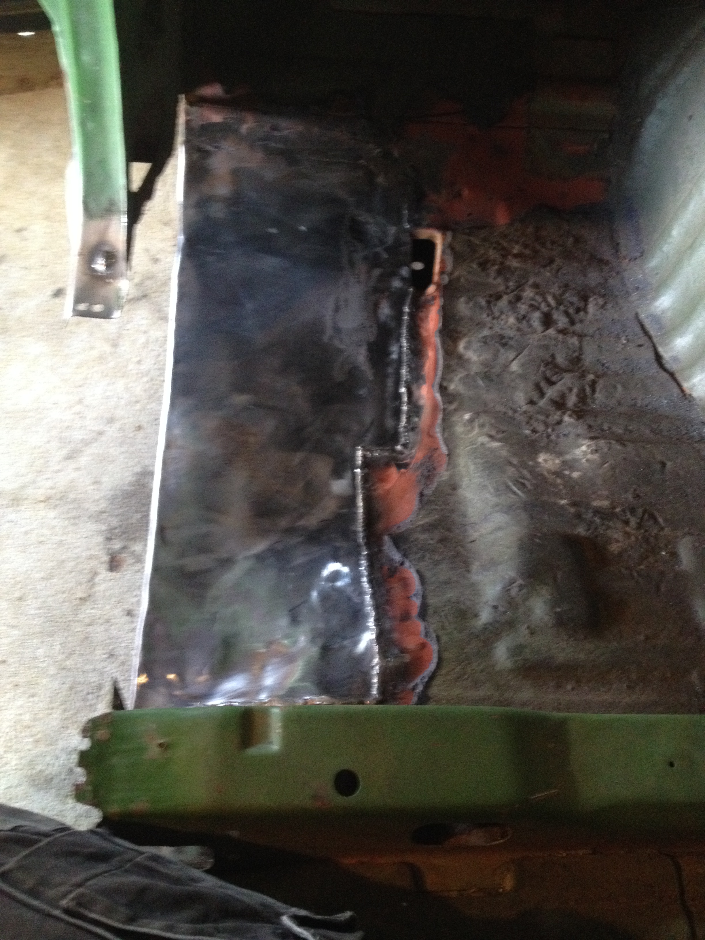

oldmatedan Posted August 11, 2017 Author Posted August 11, 2017 Once this is all in I can turn it round and make a start on the other side Then wof time Then cruise time 5 Quote
oldmatedan Posted August 14, 2017 Author Posted August 14, 2017 Rhs outer sill out the way Got the inner sill to unpick and a smaller patch to put in drivers floor Thought about cutting this piece out of the white shell but kinda reeks of effort Like the idea of putting clean thicker steel in but like the swages etc that factory floor would have Skills aren't that well skilled yet Moving on....... 4 Quote
