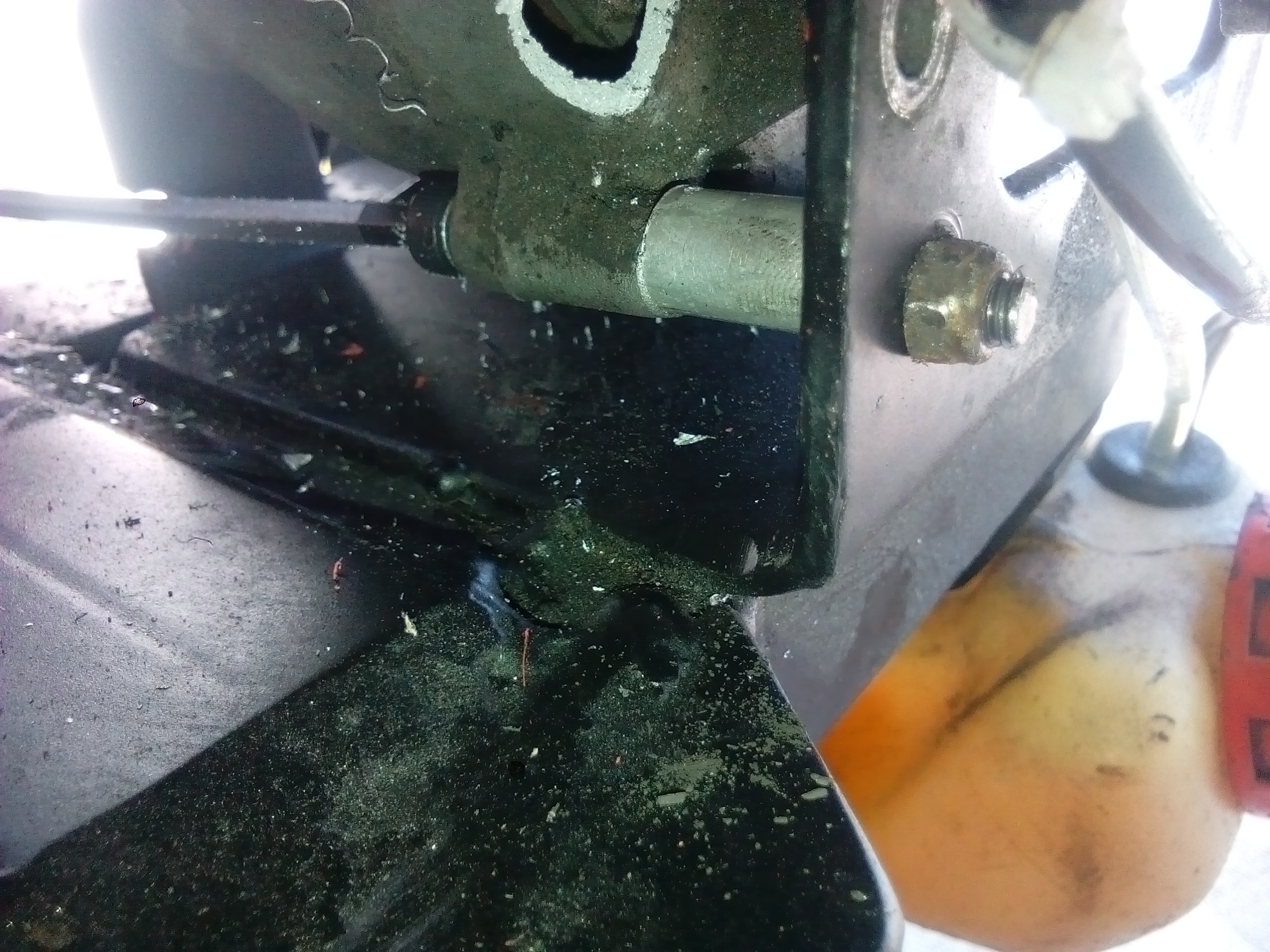

As they say...you can't keep a good drift trike down. I bent it back into shape, and got it ruining again all be it with different mounting holes on the motor as the old holes broke off.
Crack in case, but it's just the fan cover side, so this was my solution.
